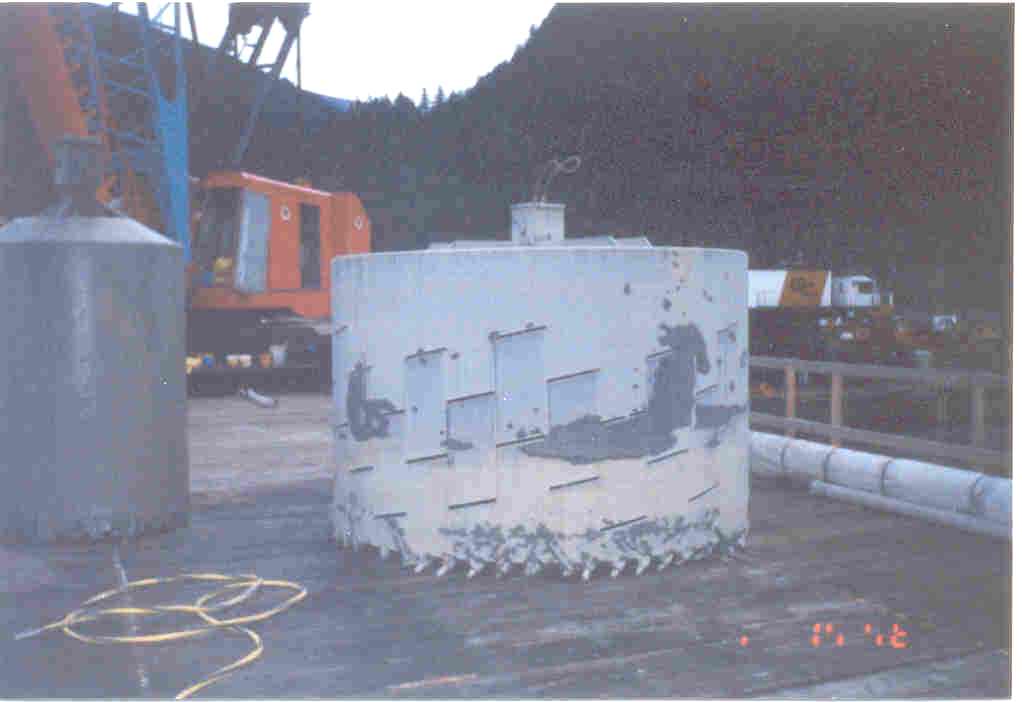

I've had pretty good luck with hole saws. Chewed through 200-feet of rock with this one. But it had a 750-HP diesel engine turning it. :laughing:

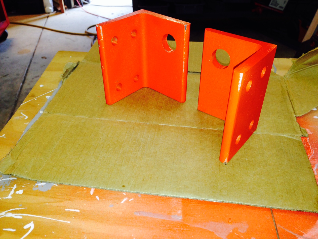

So... First, thank you to everyone so far. Lots of great info.
As an update to the project, I was wrong. the holes needed to be 3/4 (Caught this before I drilled) and my steel is more like a thick 3/8" but my drill press runs too fast (500RPM on slow side) and the throat just didn't have the throw I needed. So I went with my large Milwaulkie Hammer Drill. Works like a charm, except for those magic moments when the bit catches and it is ripped from your hands, usually smacking you in the jaw as a friendly reminder to who is actually doing the work. Oh, I went with the normal high speed cobalt drill bit.
It brings me to my next series of questions. I want to get a speed control. JJ posted a link to a few and I see no reason either my drill press or my hammer drill would not run with this.
Second, and more importantly, how often do you oil? I figure these holes are taking me 7 to 10 minutes to drill but I have not timed them. I figure I am running the drill as slow as possible so not sure what that is but it is not the full 500RPM and it is not crawling. Maybe 200RPM max? I oil once every 30 seconds, a few dribbles down to fill up the hole. If I see smoke I stop, oil up and continue (Don' see smoke very often).
I ask all of this as my one neighbor erects steel buildings. He is pretty ruthless. Grabs a bit, slams pressure on it and maybe some oil if he is feeling generous. I think he has guys sharpening bits so longevity of a bit isn't foremost on his mind, more getting the holes in and building erected.

1/4" pilot hole not too deep. Just a starter hole so I am centered correctly.
Thats why its taking so long.
Yep. Pilot hole needs to go all the way through unless you are using a split point bit.
A chisel tip without a pilot hole is not efficient. Cause that 1/4" tip doesnt have any cutting surfaces. You are more-or-less just eroding or chewing away that center portion. Without a BIG drill press where you can apply LOTS of pressure, a chisel tip needs a full pilot.
Even a 3/4" hole in 3/8" plate should take 20 seconds or so. Maybe less. Let me see....
200 rpm, with power feed on a drill press set at a generously slow .005" per revolution.... is 1" per minute.
So yea, shouldnt take but about 20 seconds if you are doing it right. Any longer and you are likely just burning up the bit.
