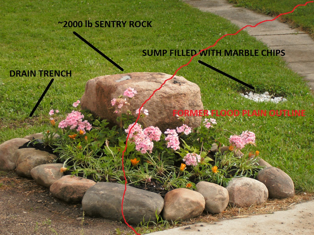

Rather clever of you to camouflage that mean sentry rock behind innocuous pink Pelligoriums.
How do you train the rock not to go after the Fed-Ex man?
:D
The Sentry makes the Queen's Guard at Buckingham Palace Guard look ADHD
There are two stories going on here.
First is a dimwitted in-law that, no matter how many times I asked not to drive over the drain tile / on the lawn persisted in doing so even after I placed the smaller rocks that now surround the Sentry, crushed my drain tile.
After I pick axed through 20 feet of 12" deep compacted gravel to replace the tile I hired Sentry to keep the knuckle head off my lawn. The drain tile and grass are holding up very well now.
The 2nd is a terminally ill young girl in a town north of me was making regular trips to a hospital south of me for treatment the year Sentry took up his post. When asked what "wish" she had her reply was to see her favorite colors, Pink & Orange, everywhere she looked. I don't know that her regular travels took her down my road, but if they did I wanted to her simple wish to come true.
