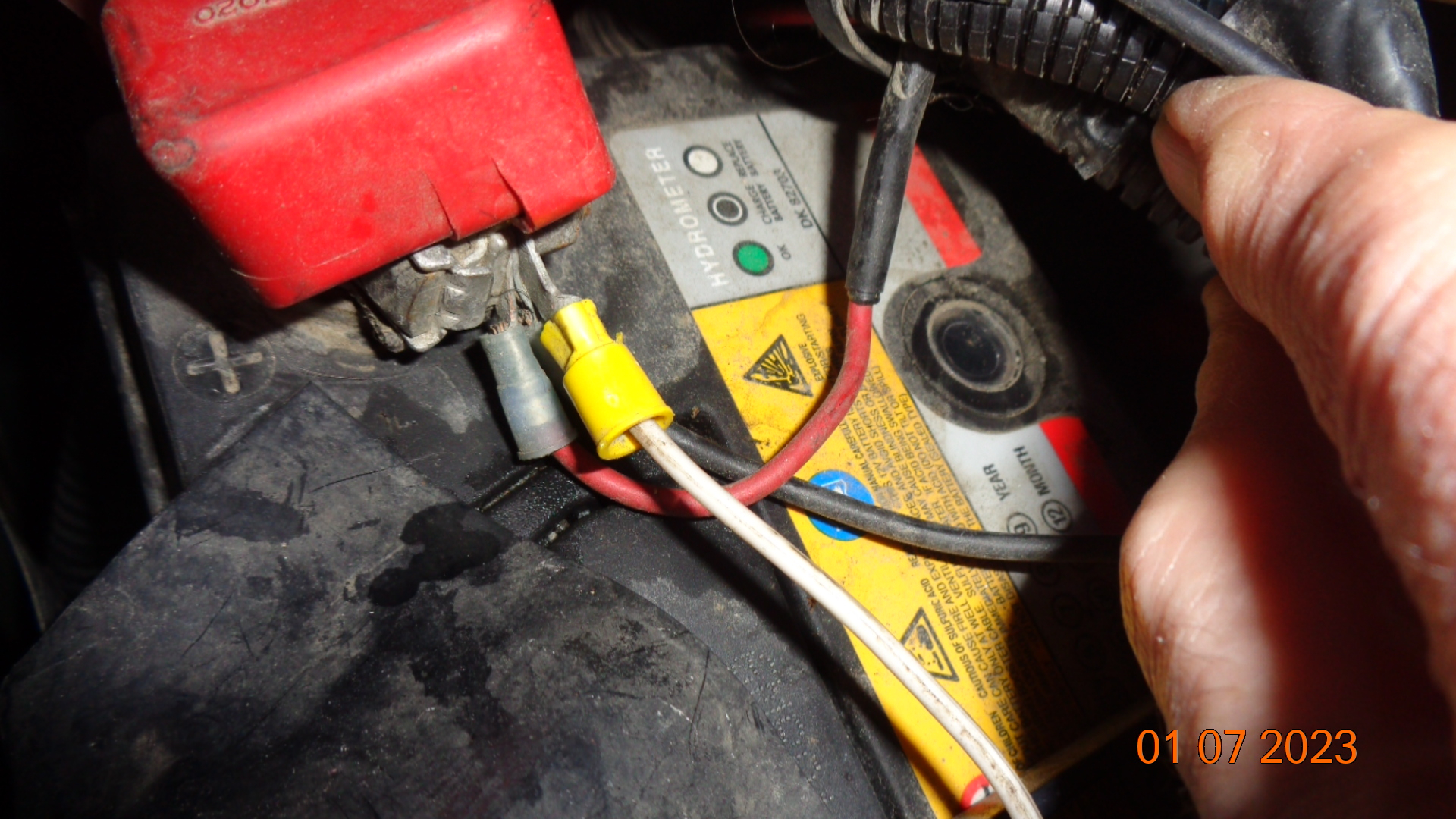

So yesterday, with increasing worry about my OEM battery, I put on a BatteryMINDer charger/desulfator for about 26 hours, now disconnected and watching voltage drop....
Surprise! After 24 hours, it's still showing 12.98! It was 13+ when charger was first disconnected, as was expected. I'll now watch it for a few days to see how it holds up, but I'm thinking I must have gotten a "special" --well-made-- battery or something. Very surprised to see it holding up so well!

Do you have the OEM battery with the "green" sight glass?
KC
   / Best Battery Replacement for the GC2410 #26
Yes. It's hard to see, buried under the wiring harness (check previous pic on p. 2), but yeah, it's one of those "green if good" sight glass things.
I suspect the battery holding up so well is quite possibly also related to my replacing the broken ground cable from the engine to the frame some years ago-- and adding a second one on the other side-- as well as cleaning up that ground cable attach point from the battery negative terminal to that very awkward spot under the floor next to the fuel pump....

You really need to do a load test on it.
I'm pretty sure most parts stores will do it N/C, if you don't have access to one.
I like my trusty toaster style tester.
Yes, my OEM battery was just like your, a very good/strong battery.
But in 2018 (I think) I decided to change it out before the winter so that I would not be jumping the battery.
I started using a trickle charger on it a year or two before since I drained the battery a few time during the summer.
I would turn on my front overhead after market lights while driving into my woodshed and then would forget about turning them off after exiting the shed.
This was done during daylight time...
Oh well, operator error.
KC
