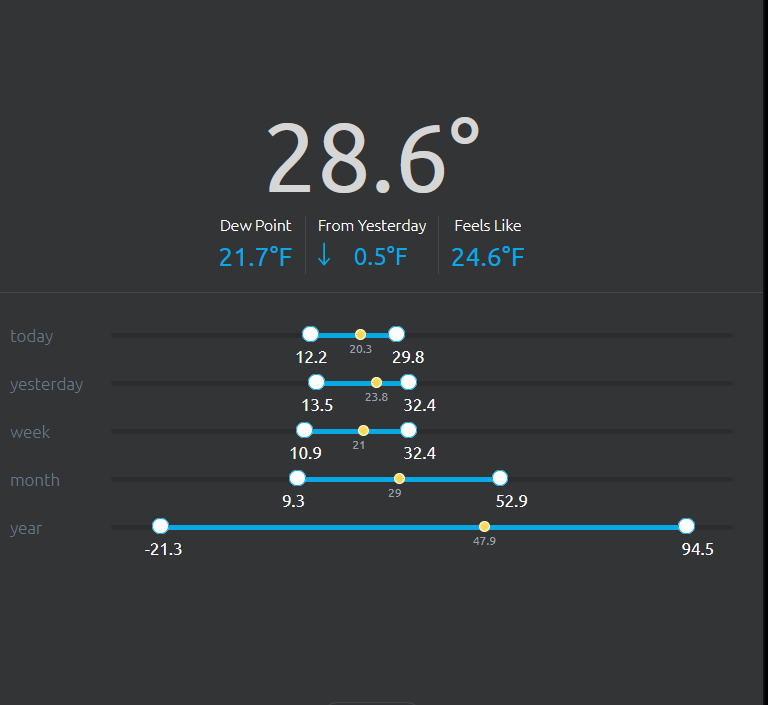

no idea where you are at but I'm in Maine so one is always plugged in (since its stored outside) due to temps that can hit -28F real temps. sucks when its below -20F and you got a wind chill crap on top of that LOL
battery in my 2010 GC2400 is org, thats 13 years in Maine weather.
eg: heres my lows, highs, and current as of 2 minutes ago here for the last year. -21.3F in early January 2022.
