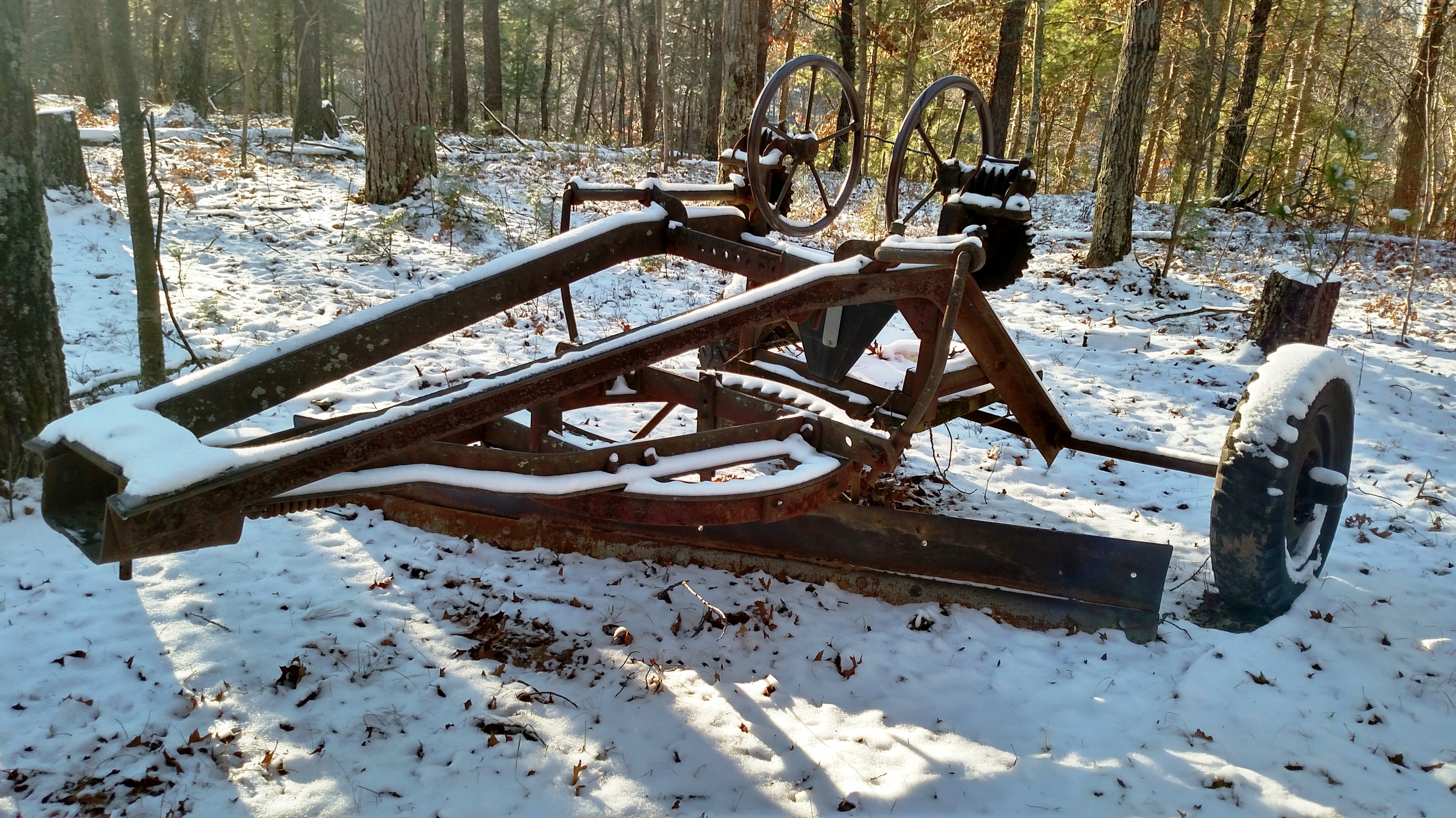

/ Best attachment for driveway #18
This! .......
