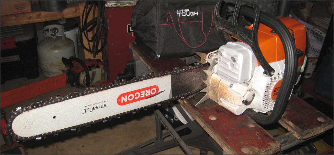

Between my neighbors and us we cut and split about 18 cords of wood a year. My favorite saw is a Stihl MS390 that another neighbor gifted me when she could not start it or keep it running when she did manage to start it. I found the linkage to the trigger was not in its proper place and offered the saw back to her, but she declined. I use a 20" bar with a full chisel "Oregon" brand chain. I also have a Stihl MS271 as my back up saw.
Like all Stihl saws it will flood if you keep it choked after the first sign of starting. Choke it, get that first "start", open the choke and pull it once or twice to get it running.
I do not use canned fuel. Too expensive and I have not had any problem with using alcohol free gas mixed with Stihl's synthetic oil. I do drain and run the saw out of fuel when I put the saw up for the season and I never mix more than 1 gallon at a time.
I also use an EGO battery powered saw which I love for quick clean ups and trim work.
I'm 74 and I thought a lighter saw might be the ticket as I got older. What I found was the larger 390 was less tiring since the added weight allows me to just let the saw do the work without having to "push" the saw through the log.
