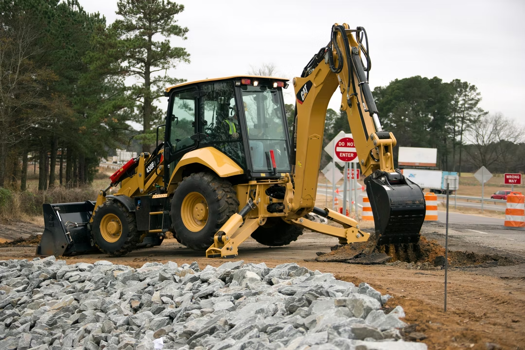

If money is tight it’s hard to beat the versatility of a full size construction backhoe. You can buy a pretty nice one for 30k and a tired but still workable one for half that. Get all the construction work done with it and then buy a tractor that’s more practical for ongoing maintenance.
   / Best aftermarket backhoe for 2021 Kioti DK6010
#20
By 'construction backhoe" are you talking about a backhoe loader like this?
