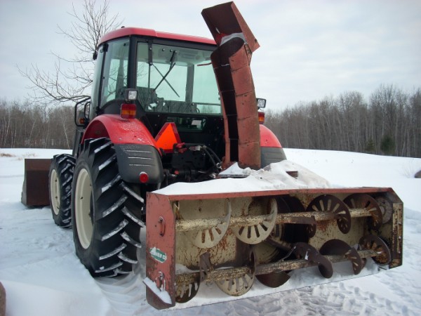

I picked up a 7' old, ugly, $500 but works good. Hyd motor for chute rotation. New Idea Canadian made.
Does not seem to weigh much but hangs far enough back it off loads front weight & reduced steering traction. I cleared snow for years with just a 8' front bucket.
Once I got the hang of the blower I drop the bucket off & just blow for better maneuverability & space in the shed.
Be sure your tractor has a rear wiper!

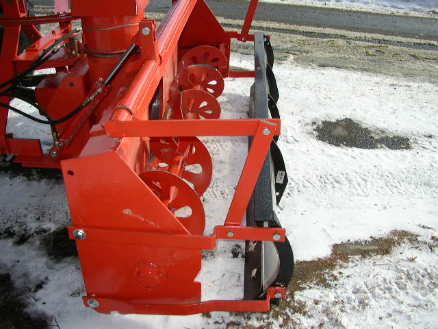

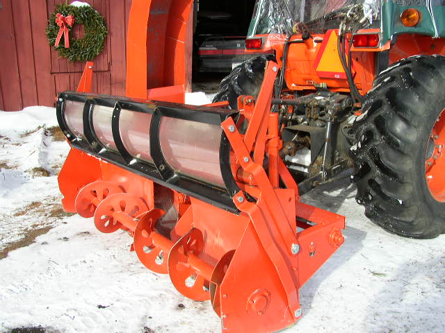

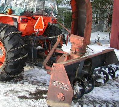

Speaking of Avco New Idea snowblowers, here's a 7 foot old-but-good one I bought for $300. It looked bad but it worked great. The next 2 pictures show it after sandblasting, paint, and a hydraulic drag blade was added for cleanup in front of garage doors, etc. (something like Pronovost's PXP but waay cheaper). If you're interested there's a project thread here .
My experience is that the older blowers tend to have very heavy duty gearboxes on them that last forever. The steel can be rusty but if everything still turns ok and there's oil in the gearbox, an older used unit can be a great find.
