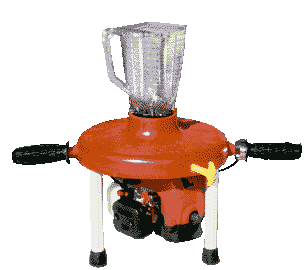

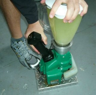

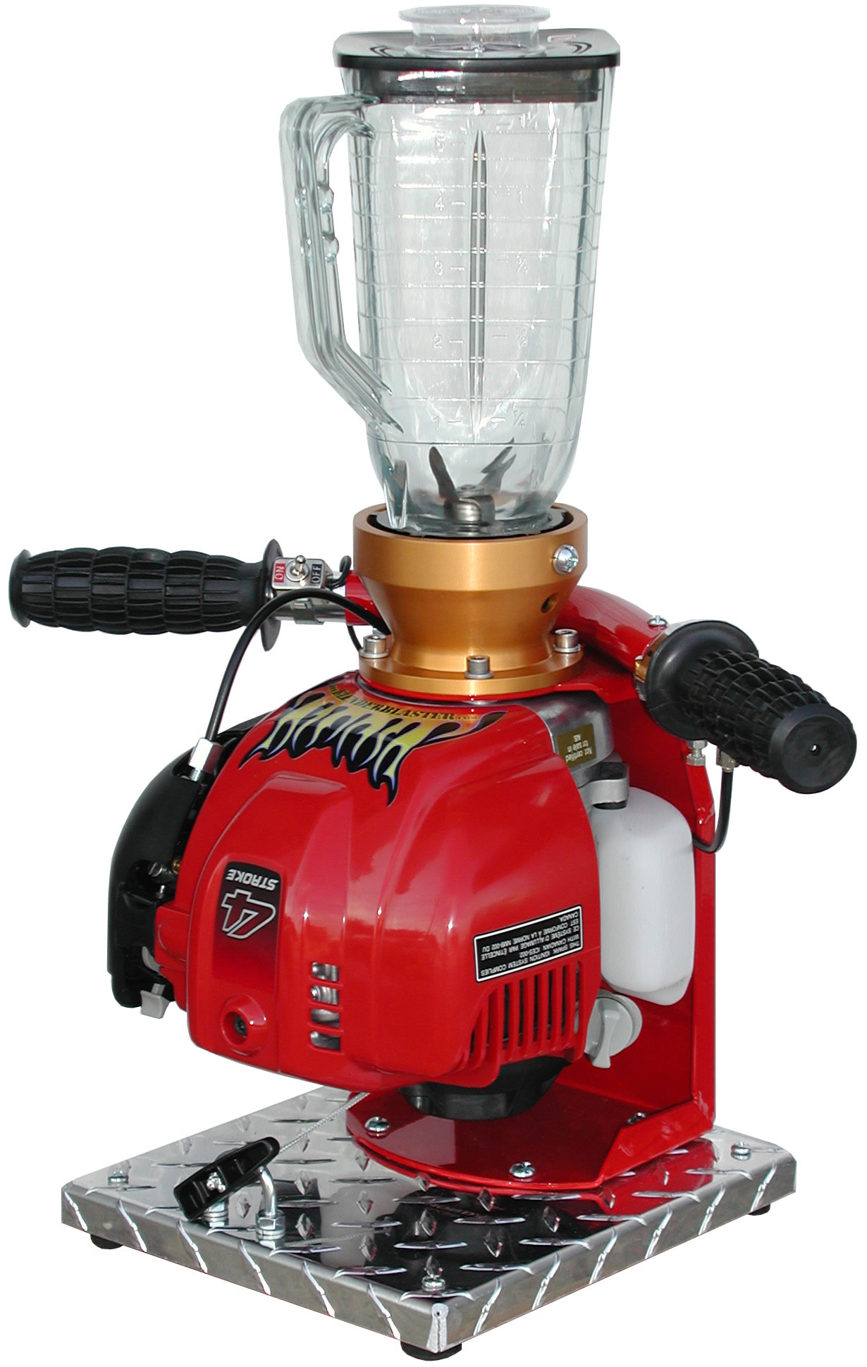

Not sure about the other accessories, but for the drink mixer you don't really need an electrical outlet. They appear to be available for nearly every brand of tractor. :)
