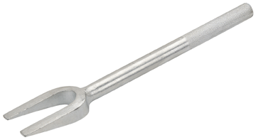

I got the castle nuts off, along with the two washers - but can't pull the pull rods out - how much force can I use to break them free?
/ bent front bar on Jinma 204 #11
You can use a tool called a Pickle Fork or Ball Joint Splitter but if there is a rubber boot be careful not to damage. You can also just put the nut back on half way or so and then use a piece of hard wood like oak and place it on the nut to protect and give it a wack with a hammer. Be careful not to damage anything. This should loosen it up then remove the nut and it will fall out.

The ball joints can be a real pain. Be carefull using the hammer on the end on the castle nut, as ALL the hammer force is borne by that cast iron arm in shear(weakest mode) untill the ball joint pops free. The pickle fork is the prefered method as any hammer force applied to the fork can be directed along the length of the cast iron arm in compression which is a stronger axis. The hammer blows will also force the two pieces apart equally like a splitting wedge on a piece of firewood. I don't think I have ever used one that I didn't damage the boot though. I have also had pretty good luck using a small puller applied to a well greased center punch mark right in the middle of the threaded end. I do this with the castle nut loosley in place so it can chase the threads if the screw rod should slip or distort the end of the threaded rod. Once it pops, you unscrew the castle nut and they usually lift right out by hand.
