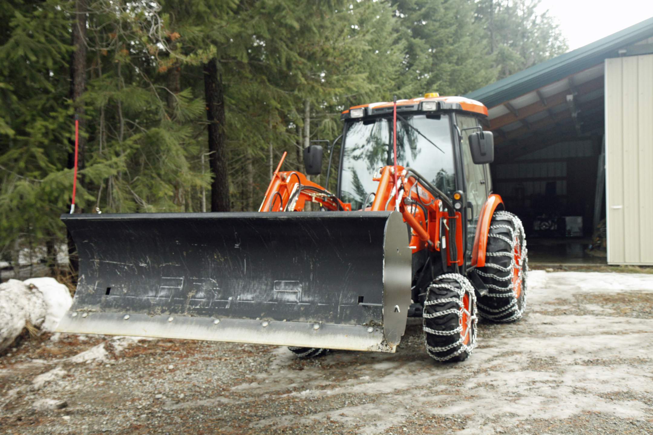

I now have 2 seasons with my Quick Attach brand loader mounted plow. Its a 84" wide plow with 4 quick trip springs. Works flawlessly as long as i chain up all 4 tires (otherwise it tends to drift when blade is angled)
