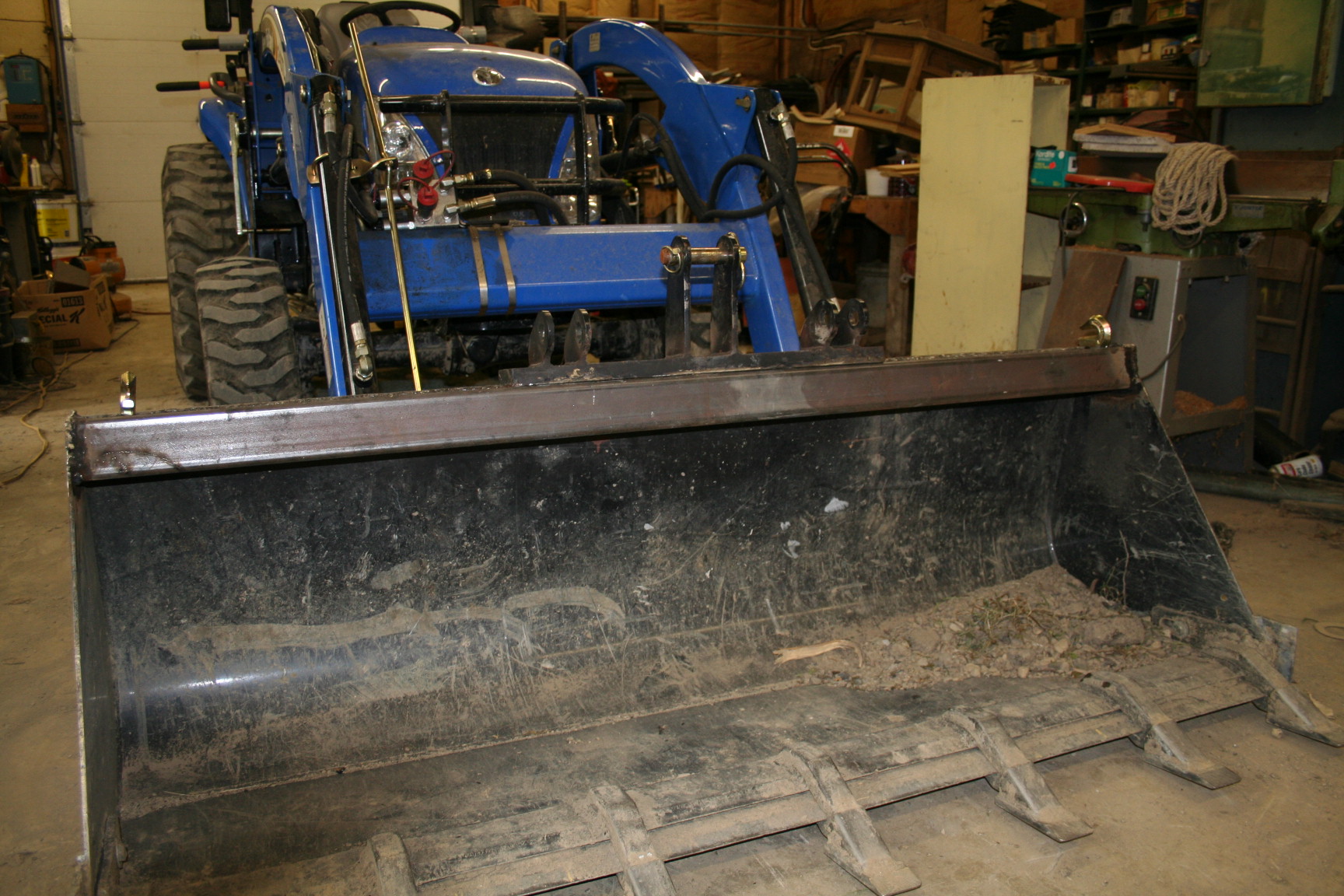

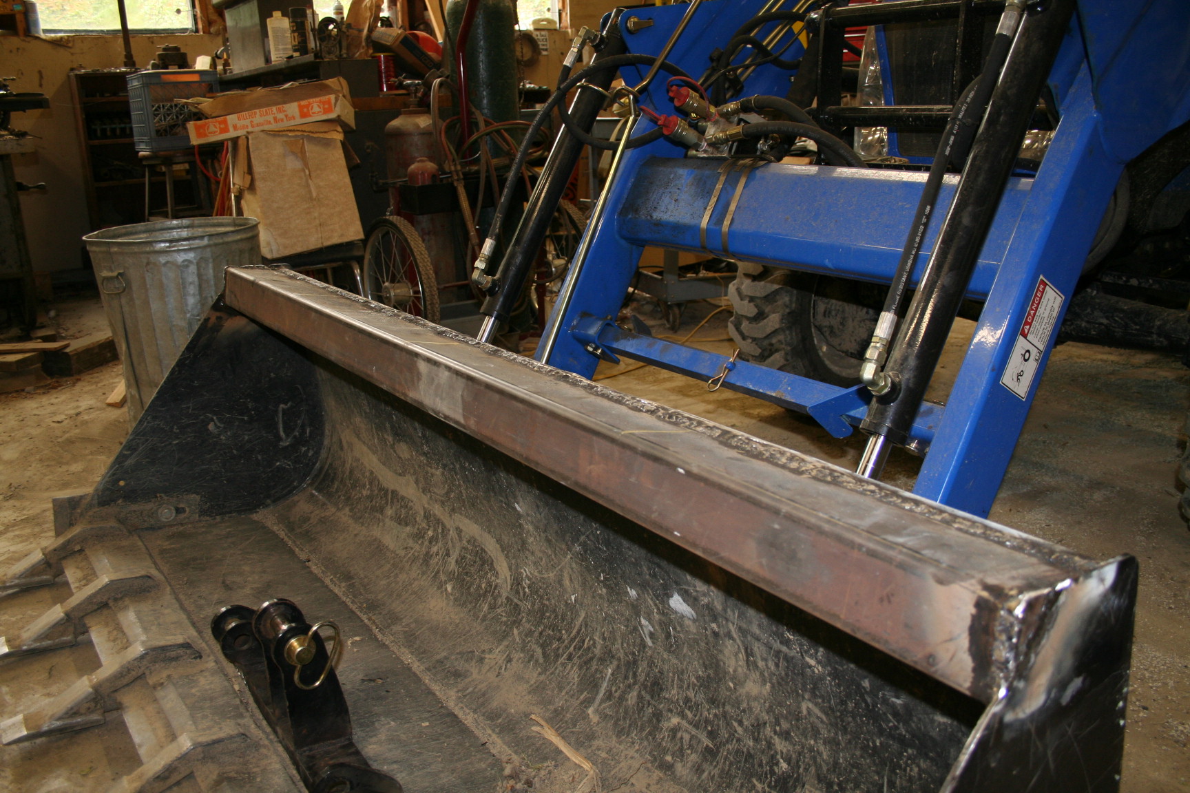

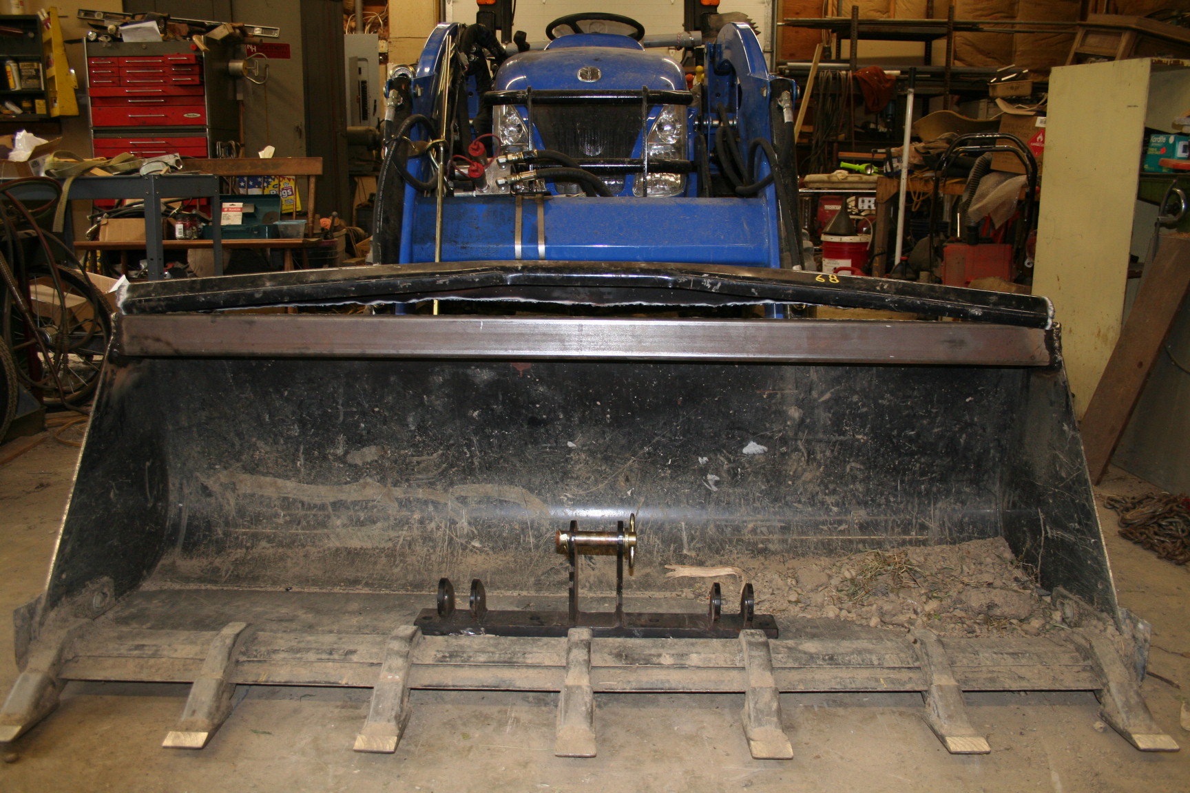

Ahh Knew I should not have done that. No before pictures but midway pictures and question. Welded a thumb base to the top of my bucket. Worked well for brush and logs . Big rock wrong. bucket is 10g .134 in thick. I decided to cut out the top and weld in a rectangular tube section. 3 x 5 x 3/16 68" long was $80. Jig saw, or friends plasma or my OA. Used OA but maybe jig saw would have worked. I don't like to use OA unless I really have to. Anyway cut was a little ragged but it's all buried under the weld. I am not the worlds greatest welder but then I have never had anything come apart either. So here is the question. Do I need to reinforce the 3 x 5 thumb mount ? Trade off to FEL lift. I was thinking the tube is really stiff and maybe a vertical web inside the bucket maybe 1/2 way down. Web would be in tension . How about under the hooks.? The one on left will be turned around off course.

A cross over relief valve between the two grapple cylinder hoses might be a good idea. About $65.00 from the surplus center. Then you could reduce the amount of pressure going to the grapple cylinder, to open and to close (2 separate relief pressures) adjusting it to a point where your bucket is not flexing under the strain of the grapple.

With what you did, I think you don't need any more reinforcing up there. Not on the bucket nor for the grapple base. I did something very similar except welded the tubular bar on top of the bucket lip. I have two bucket grapples mounted and zero flex or bend.
You should be good to go.
Here's a couple pics ... fitting and finished.

Thinking about how this happened , it was not the cylinders closing on something. I had a big rock in the grip and I tried to roll back the bucket and the rock hanging out pivoted around the bucket lip and forced something up . Was the top of the bucket.
Rob I will go with what you say. You have been doing this stuff for a while. Thanks

Yeah, you might as well try it like that.
I think you'll be alright, but if you get some flex or bend, you can always add gussets or a brace right away. It's just less weight right now and should be fine.

A great deal of that bend was caused by the bucket top yielding in response to torsional forces. Round tubing is best at resisting this twist around an axis. Rectangular is good for bending and comparatively poor [wrt round] for torsion. Since you have both forces, a tailored hybrid would be the ultimate answer. The square tubing however is quick and adequate. If it ever twists tho, put a tube down the center welded at the ends and spotted thru holes all along the length - or make a hybrid from scratch

To the OP, looks nice, I was debating the merits of round vs. square, but the square sure makes fit up nice.
I would fly it and watch it as Rob suggested, if it starts to tweak, reinforce the tweak.
