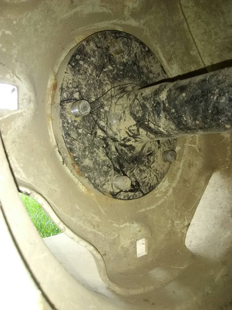

Obvious by your pic that wheel was never properly welded.
You don't need to take the tractor to a shop unless it's a warranty fix. If not warranty you just need to buy a new wheel and transfer the tire.
/ Bent Axle?
#22
Called the dealer. It's a warrant item. I'll bring him the tire and he'll remount the rubber on the new rim. Glad it was a simple fix. We need the tractor to spread stone on our driveway before company comes. The seat ripped too. I forgot to mention that.

I'm trying to diagnose why the wheel failed. Hoping it's just a bad weld.
The backhoe would put a LOT of stress on the rear wheel. That probably sped up the failure.

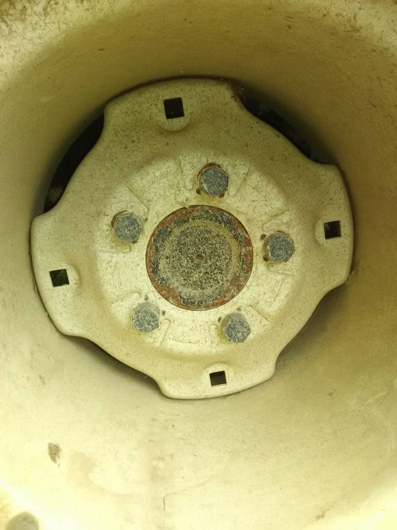

This is my left rear wheel, inside and out. No sign of width adjustment.
I've been pretty rough with it. All I have is slopes, so these have been at all different angles, loaded FEL or not, with and without BH or Tiller. Lots of uneven ground due to moles and rain runoff.

Took the tire off today and there are two bad welds on the hub part that is inside the rim. The part is on back order and I'm having a hard time finding out when it will be in stock. Called LS and they were suppose to call me back but no luck. The dealer can fix mine for 125.00 and I'll have a backup when the other one comes in. Just a real pain in the arse. I'm in the middle of putting in a patio, moving dirt, installing a pump and installing a driveway. The tractor picked a bad time to fail. Pavers are going in Next week so I may have to bit the bullet and get it fixed at the dealer. I could take it to a welder locally but not sure if they can weld with the tire on and not too many welders have tire machines.

Because I aspire to be like SR and a few other members I'd consider jacking the wheel, truing and tacking it, and taking it to a welder that IMO should only need to ground his - lead ok (some paint removal?) vs remove the tire to fix/replace the weak OEM welds.
/ Bent Axle?
#38
It's not the money. Not that thrilled driving on a repaired rim that is cracked and has cracked welds.
/ Bent Axle? #39
A good welding shop will make it stronger than a new one.....but I understand some folks just don't like repaired things on their tractors, they just want it like new again.
