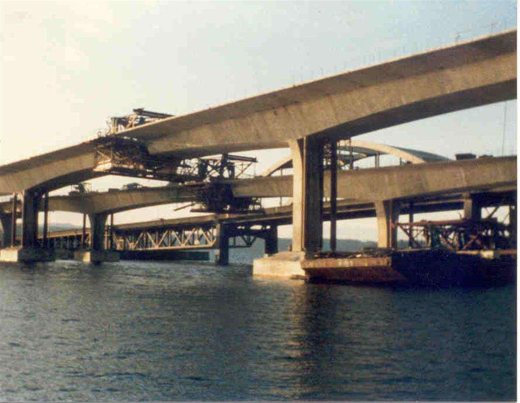

Years ago I was on a large concrete bridge project. They were using traveler forms like in this picture. Before the next section is poured the opposite side has to be loaded with counterweight blocks. Another contractor was loading the cantilevered section with counterweight blocks getting ready for the next concrete pour. They had a weldor that I had worked around before welding padeyes on these concrete counterweight blocks. The rigging crew was always waiting on this guy. I wasn't paying a whole lot of attention to what was going on, until I heard this very loud thud! One of the padeyes broke off the counterweight block while it was in the air being flown into place!:eek: Can you spell unemployment?:laughing:

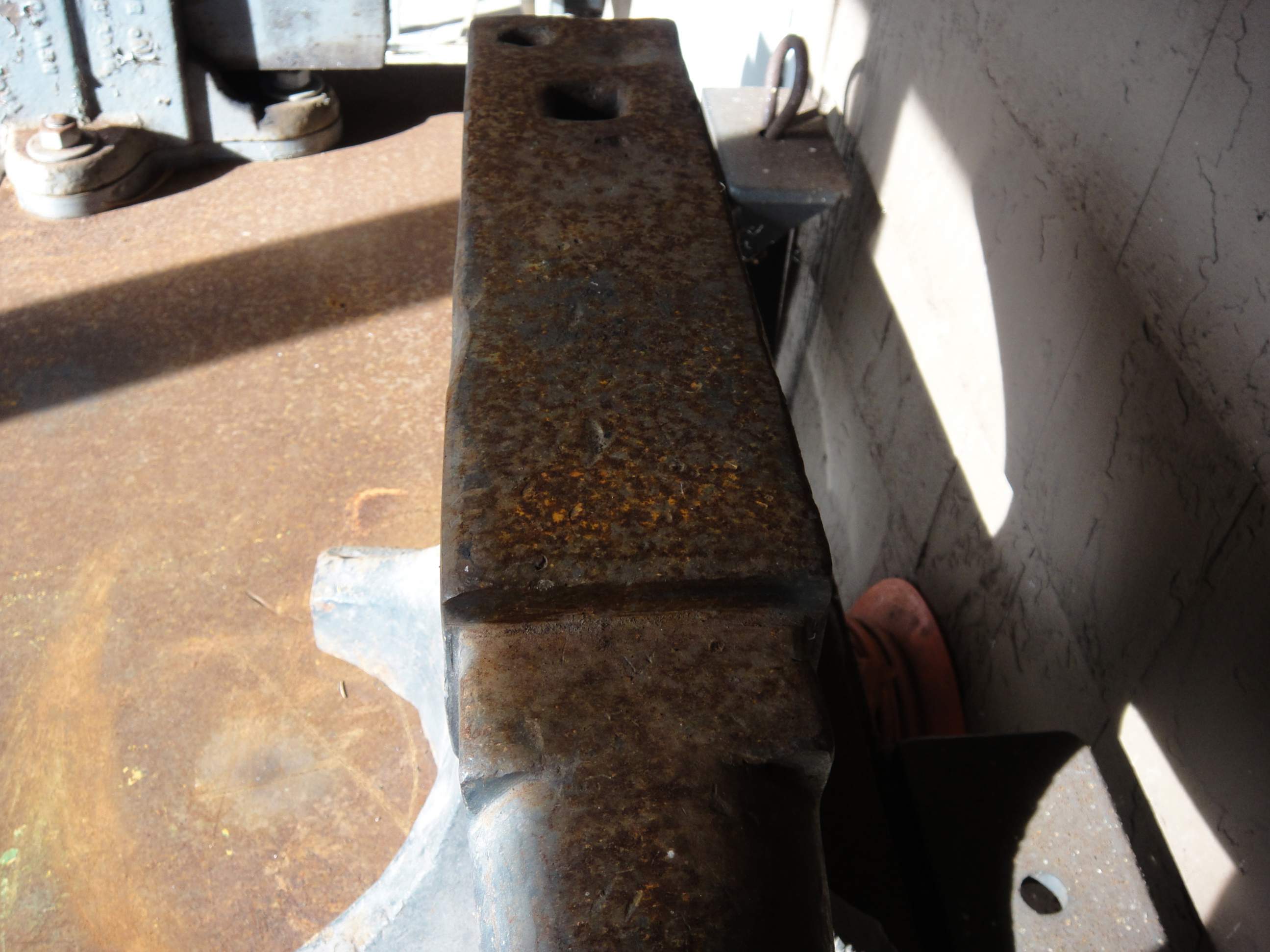

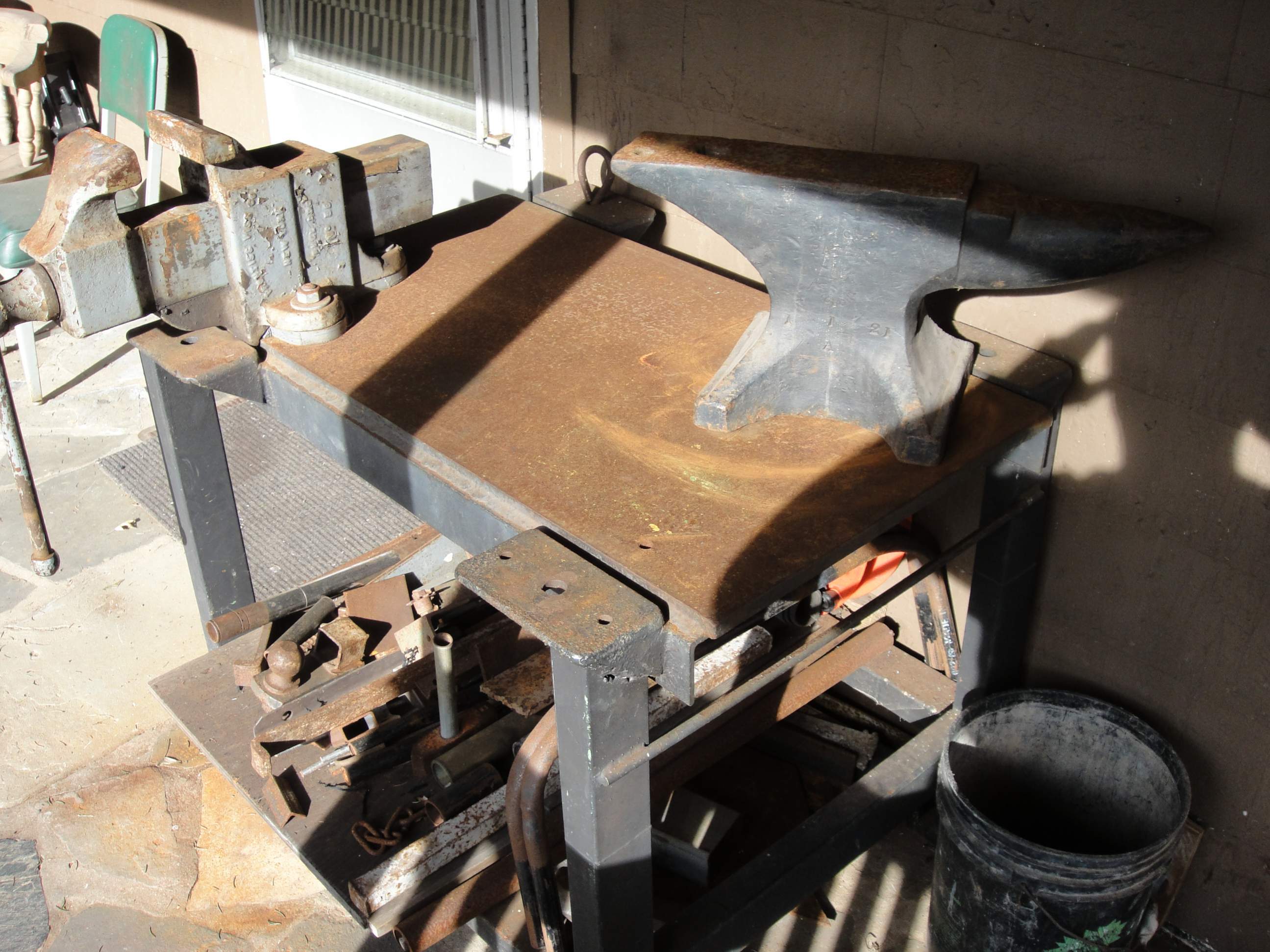

I liberated an anvil from an old barn that was condemned and in the process of being demolished. Carried that thing, which weighed more than I did, about 300 ft to my truck, close to 200 pounds. Not in perfect condition by any means but still useful.
I got a 20+ foot length of RR track I could make a bunch of those redneck anvils :laughing:
Picture may be deceiving, that is a monster vise and the table is 1/2" plate

Anvil weight is calculated by:
Rules:
First number is # of hundredweight (112 lb. ---- 1,2,3,etc
..........(Any position can be zero, and IF zero is marked with a zero character (0).)
The middle position equals quarters (1/4) of a hundred weight. The value cannot be more than 3. If it looks like a five then it is a two or a three.
The last (right hand) position is pounds and must be equal to 27 or less.
From your photo it looks like 112 + 28 + 21 = 161 lb.s
The shape looks like a Peter Wright (English made) anvil. I can't read it from the photo. Usually the name is on the side of the anvil. - just looked again- Peter Wright , Solid Wrought (hand made process by which horn and top plate are attached to the body. The top plate is a harder quality steel, while the body is a low carbon wrought iron. Great quality anvil, well respected. Can be cleaned up, but be careful of overheating the top plate- cool it as you grind- water etc. Don't ever hit the top plate dead on with a hammer- dents the plate- not so good for working steel then. You could easily resell this!
http://www.ebay.com/sch/i.html?_fro...=Peter+wright+anvil&_sacat=See-All-Categories
I am fond of anvils- great tool!
It looks like a nice anvil.

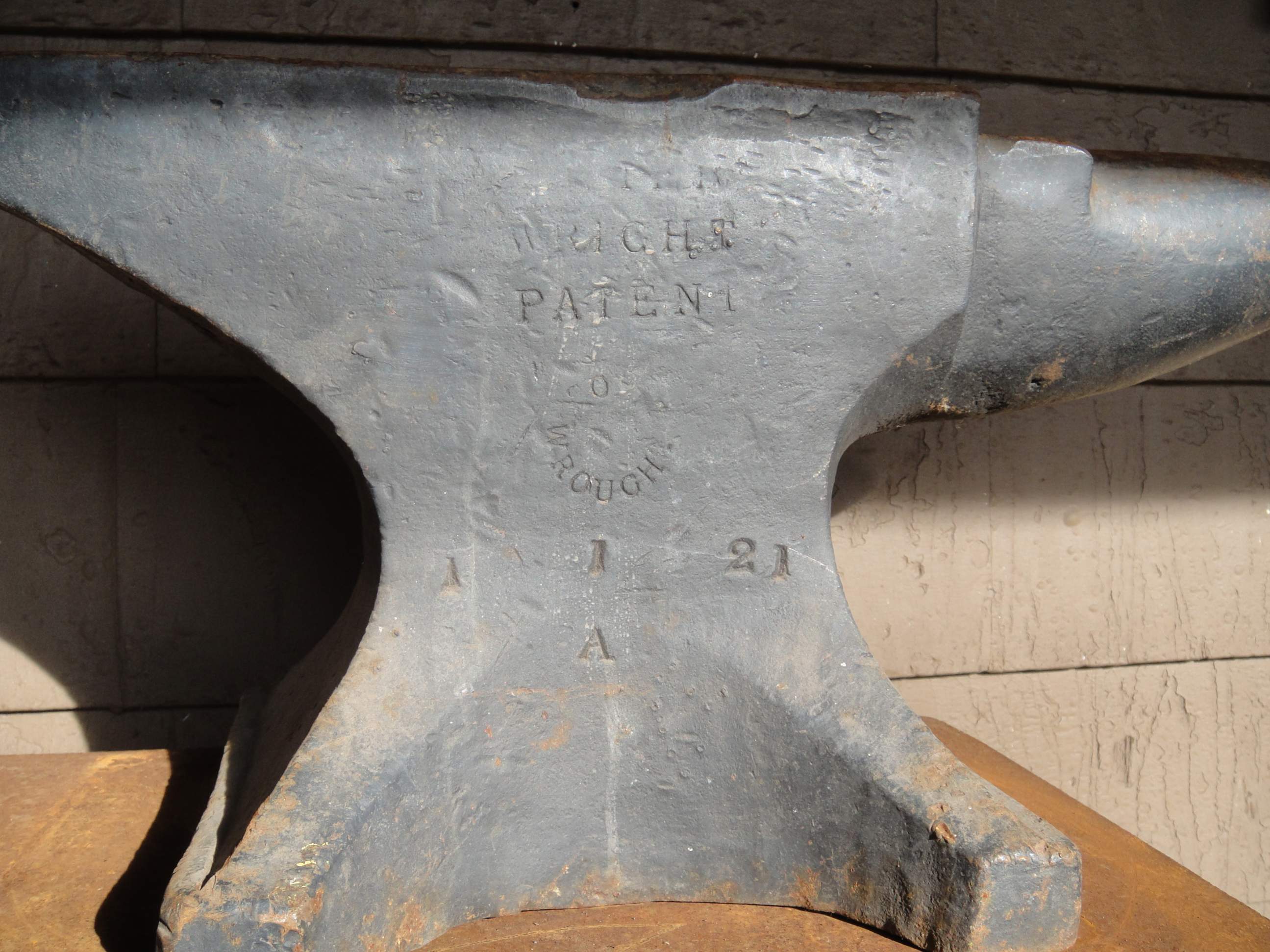

That's a complicated formula, but sounds right, I think I weighs ~160 lbs
It does say wrights patent, so was it imported?
The top is heavily used, even the round part of the horn it heavily worn on one side. Maybe from making horse shoes??

-Could be from making shoes. I'd say the guy was right handed and hung the bars/stock over the rounded edge of the anvil - (work rounded), The hammer is in his right hand and the tongs in the left hand. I figure he also beveled the rounded side of the anvil a bit so as to avoid a sharp crease when bending stock over the edge or curving the steel (sets up weak spots). Somebody put some hammer dings in the face. When you hammer hot steel on the face (top) of the anvil - it is soft. One side of the steel takes the hammer blow, the other side takes the dings from the anvil face! (you work around them!)
It looks like a Peter Wright anvil imported from England.
Peter Wright anvil - Practical Machinist - Largest Manufacturing Technology Forum on the Web
+ do a google search: "Peter Wright Anvils"
I hate to think of these anvils hitting the scrap yards!
