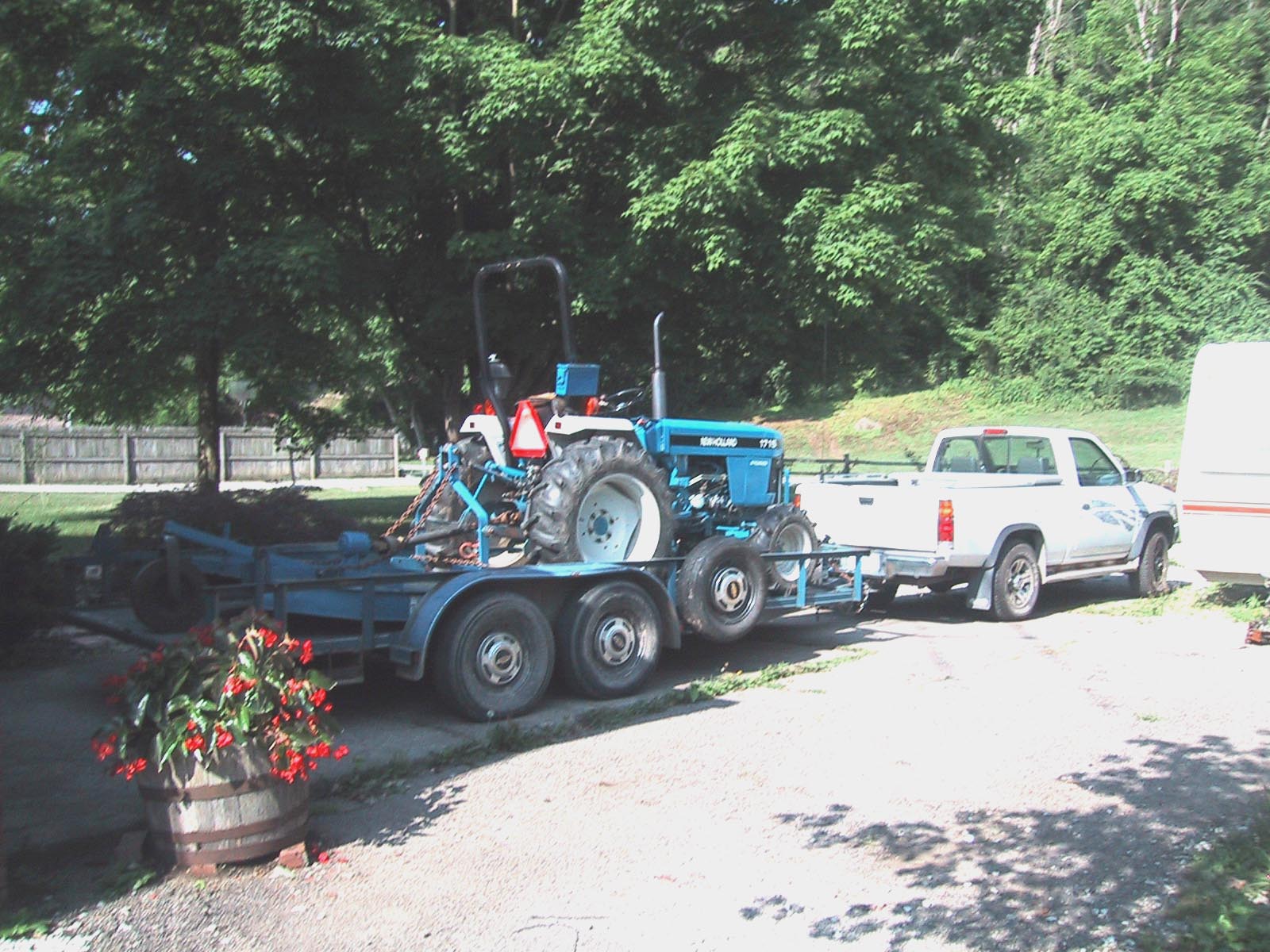

A Rotery, Rough Cutter is for cutting small brush and tall heavy grass. Such as cutting off pasture fields, for maintance of bushes. They have heavy blades that are mounted on a large disk and swing free , when hitting something they will swing back and not break. the smaller ones 8' & under only have one blade , the larger ones have more. Hare is picture of mine . first picture is of cutter , next picture is of it on tractor & the last picture is of it in use. I know us Americans don't use correct English so please bare with us.
