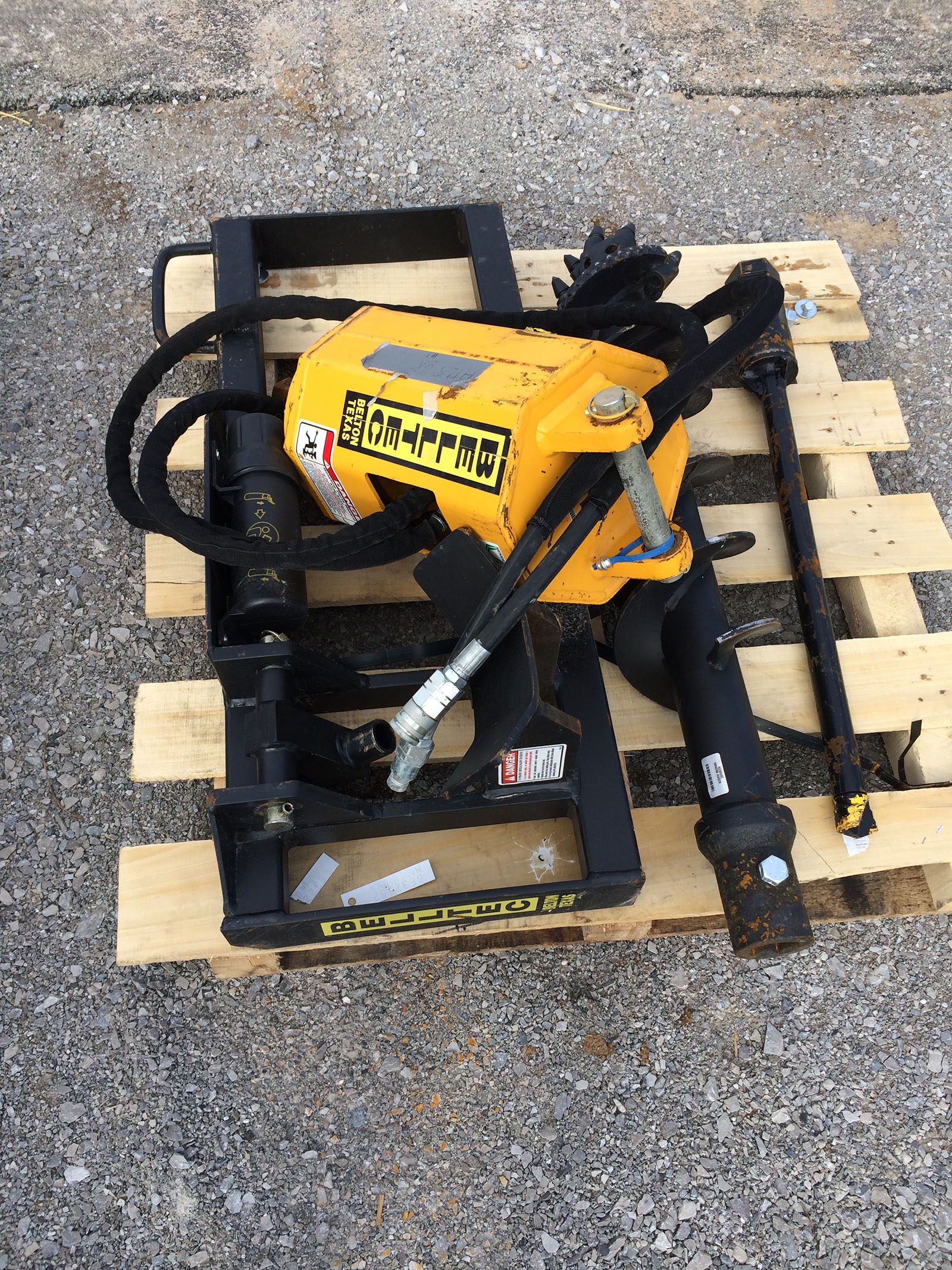

I ordered a Belltec hydraulic post hole digger system at the National Farm Machinery Show February 11, 2015, and it came in yesterday. It was handled by Belltec representatives at the show and sold via a local dealer. I had a message from the dealership to call them and I did, but the dealer rep that called me was unavailable and I left a message that I had returned his call. Anyway, we got together and he advised me that it looked weathered. He sent me some images via email and it definitely looked weathered. I had called the factory some time earlier about delivery and he never responded. Anyway, when I got to the dealership I looked at the unit and it was more than weathered. I ordered, or thought that I had ordered a unit for use on my MX5100 and LA 844 loader with the QA system. It included the quick attach skid steer mount with the powerhead mount on the right-hand side like I had ordered but it looked used and was rigged for a skid steer hydraulic system. It did not have the pioneer hydraulic couplings and had 8' hoses, not the 3' ones I thought I was getting. The dealer called ACI, the distributor about the unit and specifically asked them if the unit was a demo unit and although I didn't hear the conversation he said they told him it was not a demo unit. I agreed to take the auger, PUFF bit, the mounting system with the proper hoses and he has ordered a new hydraulic power unit for me. The dealer has been very helpful and offered to do whatever I wanted with the system. I decided to keep the auger, SSQA mount, PUFF bit, and wait for a new hydraulic power unit. Now, I am having second thoughts about the auger and PUFF bit as they don't have the look of a factory painted unit. This is a very expensive unit with a good reputation and I paid a substantial amount down at the time of my order. It appears that all of the components have been painted a flat black without any of the yellow trim that all of them had at the farm show.

I just sent the factory rep from the farm show and email expressing my concerns and copied it to the dealership. The dealership has been upfront about all this as far as I can tell and been very accommodating. I really think the issue is the distributor, ACI. I think I want everything new at this point, it's a high dollar investment and I expect it to be as ordered! They did have some large limestone rock at the dealership that had been drilled through with this system and it was impressive. I am tired of damaging 3 pt. augers with all the rock and having to use a spud bar in nearly every hole I dig. The dirt here is Eden Shale and full of large rocks. This system is designed to drill through them. It's taken 6 months to dig 40 holes and I have a lot more yet to dig!

These is a very expensive system and when the dealer representative has to question the distributor whether or not they are new and have they been used as demonstration units makes me wonder about them. The power head in particular which is fluid filled and if it has been used there is the possibility that it could be contaminated with use and since it will be introduced into the hydraulic system of my tractor When I use it I should be justifiably concerned. I realize this is not a new Corvette, but I do expect it to be new when it is sold as such. Cosmetics are not as big a deal with farm equipment, but new is new and used is used. Upon reflection and with doubts about a $5,000 post hole digger it is not just about cosmetics. The ethics of the supplier is what I question. If I have been misled about an item that I have contracted to purchase that is fraud and at this price level it is felony fraud if it is misrepresented. I am new to this type of system and trusted the factory representative at the show to assist me with what I needed to accomplish the task efficiently and effectively. I have small farmed for years with tired, old equipment, mostly 3 point hitch PTO drive stuff. Hydraulics are relatively new to me and I don't learn as fast as I did before I became a ROF. This is basically a toy, I could have paid to have the fence installed and probably spent less money than the unit cost, but doing it myself is meaningful play and some exercise. The very functional and reliable Shaver PTO auger that I have has served me well, but it is showing its age and hard use and I am tired of taking days to dig a few holes and using a spud bar and opted to plunk down hard-earned cash for new equipment and if I have to question whether it is new or not I will. Caveat emptor is the catch phrase here and I am!

Based on the condition of the bits, I can tell you this has not been used.

Is that their HTLS6K unit (hard to tell with the duct tape)? For MX5100? You have 9.2 gpm flow, what is your pressure?
I think your MX5100 will have hard time moving this bit. You probably looking at 5 seconds per turn.

9.5 gpm per the owner's manual 2560 psi. It is supposed to be slow for the dirt and rock bit, but I don't know what the rpms will be yet. It is what the factory rep recommended for the 5100. The unit is the HTLS-6K.

hmm, you should be getting 4500 ft-lbs torque but your rpm will be around 13 or 14, or one turn every 5 seconds or so. Extremely slow. Maybe that is what is required to drill in solid rock, I don't know, never drilled.

Good luck. I'm just surprised Belltec guy recommended this drive for your flow. I have 15.9 gpm on my tractor and all the dealers I talked to recommended stuff in the 50-100 rpm range. Maybe they go through the same training :) or this is what you "suppose" to be drilling at. I know for sure on my bench press it sure it drills better at lower speed, less heat, sharper drills. Maybe the same principle applies here. But 13 rpm?, you'll get old drilling your holes :)
I'm thinking something like 40 rpm plus for my tractor.
