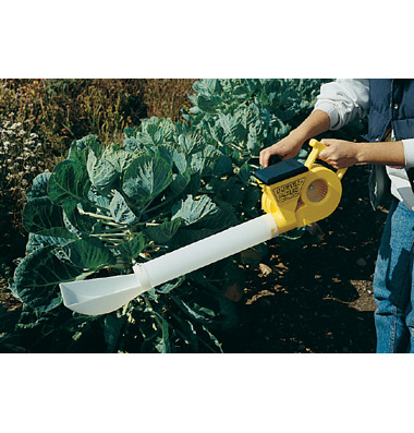

Or--you could use one of these (Dustin-miser used for dusting plants with insecticide). It is inexpensive, operates via a hand crank and you can remove the deflector and reduce the output tube diameter with plastic piping to give more or less volume and speed of the air; simple and works well.
The one I use is a different brand and is metal but the same mechanism, i.e. a small paddle-type or squirrel-cage fan.

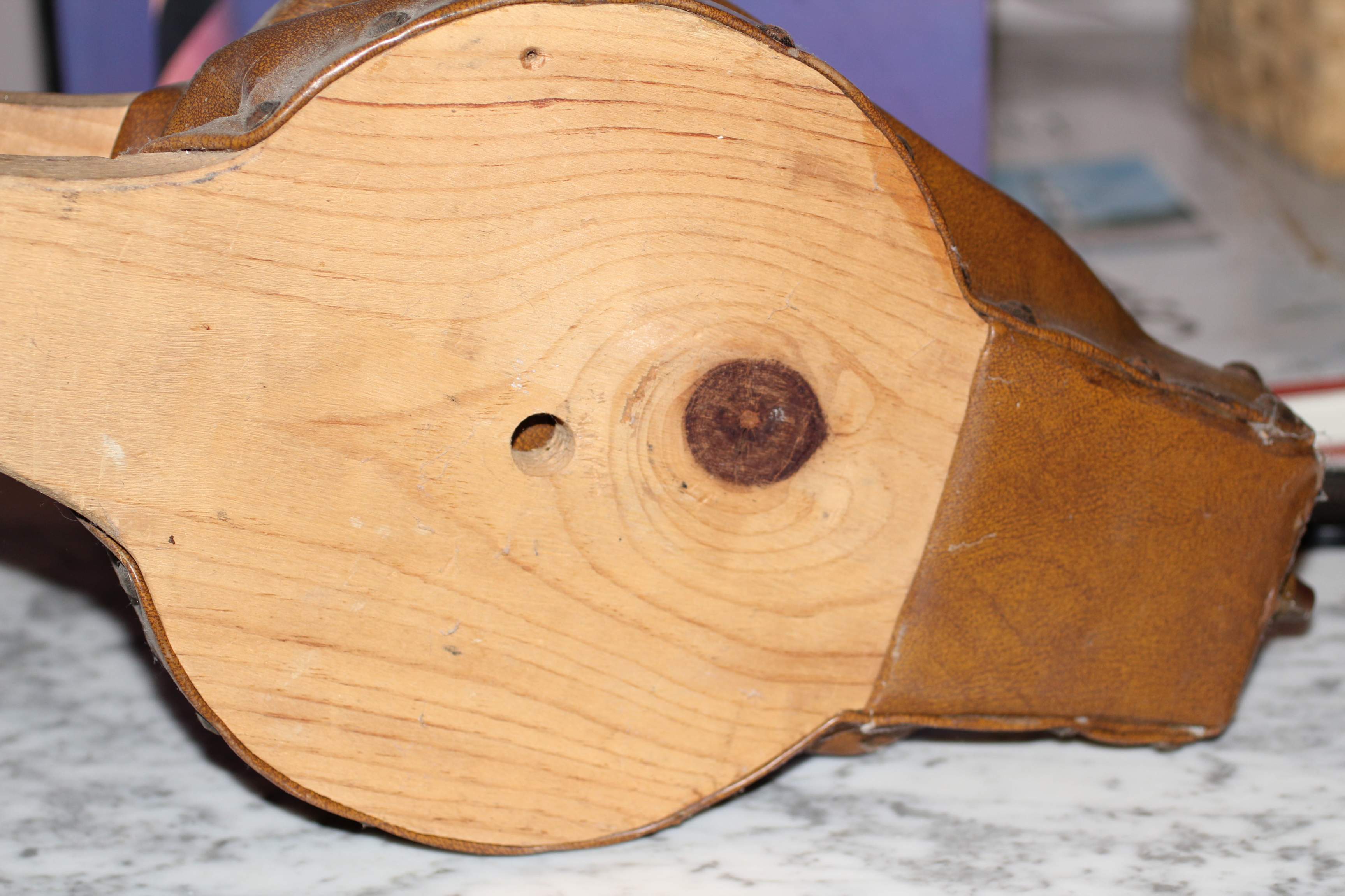

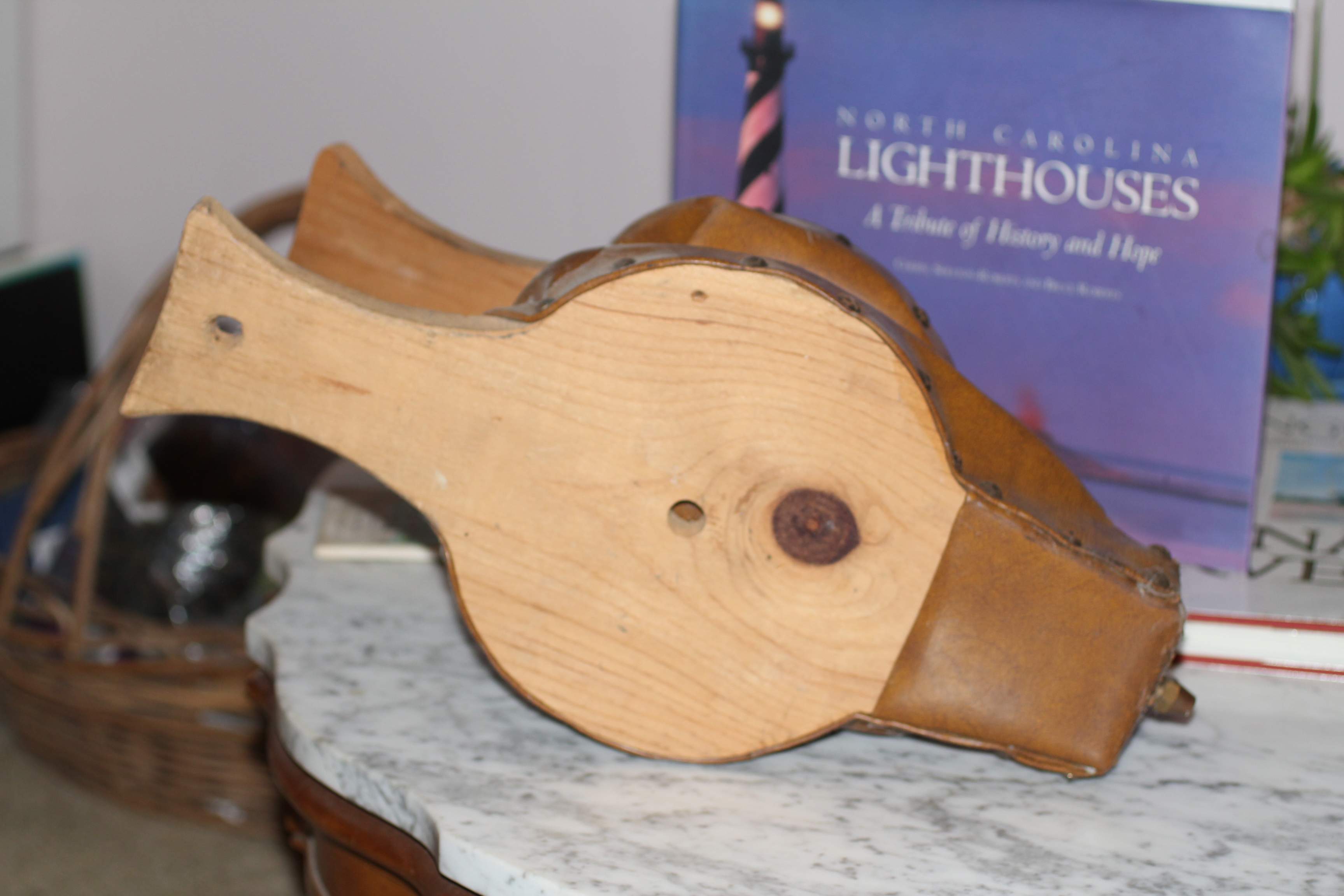

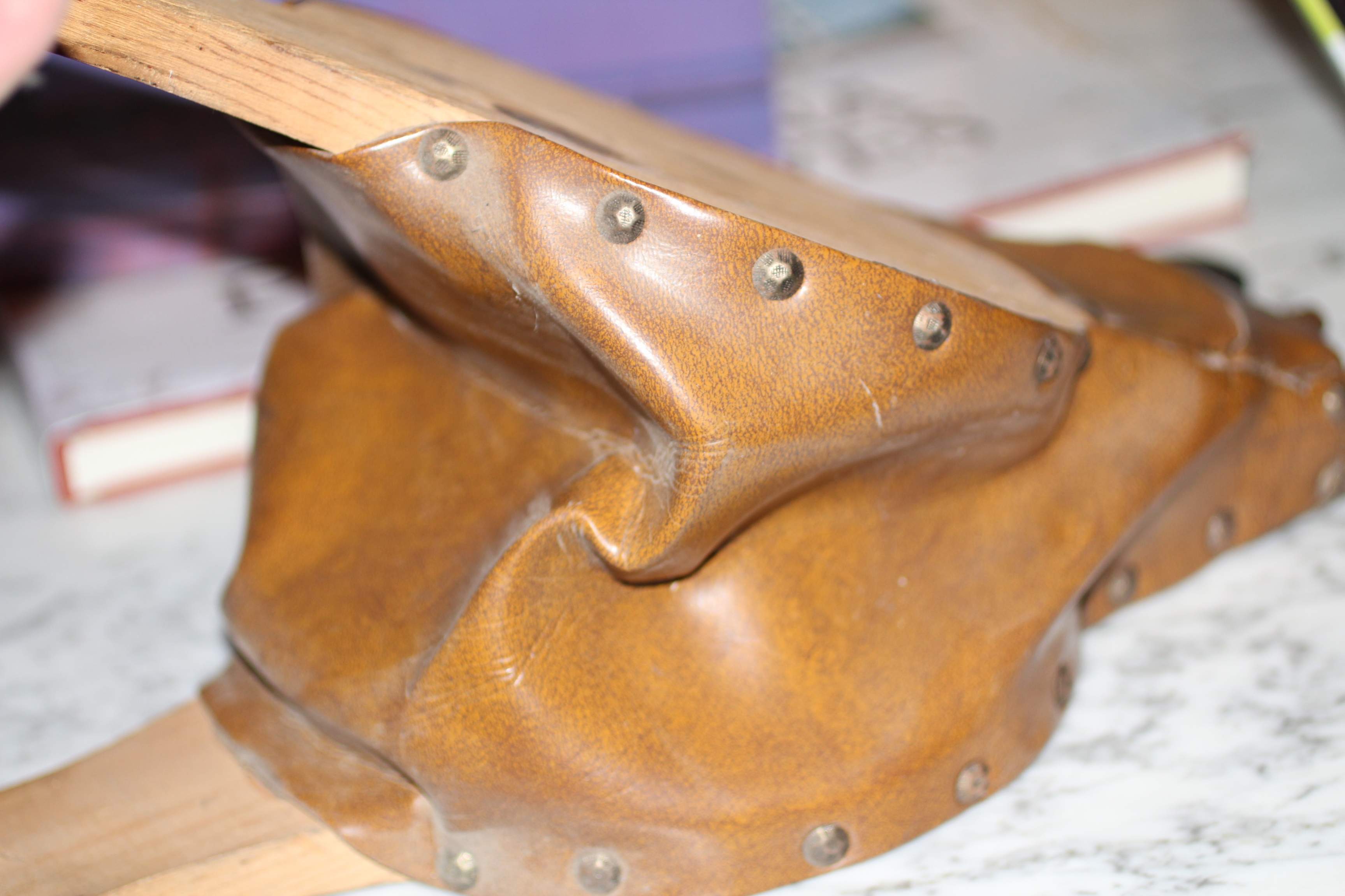

Here are some pics of one I made about 30 years ago. Body is pine, about 8"x16". Leather came from scrap somewhere, maybe old furniture?? Leather hinge, brass nozzle (1/4" flare fitting) Hole in body has leather flap on inside for the intake valve. Still works.
