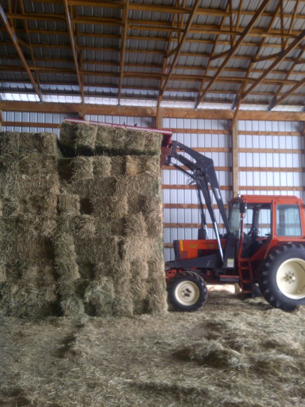

I imagine it was a bit different running the 925 with MFD I know I wouldn't be with out MFD now on a loader tractor.
I've lifted some heavy loads with mine as in pallets of lumber. The loader had a hard time lifting but I made sure I went slow. I've bent one of the lift cylinder rods running the bale head attachment. Dropped it too fast one day and ... it didn''t like that! Machine shop built me a new rod so it wasn't too bad. 18 bales x 60lbs is only 1080lbs but then the bale head wieghs a fair bit too and it sticks out so far. The tractor handles it pretty good way better then the 970 Case I have actually. With a load on the case won't ... turn the front wheels plus the hydraulic vavles are not that good for loader work. Belarus has a joy stick with seperate hyd. vavles. Problem though with the 825 is the loader is not quite high enough so you lose reach when its all the way up. It works but the top tier is tough to get off. Thought of another loader but I don't know wouldn't mind having a bigger tractor some days.

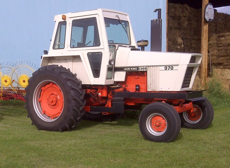

Our old 970 has been good to us we've had it since new in 1974 and its been a good haying tractor. It actually has its 40th birthday on this April :thumbsup: The 2090 while a nicer tractor to drive and decent cab for its age has had its share of "mechanical issues" lets just say.;) Good thing its easy to work on and I fix stuff. It only has some 65xx hrs on it.
Problem though with the 970 is the hydraulic vavles are basically ON or OFF when under heavy load. Its not easy to "feather" the controls on the loader. Guy told me once people used to screw on extentions onto the leavers making them longer thus making it easier to for loader work. Never bothered though as I use the 825 now but still have a big old Leon loader for the 970 that we bought 30 years ago. Its a high lift model which is usefull but clumsy and visablity isnt' great on the 970 compared to the 825.
Back in 2007 I think it was I rebuilt the motor as it was using oil. Then I figured I'd paint it too while I was at it that winter. Well the paint job took way longer then rebuiding the motor!
