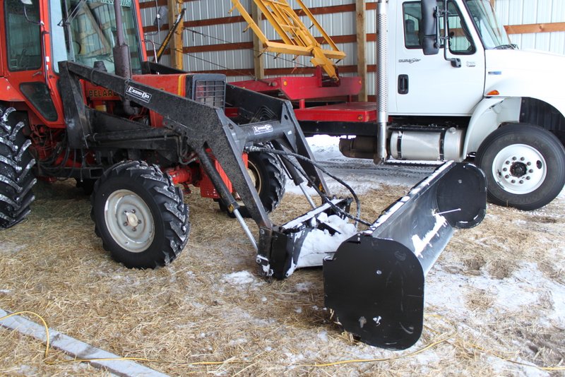

/ Belarus Tractors #68
Good grief I just paid 4K for my new snow blade for the 825 a couple months ago!!! If its in good shape like you say you basically paid for the tires and got the tractor for nothing. Please don't tell me you got a 925 plus a loader for $4000 as that would be a new record buy for a Belarus I think. Obviously the former owner didn't know what he had or he knew about the 3pt hitch issue and wanted to gone bad. Man I never find deals like that, I have seen them cheaper but they've been beat to ****. Well at 4K investment you got nothing to lose if the rest is ok.
You got a dealer up there selling the newer MTZ ones too now I see.

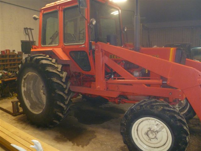

Yep, just 4 grand but it had no loader on it.(dealer estimate was 15 grand);)
I put that on my self,i got the loader for free from a neighbor. I just had to build the brackets and put new pins and bushings in the loader arms.
and fixed up the rams. I painted it to match the tractor for good measure.(maybe out of pocket $500)
I build the 2 bale fork in the 3 point as well.

825 snowblade.JPGLooks good real good you did well on that buy. A 95 pto hp tractor with MFD and cab all for $4000... would have been a good deal at 5000 hrs never mind 800hrs. That's quite the bale fork you got at the back there how heavy are your bales as that would be a load if their big heavy ones. I thought your 3pt was not functional?
I see you supported the loader properly with a brace going to the rear axle. Some guys rigged them up with nothing to the rear and then had issues down the road :eek:. What kind of loader is that looks a bit like an Ezee On 100 loader or maybe Leon? Looks heavier then then what I got on mine. I have a Ezee On 90 on mine and its a bit light.
Just a note I see that one has the original rims and 5 stud hubs on the front. Keep an eye on those studs(1 1 /16" nut) if carring heavy loads or do'n heavy pushing as they like to work loose. They went to heavier rim for that model then to more studs on the newer models. Mine came with the heavier style (thicker) rim on one side and an original on the other. Also watch the oil level's on those little gear boxes on the front axel. The oil in the angle gear box on the side can leak down in the bottom one and you wouldn't even know it. Pretty easy to fix and just some O rings from what I remember.
You don't see as many used ones for sale anymore like you did 10-15 years ago. There are want ads on Kijiji now for 825/925's even I've notice. Local dealer used to sell them but now even he doesn't seem to have used ones anymore.
Hey does you cold start heater in the intake work?? I haven't got mine to work properly as of yet. I gave up on it right after I got it as I usally just plug it in anyway. Then I got a Valtra which has the same sort of idea for cold starting and it works real good. So I was checking the one on the 825 again this fall but still it doesn't seem to work. It gets power and heats up and the fuel seems to drip down on the element at least on the bench when I took it off and tried it.

View attachment 355602Looks good real good you did well on that buy. A 95 pto hp tractor with MFD and cab all for $4000... would have been a good deal at 5000 hrs never mind 800hrs. That's quite the bale fork you got at the back there how heavy are your bales as that would be a load if their big heavy ones. I thought your 3pt was not functional?

The 3 point is operational, i just don't know how long the lift arm support pin flange bolts will hold in that peanut butter casting.
That's why i mounted it the way i did, i rather fix a weak point on the loader supports than have a broke bell housing(seen enough of those)
I have no clue what brand loader it is,..could be ezee-on? It came of a 1070 case originally.
Thanks for the heads up, i'll keep an eye on it
