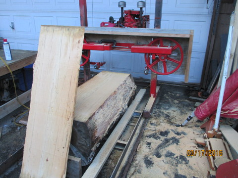

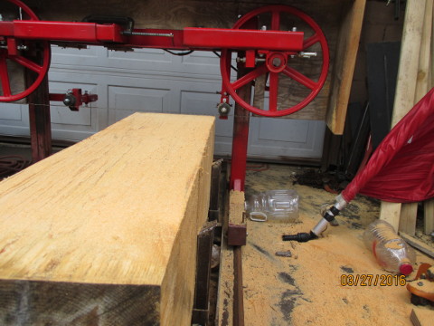

Rob, Looks like a good fix. Maybe you can show some of that board and batten you're working on.
That where I am on my mill, I need to make log dogs and stops.But I couldn't resist making some sawdust.

Rob,What's the diameter of your log stops, in the picture they look pretty good size.

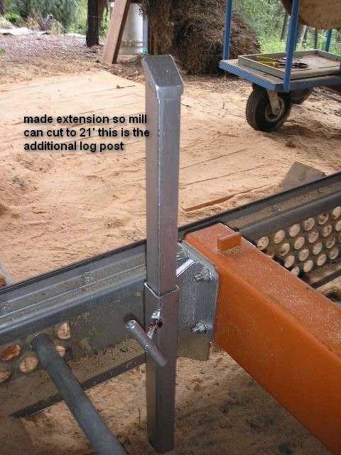

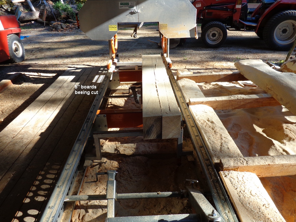

Made a couple extra log posts for my mill so here's a pic. to give you an alternative idea.
I think it's 1.25" tubing. It can be flipped around to still hold when sawing down to 1" material.

Billrog, I'd like to see the other dogs the, the ones that tighten to the log.

/ Been working on a mill. #31
Richard I'll see if I can find some you can visualize and if they interest you I'll get the measurements of the material sizes.
Out of hundreds of mill pics. I don't seem to have many of the dogs check through the pics. in Photo bucket there may be more. Mean while I can take some descent pics. if you like.
Cheers Bill
