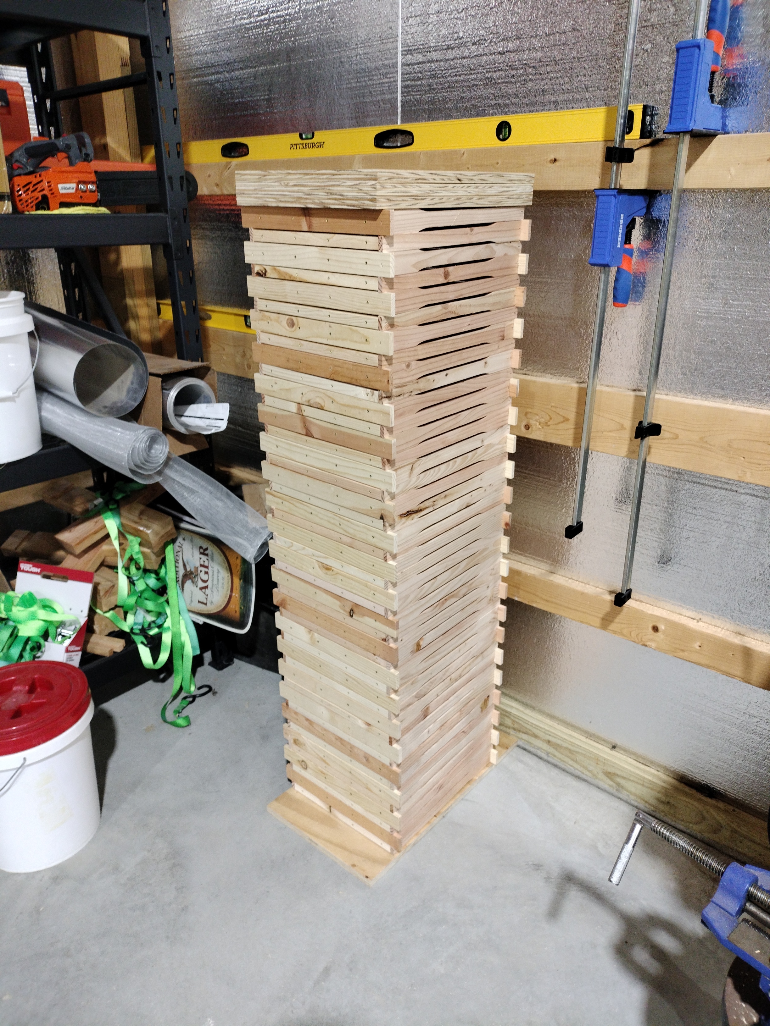

Assembled a few frames tonight. Got 8 more bee boxes ready for interior insulation.

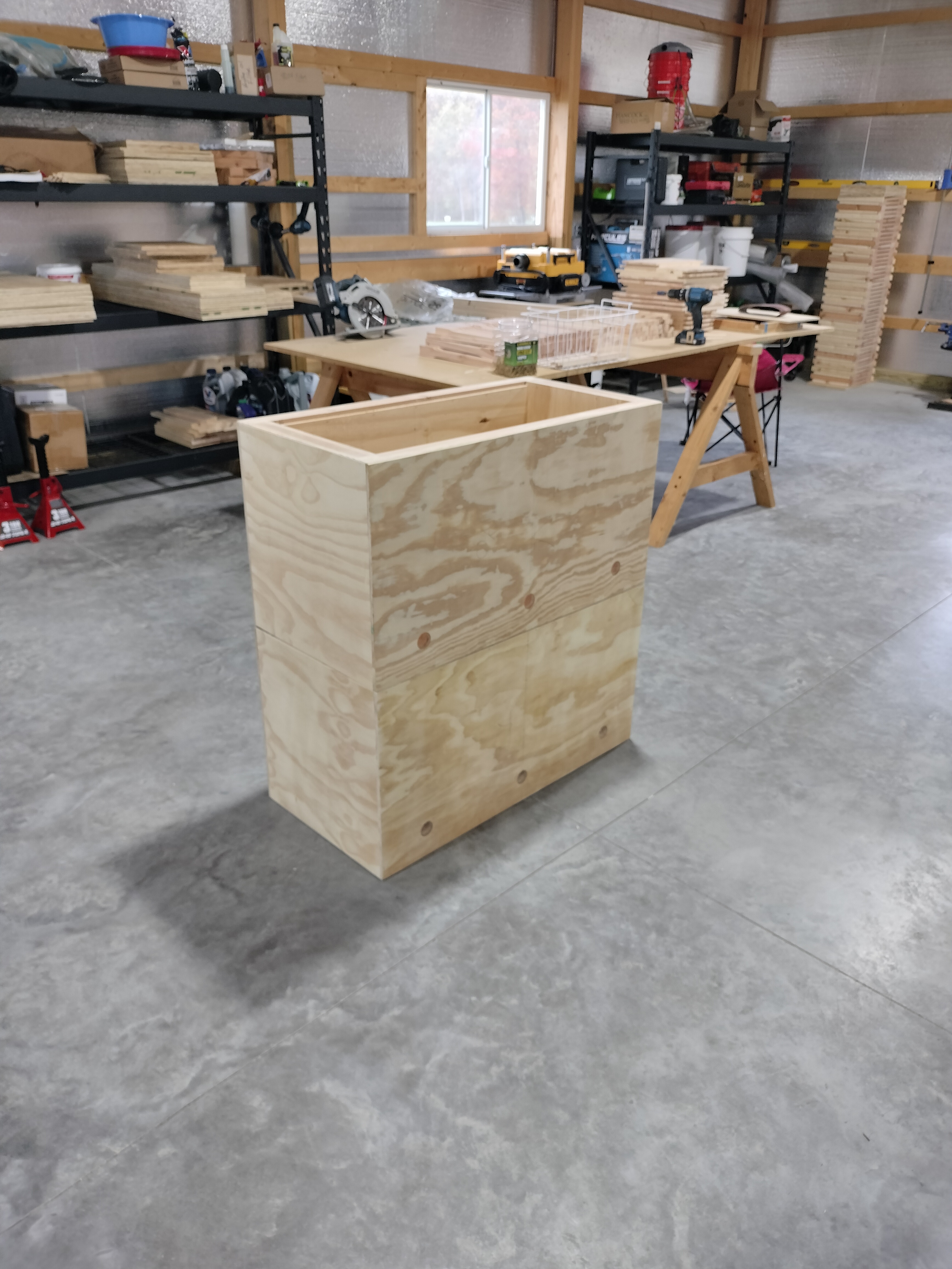

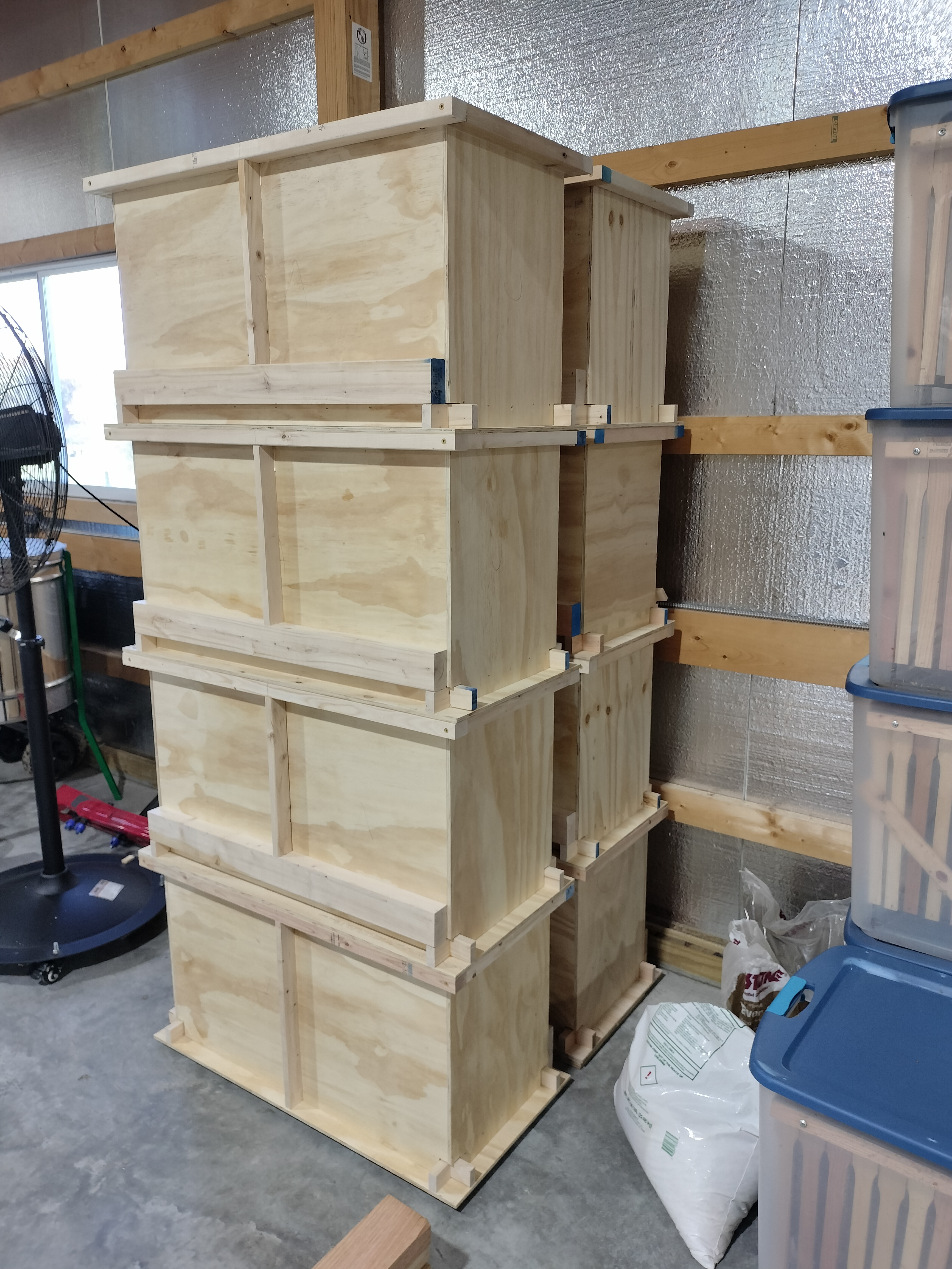

   / Beekeeping #758
So this time around I enacted a few more quality control measures for these boxes in a box... Wow, what a difference. Keeping the inner and middle components aligned so that the outer panels align perfectly, has been a challenge. But this time around they are amazing. I planned to build these orders over winter... But it seems I'll be finished by Dec 1
   / Beekeeping #759
So this time around I enacted a few more quality control measures for these boxes in a box... Wow, what a difference. Keeping the inner and middle components aligned so that the outer panels align perfectly, has been a challenge. But this time around they are amazing. I planned to build these orders over winter... But it seems I'll be finished by Dec 1View attachment 4327251
What did you do differently? (Looks gorgeous)
All the best, Peter
   / Beekeeping #760
All the best, Peter
I have begun measuring corner to corner for all of the interior walls to ensure they are centered to the bottom. Also made a jig to ensure the interior wall heights are correct and uniform. They are all within about .015" after assembly. Those set up your exterior walls, so if they are off, your exterior walls will be misaligned
It's really an issue of stacking tolerances as you build them from the inside out. The original plans do not address that issue or any ways to mitigate it. I've been building them for about 5 years and each time tweak the process. These are by far my best boxes ever.
