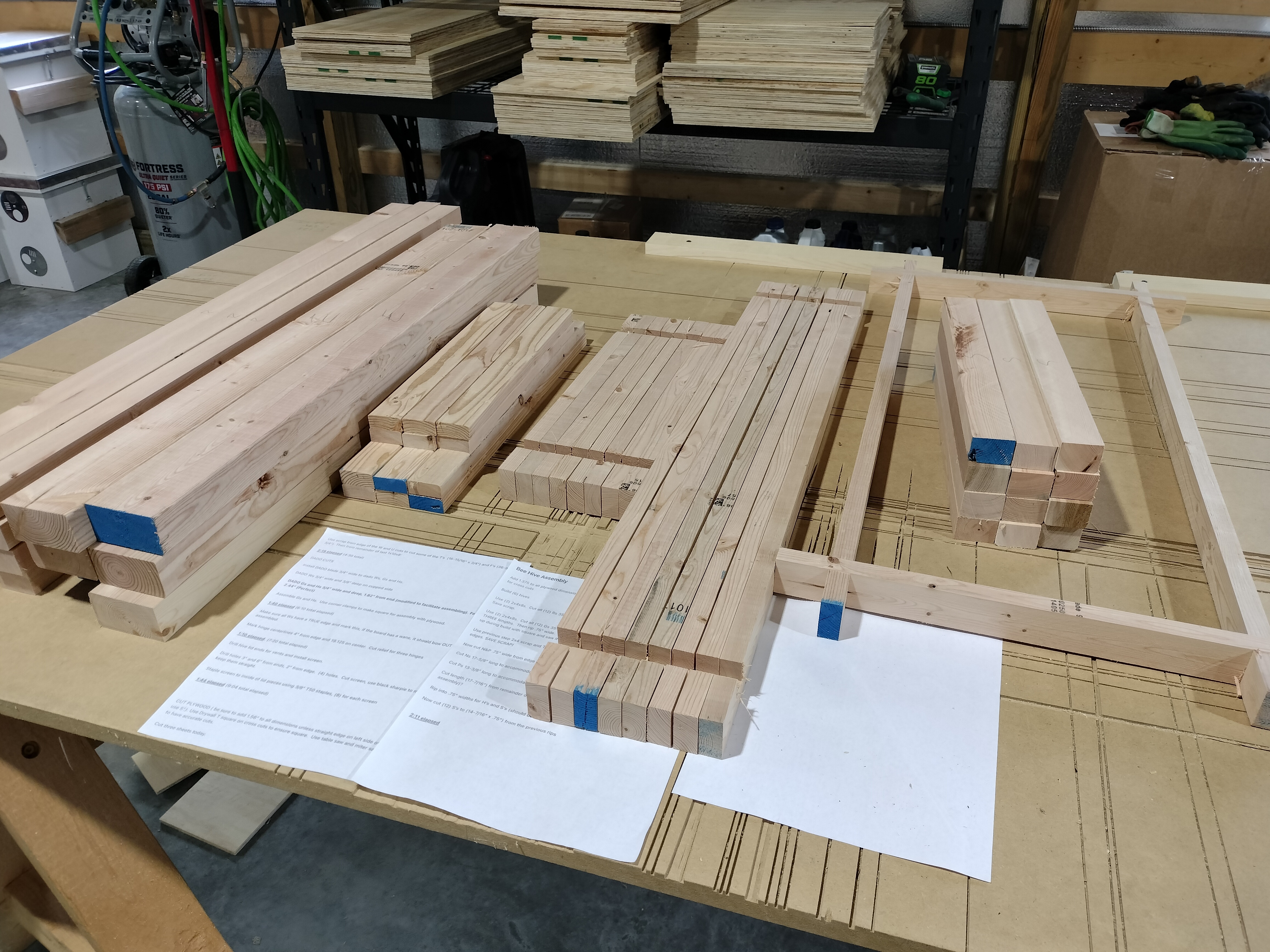

12 hours to cut the lumber for 6 more hives. I love being well stocked with parts. The lumber this time around was the best I've seen in 6 years of building these.
I need 3 myself.
I have commitments for 10 to be sold.

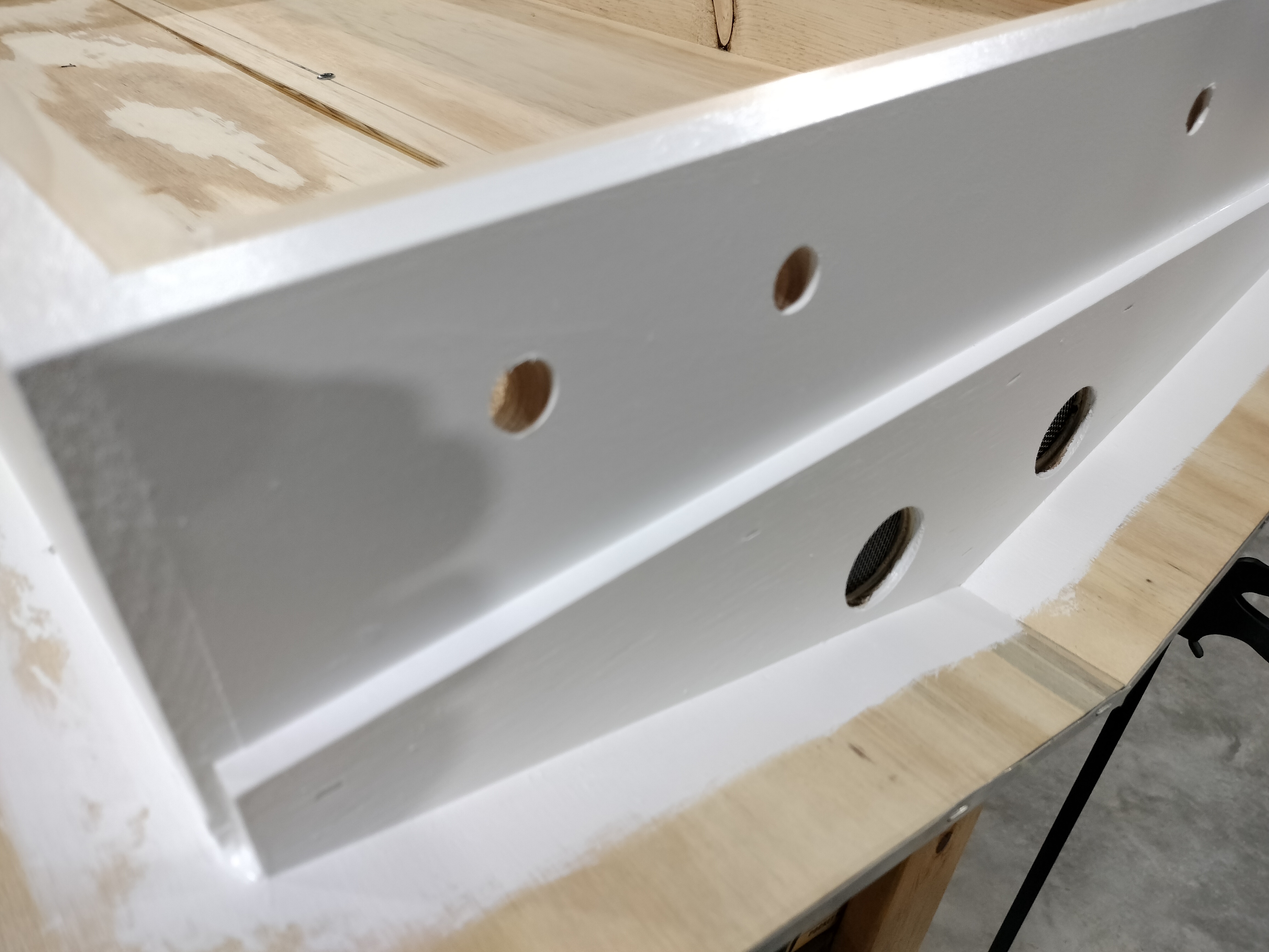

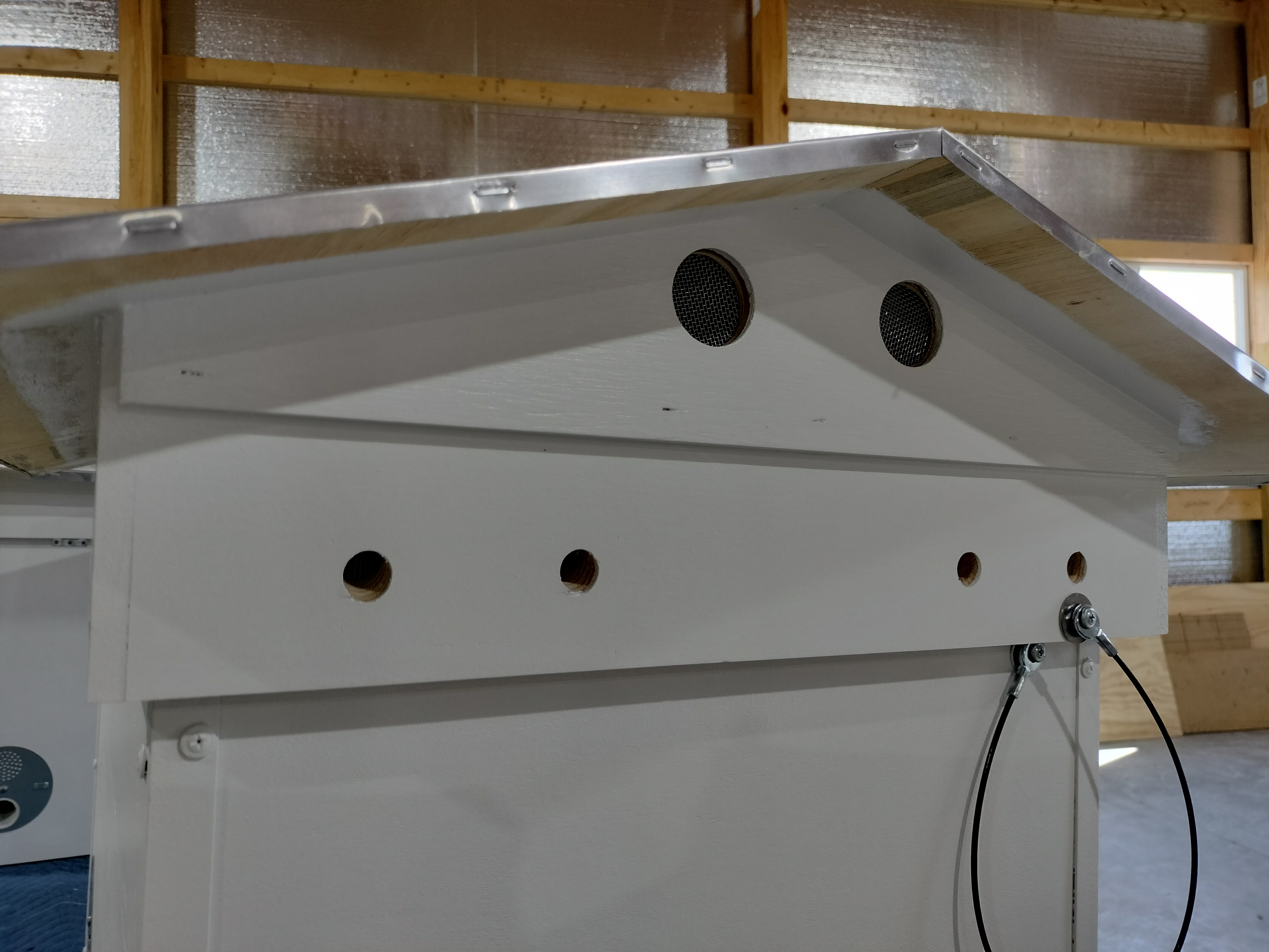

Finished up a few more hives. I changed the gable end design. Instead of a full opening with screen, I semi enclosed it. Looks better and will keep out some wind driven rain/snow.
These are for colonies that have been in non insulated hives all summer, and have been struggling with the heat. These insulated hives should help a lot.

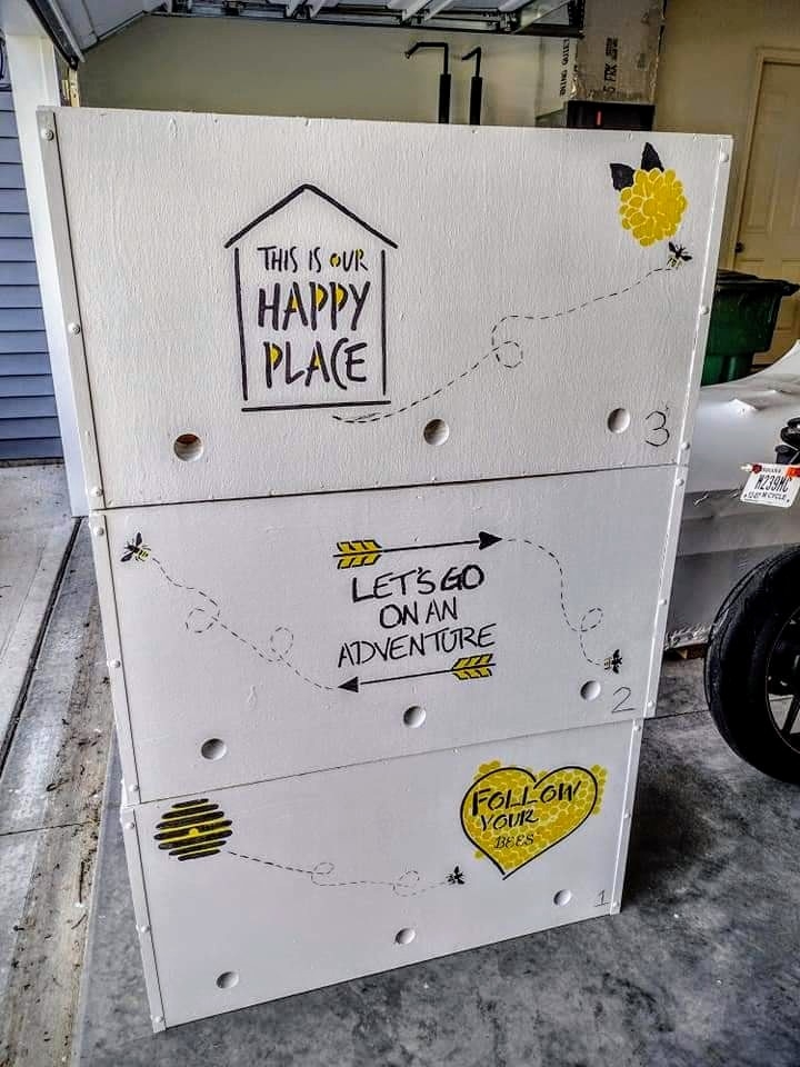

We used to get more artistic... But that takes too much time and energy at this point.
Now I fill all the staple holes with putty and sand before paint. I chamfer all of the corners. I sand the boxes between coats of paint to make them super smooth.

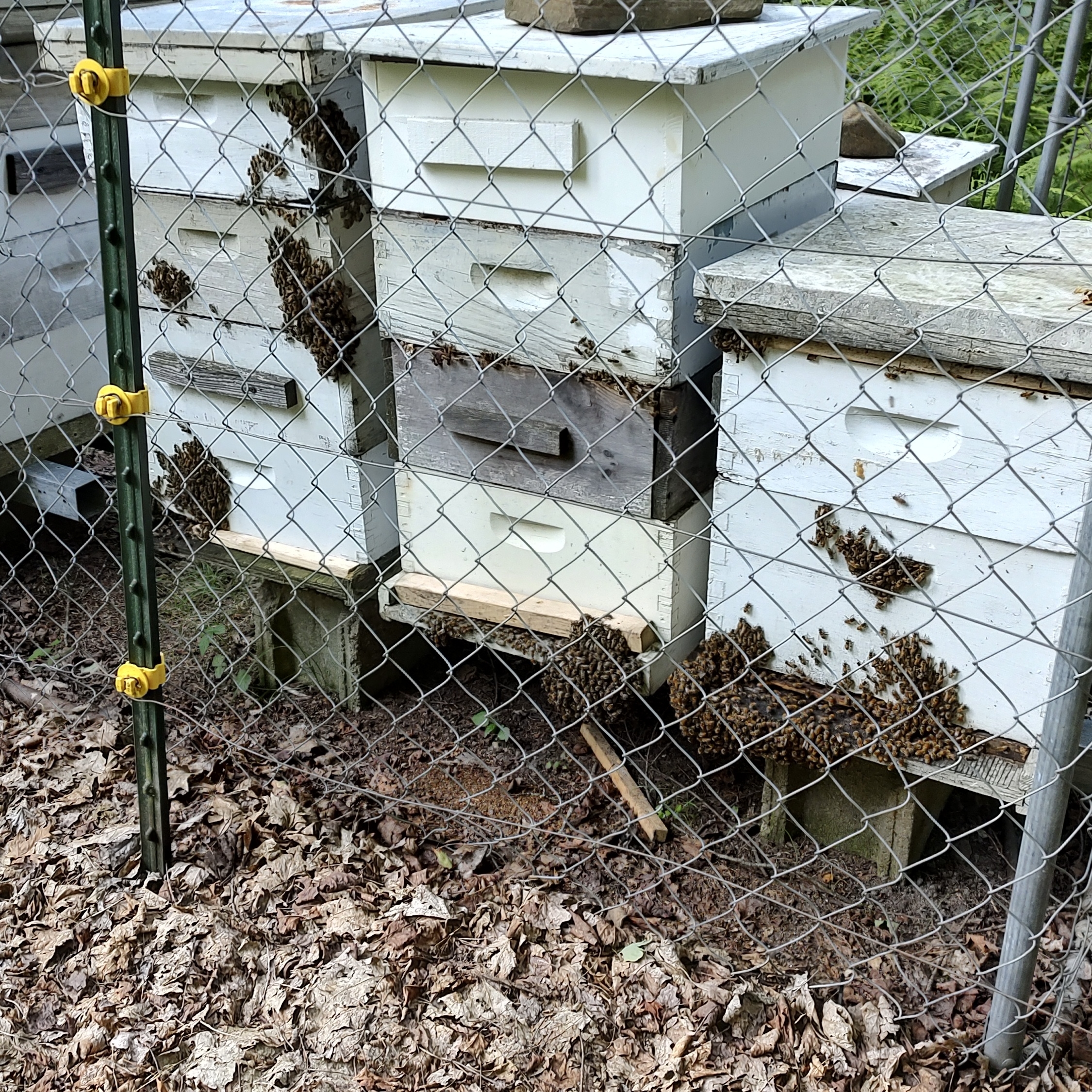

I could never set my hives up like your picture Clover. The local bear(s) would have a field day. I have to keep mine under lock and key.
I will say that your hives intrigue me. I’ve tried top bars in the past but wasn’t a fan of them.
