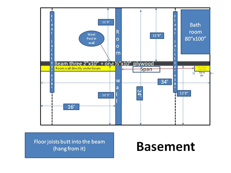

I want to know how far a beam can span. I finishing my basement.

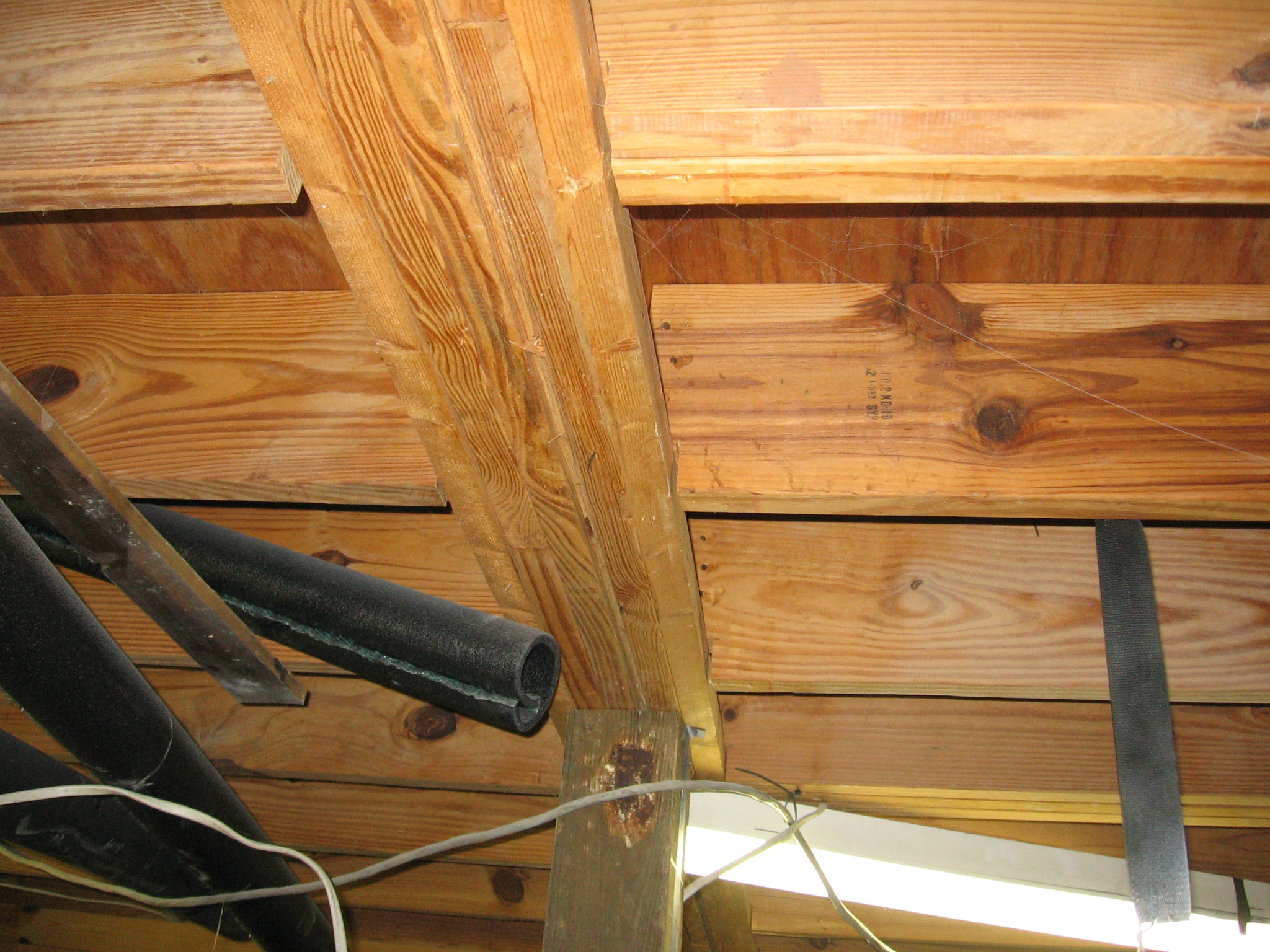

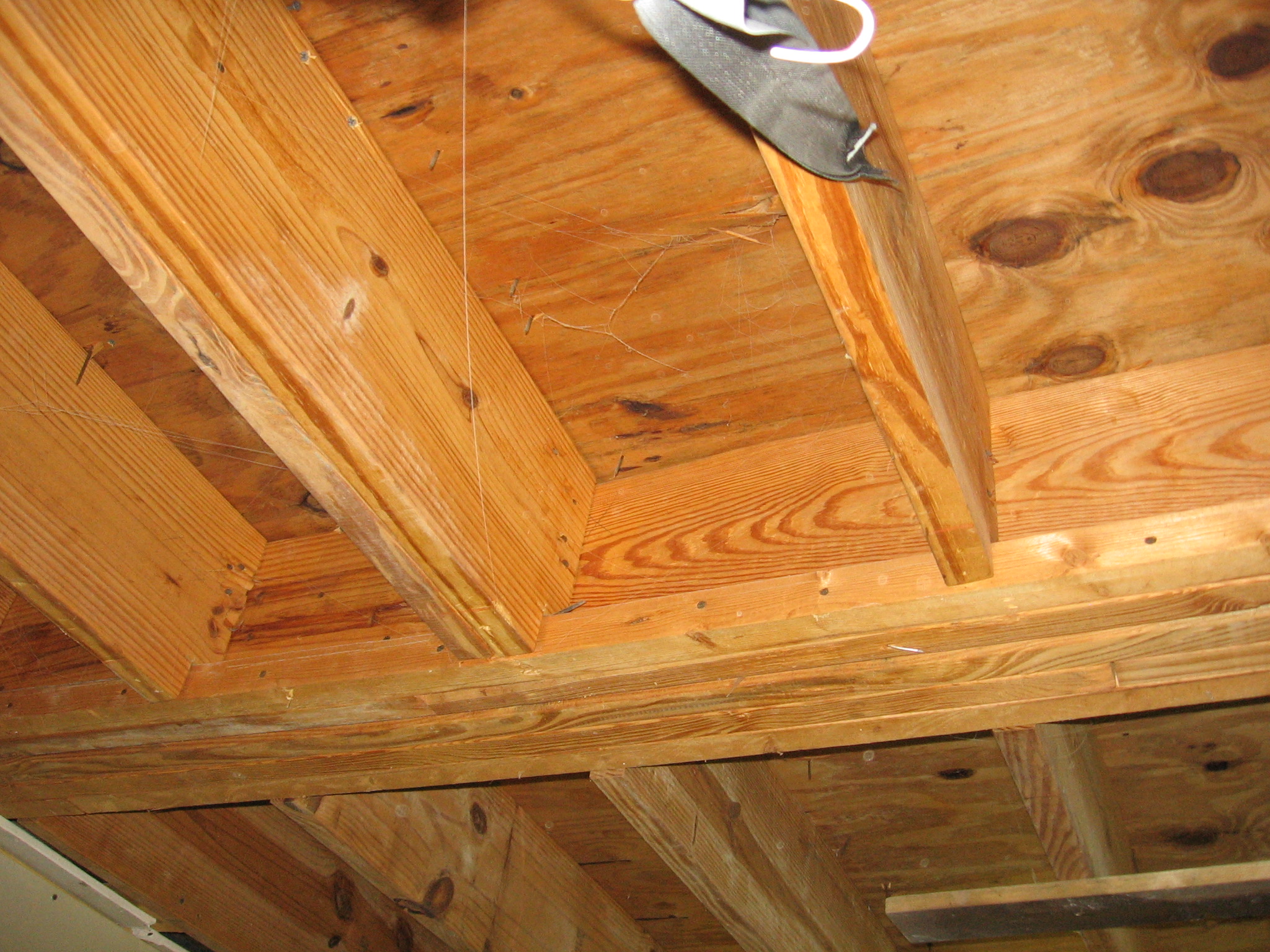

Beam in questions is made of three 2"x10" and a 1/2' sheet of plywood nailed together.
It is part of the main floor of my house and has floor 2"x10" joists attached perpendicular on both sides on 16" centers. The joists are supported by the block foundation on both sides one side spans about 11'9" the 12'3". The load above the beam is a hallway and a bed room/office and in the attic there are 5 roof truss supports.
I want to span 17' if possible without additional supports.
First question can the existing beam support the 17' foot span?
Second what do I need to do to reinforce the existing beam?
I've thought about running another beam under it made from 20' either 2"x6", 2"x8" or 2"x10" with 1/2" plywood and attach it to the existing beam with metal plates between the joists.
I've thought about running another beam under it made from 20' either 2"x4", 2"x6" steel and attach it to the existing beams.
A friend who is a ENG mentioned cutting the plywood out and taking a I beam with a 7" web and having the the top flange removed and placing it where the plywood was and then bolting through the 2"x10". How would I cut the plywood out my only idea has been a chainsaw?
Could I use 3 x 2 x 3/16 Steel Angle on both sides of the existing beam and bolt it through and do the same thing?

What your friend was talking about is called a flitch plate beam. Below is a link to a worked example with at 2x10 beam / flitch plate with 1/2" steel.
STRUCTUREmag: Flitch Plate Beams
The example shows a 12' span.... Seems to me in your case it would make economic sense to break it up into two 8.5' sections. Which is probably what you already have...

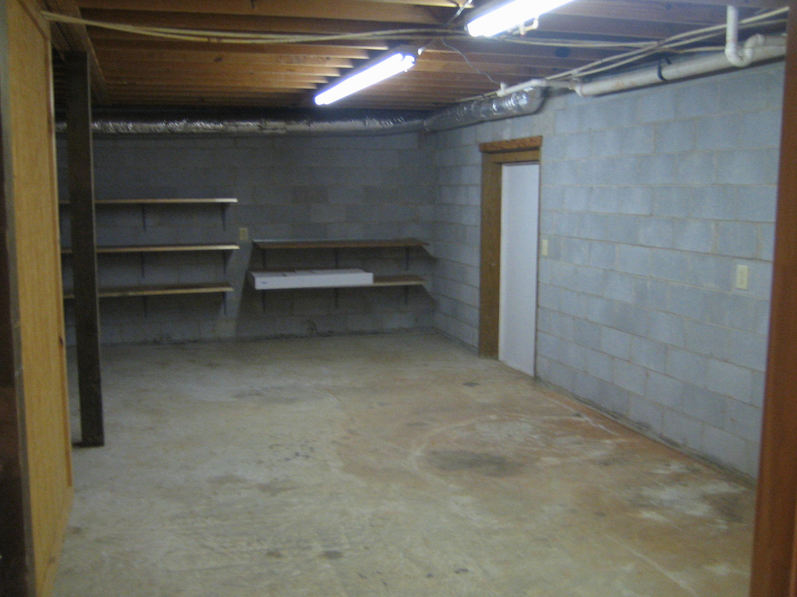

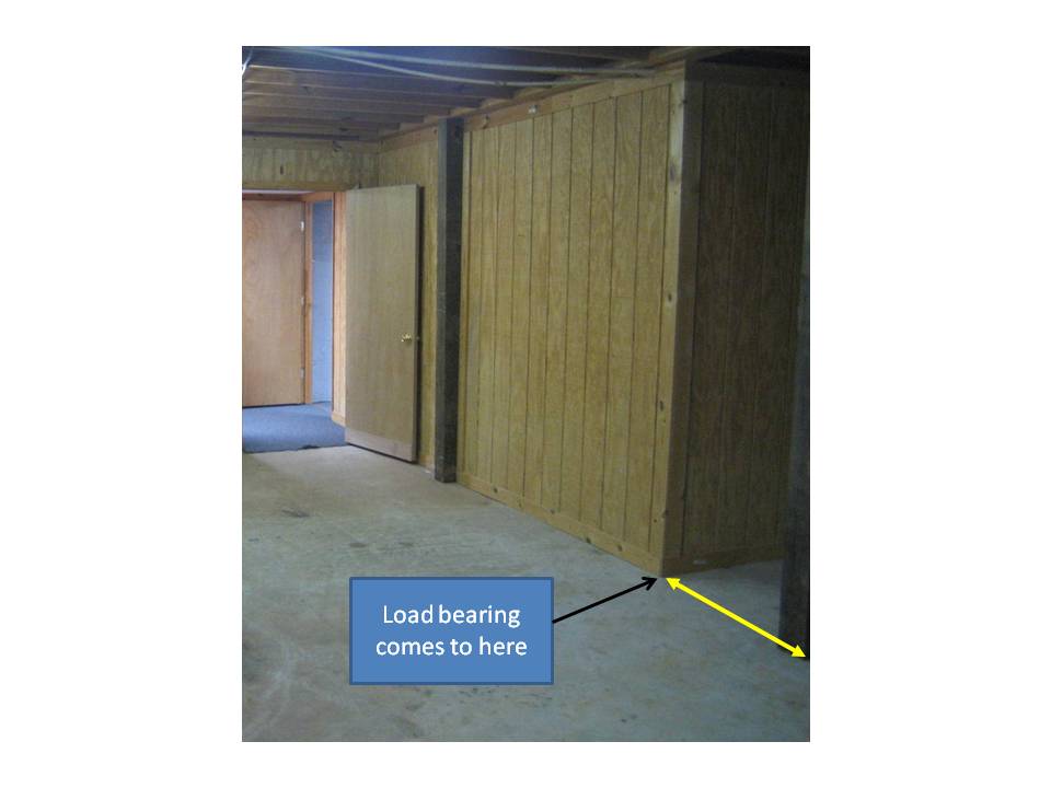

The existing beam had two support posts 12' 6" apart in the 34' total span.
We don't having an inspector/inspection program out here.
It is a whole lot easier to span 12'6" than 17'.
You really need to have this beam designed by an engineer.
The steel angle idea is not going to work.
The right way to get rid of the plywood is to start over with new 2x10s.
You can probably buy an engineered wood beam which will span the length required, but the depth will be a lot greater than 9.5". Whether you can accept the reduced headroom in that part of the basement is up to you.

So are you saying that you want to modify the origional 12' 6" span and make it 17'?
Are there any load bearing walls/posts above this beam?

Here's my take:
He wants to span 17'. The load being supported is a finished floor load from a residence. So the design load per square foot should be around 40 PSF/live and 10 PSF/dead for a total of 50 PSF.
This beam is supporting floor joists that are perpendicular to it. One side spans 11'-9", the other 12'-3". The beam will have to support the load over half the span of each side (the remainder of the load is supported by the concrete block walls on which the floor joists bear (or are attached).
So our total floor area to be supported is 12' wide (half of 11'9"+half of 12'3") by 17' long, for a total square footage of 204 sq. ft. Multiply this by 50 psf = 10,200 lb load.
What I'm not sure of it if there is additional loading to be supported, because I'm not sure if there is a wall above that is holding up weight and if there is ceiling and roof loading or if the trusses that he mentioned actually span the distance and while they may set on the wall that sets on the floor area, the floor actually bears (essentially) no additional load.
So now we've got to see if the existing beam will hold the weight.
The span table I have works in 2' increments, so I'll average between 16' and 18' span.
A 2x10 will hold up about 1,000 lbs over 17'. It's a triple 2x10, so that's only going to support about 3,000 lbs.
If it were supported at the mid-point of the span, then the loads are cut in half. A 2x10 at 8' span supports 2,139 lbs, so a triple would hold 6,417 lbs (which is well over half of our load of 10,200 lbs).

If a clear span is required, I would say he would need to go with an engineered beam or a steel beam.
From an old chart that I have, there are many beams that will support 10,200 lbs over 17 ft. The two lightest that I could find are a standard I-beam, 10 x 4 3/4 (25.4 lbs/ft) and a wide-flange I-beam (10 x 5 1/4, 21 lbs/ft). There are a couple of 8" tall beams that would support it as well. Both of the beams listed are rated to support at leat 16 kips at 18' span.
In my opinion, this is more of a carpentry equation than an engineering calcution. I think that we are dealing with (more a less) a residential situation, so dragging engineers into is probably not necessary.
Obvious disclaimer: unless local codes require stamped or engineer-approved plans, etc. etc. etc. I'm fortunate that I live in an area without such codes for residences, so I have never had to deal with building permits, inspections, etc. so I cannot account for that.
At any rate, bottom line, I don't think the existing beam is capaple of supporting the load, long term. I don't think that a good answer can be manufactured from dimensional lumber being attached to it. I think the options are either:
1. a post on the existing beam
2. a steel beam in place of or underneath the existing beam
3. a pre-engineered wood beam in place of or underneath the existing beam
Good luck and take care.
Edit:
Sorry, I didn't retain the part about the overall span being 34' and (I'm assuming) you want to separate it into two 17' spans instead of three 12'6" spans. In that case, I would use a steel beam under or in place of the existing and supporting it with a column (unless you wan't to add more posts).
And I see that an inspection is not required, so no worries there. I think it's obvious that the best thing to do is take the advice of unknown people from an internet forum! (This is what I hate about typing a post - I can can't convey voice inflection. I can't even find a proper emoticon. What I'm trying to do is come across with a good-natured ribbing comment, and I'm afraid it may sound like a condescending jack@$$. So I'm just trying to be funny, not a jerk....although sometimes, I can do both).
Anyway, good luck and take (again).
Not two 17' spans the one span is 16', but it has a load bearing wall under it with one steel post at about 15' and multiple doubled 2"x4" and one tripled 2"x4".
Here are some pics and some drawings.

For reference Code here in northern Illinois allow 9' span with three 2x10's on a single story house.
/ Beam Span????? #18
Am I correct in assuming that (what you are calling) the truss supports run from the attic area and are either bearing on or are inside the hallway way, which in turn sets on the floor joints that are supported by the beam?
If that is the case, we just need to add together the area of the roof that is being supported by truss supports in the same manner in which we did the floor area being supported and add that to the calculation (and account for the dead weight of the wall).
Are the trusses (are they trusses or rafters - because I don't see any of the webbing that trusses have, so I'm wondering if they are not just rafters) running parrallel with the 34' dimension of the house? Is the peak of the roof in the middle (and I have no idea if it is a simple gable roof or if it is more complicated than that).
I would still say that it will boil down to that there is not a "good" way to do it by adding dimensional lumber to the existing beam. I think you will still have to either go with an engineered wood beam or a steel beam (or add/leave a post).
Good luck.

I just taked to a building supply place and they recommended removing the old beam for the 17' span and replacing it with 2 LVL's either 14" or 16" deep. LVL's are 1.75" thick so I'll have to put a 2"x10" or a 2"x12" between them to equal my current beam width.
/ Beam Span?????
#20
Good luck.
You are correct they are rafters.
