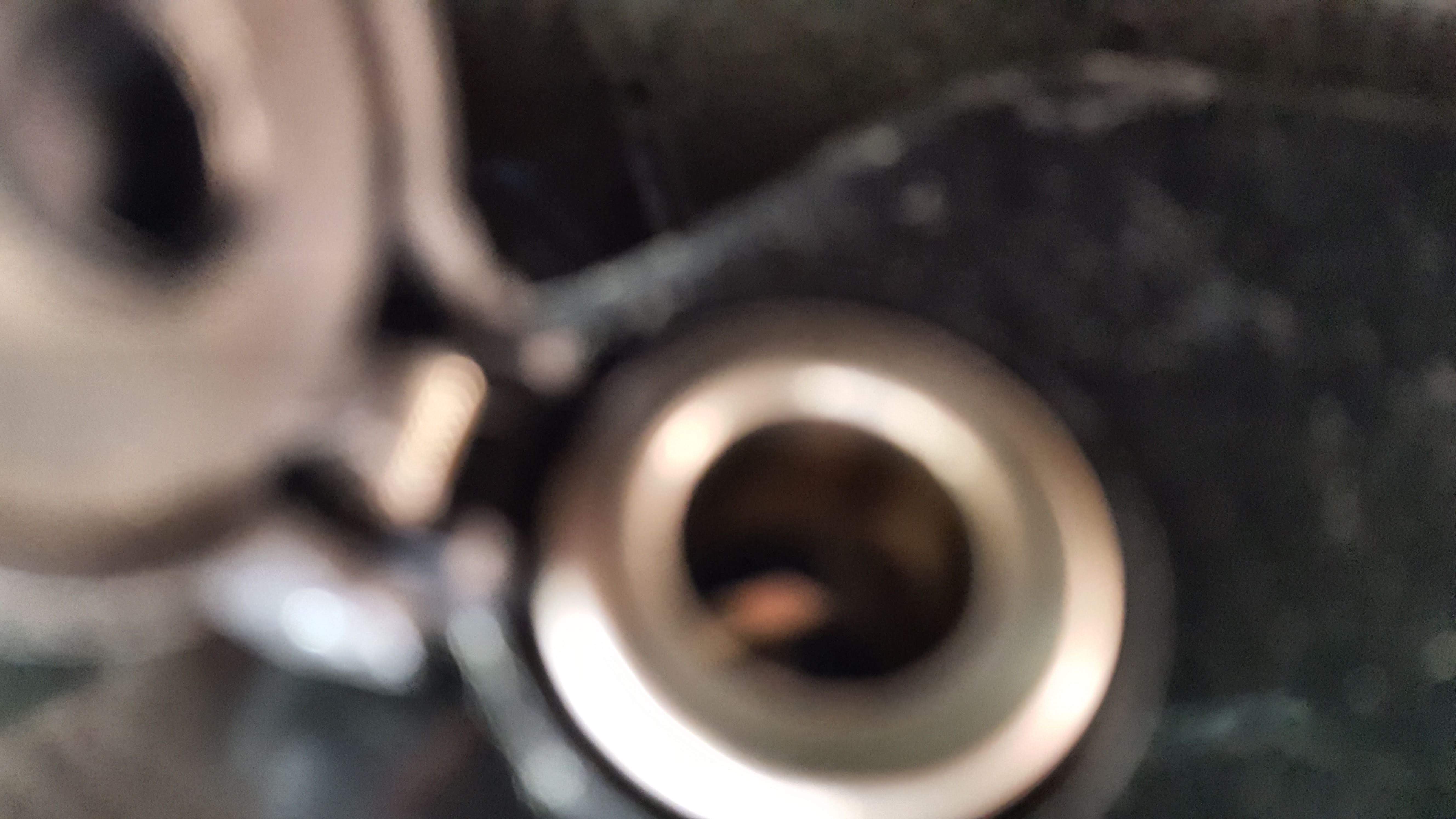

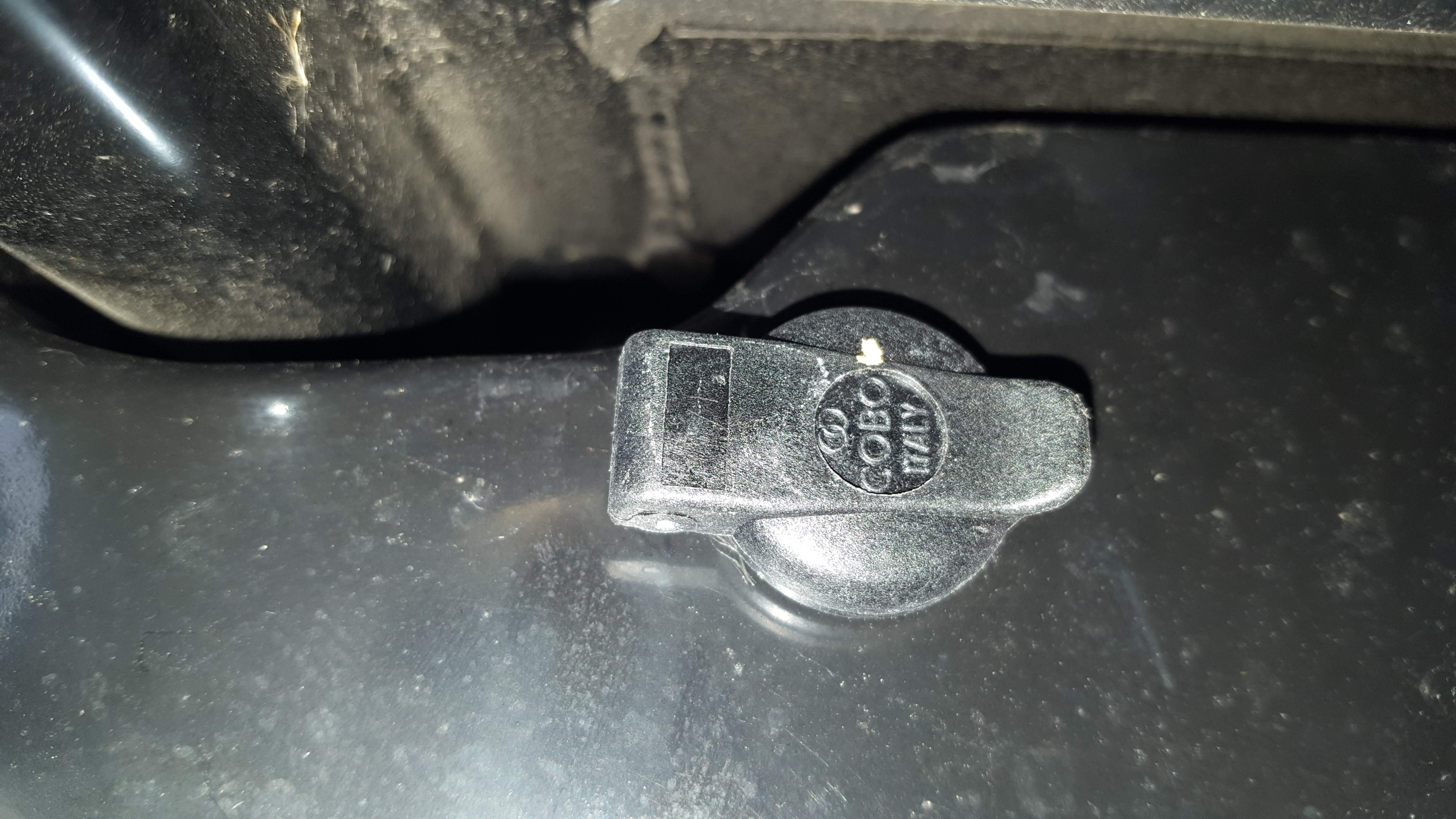

I have a xr3135HC and at the rear corners of the outside at the top of the cab there is a flip down cover. I was wondering if that was a plug-in location for the beacon lights.
If it is, can I buy just the plug? Or is it only available with the beacon? (I want to use the beacon switch to power a different attachment)

That’s it.
A while back, I’d guess a year or so now, someone here researched that plug and posted where to get it. It’s a very particular connector, but it is available.

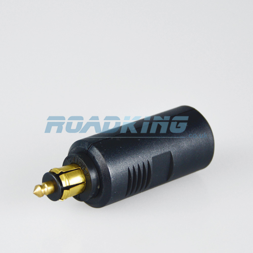

Is it smaller than a regular cigarette lighter socket?
It might be the Hella socket then.
Something like this:

/ Beacon plug? xr3135hc #8
That's it but you need the low profile one that bends 90 degrees or you will not be able to open the side window with it plugged in.
