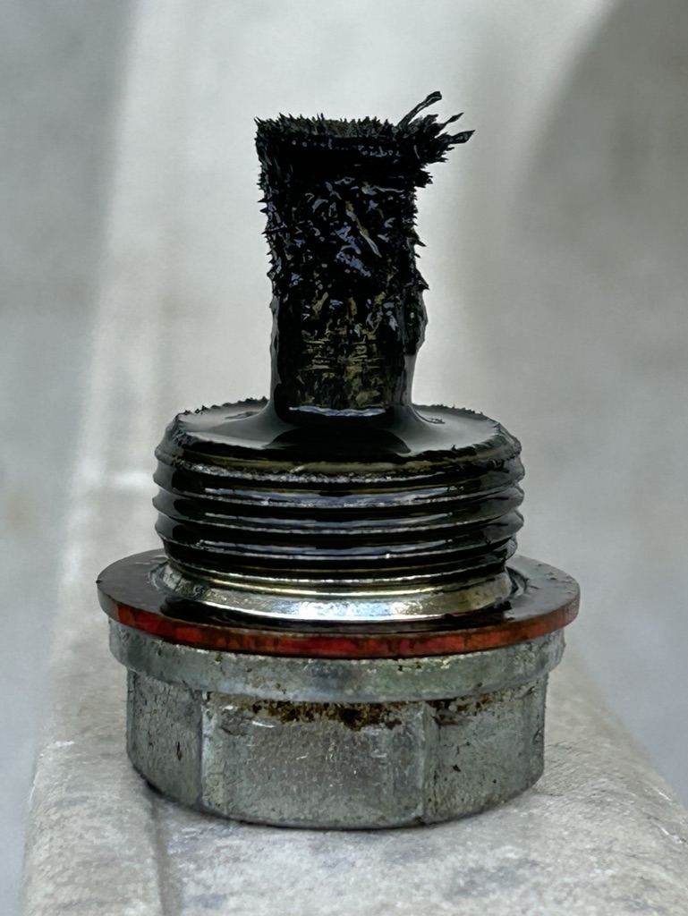

Recently I passed 400 working hours on my BCS 740, which meant that it was again time for a bit of maintenance. According to the BCS manual, the transmission oil, including the filter, should be changed every 100 hours, and the magnetic oil cap should be cleaned as well.
The Honda owner’s manual also recommends an engine oil change every 100 hours, as well as cleaning the air filter.
I always remove the engine protection bar for better access to the 2 engine drain plugs, and while the oil drains, I remove the recoil starter and cleans it and the area behind it from debris.
This is how the magnetic oil cap looked this time:
Compared to the photo in post #20, there are perhaps slightly less metal particles this time, but I’m still puzzled that it is this much :unsure:

Jens, I changed the gear oil on my 739 last fall. I never did get an hour meter so don't know how many hours. But I think I remember changing it and the filter not too long after I bought the thing and thought it was probably time again. I had an empty filter box on the shelf that I kept for the part number and thought there was a filter in it so I didn't end up changing the filter since the box was empty.
Anyway, I was surprised to see a decent size chunk of what appeared to be the end of a gear tooth stuck to the magnet. Along with some fine splinters like you have there. Maybe a 5mm diameter piece of metal. Not round at all though really. I don't know where that came from other than me grinding some gears too hard. I think I do remember accidentally reversing under load. And I tried a couple times to "feather" in the pto engagement with the clutch.
If there's any metal in the hydraulic clutch pack, that could be where the fine stuff is coming from. That clutch must be under an unbelievable load instantly engaging and disengaging with the brake and all. I'm surprised it can even handle that abuse. Other than that, I think what you're seeing is perfectly normal. Every magnetic plug I take out of every component on every piece of equipment I work on always has fine metal particles on it. It's simply normal wear of machinery.
A BCS is completely rebuildable. All the parts are available AFAIK. If something catastrophic happens it can be fixed. No problem. Come to think of it I can't remember ever hearing about a BCS ever failing except for the motor. And the cone clutch seizing up. Have you ever heard of one braking?
Despite the piece of metal, mine still runs and operates as it should. I use mine all the time, some of the best money I ever spent. I couldn't get by without it. It will be interesting to see if any of us can wear one of these things out. Looks like prices have practically doubled due to inflation.

Hi Nibbana ;)
You are probably right, that the fine splinters on the magnet are what one has to accept as part of the normal wear of the tractor :unsure:
At the first oil change I wasn’t that surprised, as I took the material on the magnet as part of the normal run-in procedure, but that it is still this much, surprises me a little - but OK. I can’t help to think if there are also some metal particles in the oil filter? Like you, I try to be as gentle to the gearbox as possible, but due to the simple sliding mesh gearbox that our tractors have, it takes quite a lot of experience and skill to avoid grinding the gears and PTO once in a while :cry:
That you have found a 5 mm piece of metal on the magnet doesn’t sound right to me. I would also guess that it is the tip of a gear wheel, either from the gearbox or from the PTO-mechanism.
One of the disadvantages of this type of gearbox, is that it is almost impossible to engage or change gear while moving. As my tractor was new, I did try to practice changing gear while on the move, but it takes a lot of skill and practice, so I decided to do all gear changes, all engagements of the PTO, and all changes of direction from a standstill. This hasn’t eliminated the occasional „grinding“, but it has reduced it a lot.

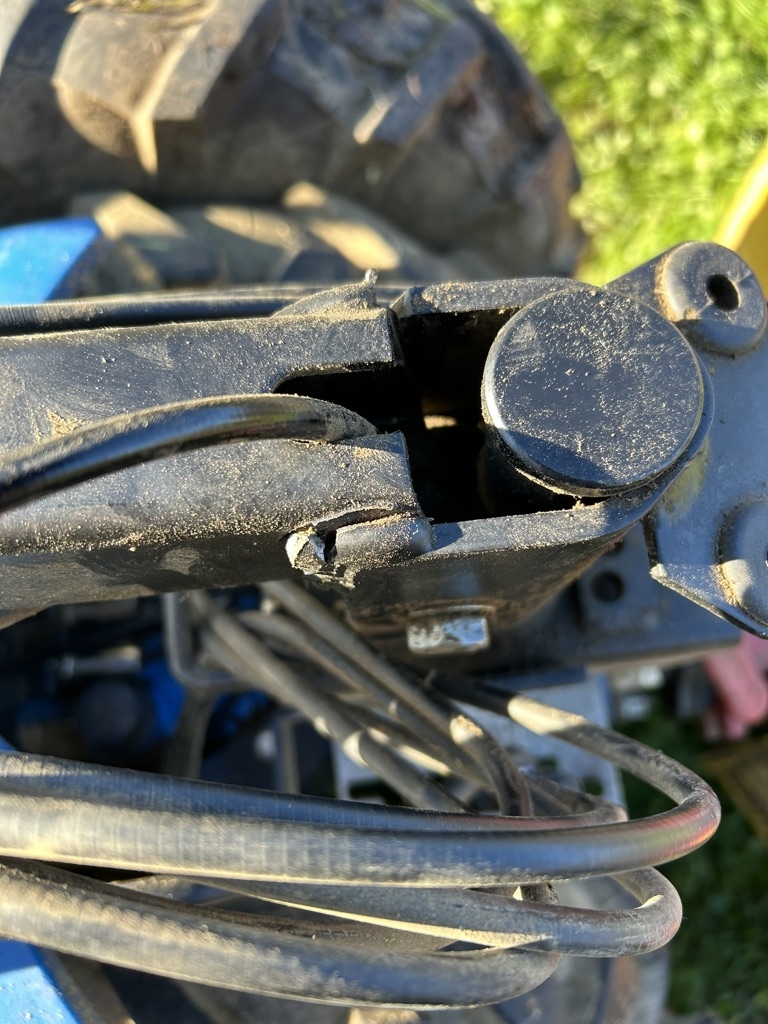

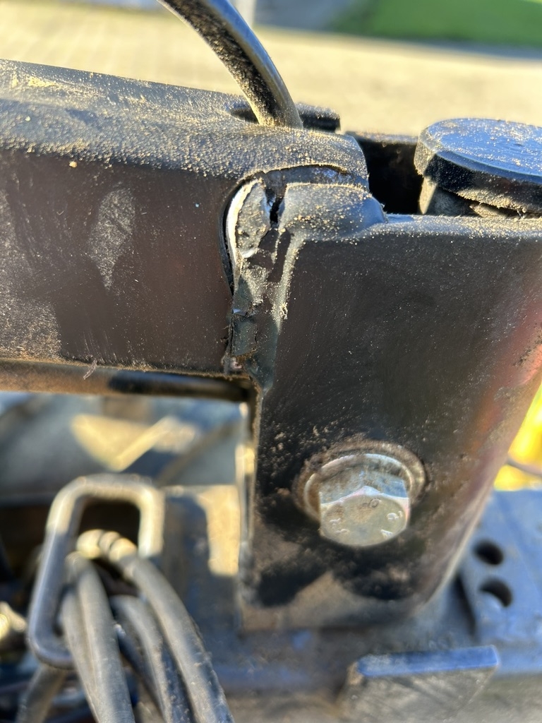

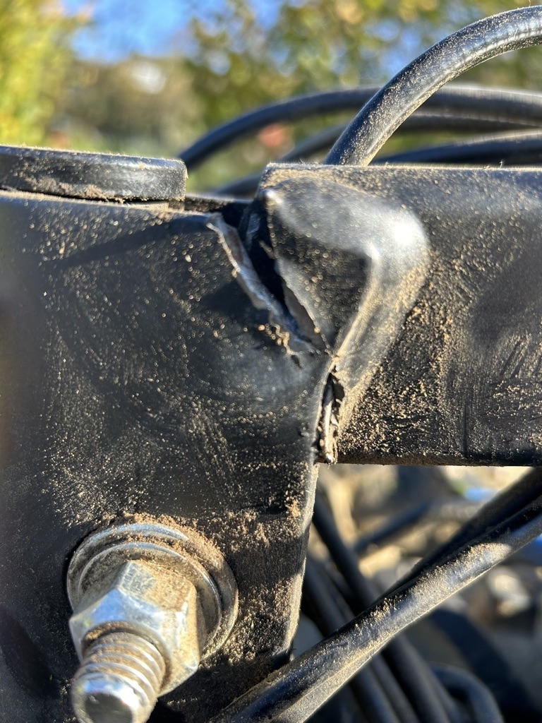

Only 5 days later bad luck struck again, this time hitting the tractor itself. At the end of a job with the drum mower, the handlebars felt „spongy“, especially in the vertical direction. As I had parked the tractor on the trailer, and removed the blue plastic bit that covers the handlebar assembly, I saw the following:
The left photo shows the left hand side of the handlebar assembly where it swivels around the vertical post. The right photo shows the right hand side.
I am of course aware that this is a part of the handlebar assembly that has to cope with quite a lot of stress, especially when working with heavy implements like the flail mower or the drum mower. Still, I was a bit surprised to see this.
This topic was mentioned more than 4 years ago in the „Berta flail mower“ thread, where our member „ppea“ expressed his concerns regarding the risk of braking the handlebars when working with heavy implements. I have had similar concerns over the years, especially with the flail mower and the drum mower, as they are quite heavy, weighing 92 kg/203 lbs and 80 kg/176 lbs respectively. Pressing hard on the handlebars to get these heavy implements off the ground, of course puts a lot of stress on the lower part of the handlebar assembly where it meets the vertical post. Up till now I thought it was up to the job, but it wasn’t anymore :cry:
As with the drum mower recently, my neighbor had a look, and with his lifelong experience working in a machine shop, he had a to me surprising comment concerning the welding on the right hand side: „It’s not the handlebar assembly that has broken, it’s the welding!“ I’m no expert on weldings, but to me there is a clear difference between the two sides of the handlebars. On the left hand side the welding seems to be intact, whereas on the right hand side, it seems to me that the welding has given in, and the assembly itself is still intact. This can perhaps be seen even better on this photo taken from above:
For a professional welder like my neighbor it was no big deal to weld both sides again, and in the future I will need to keep an eye on these parts more often (y)

Looks like the plate sheared on the left side and the weld started to crack on the right Jens. Did you take the assembly off or did your neighbor weld it on the tractor?
