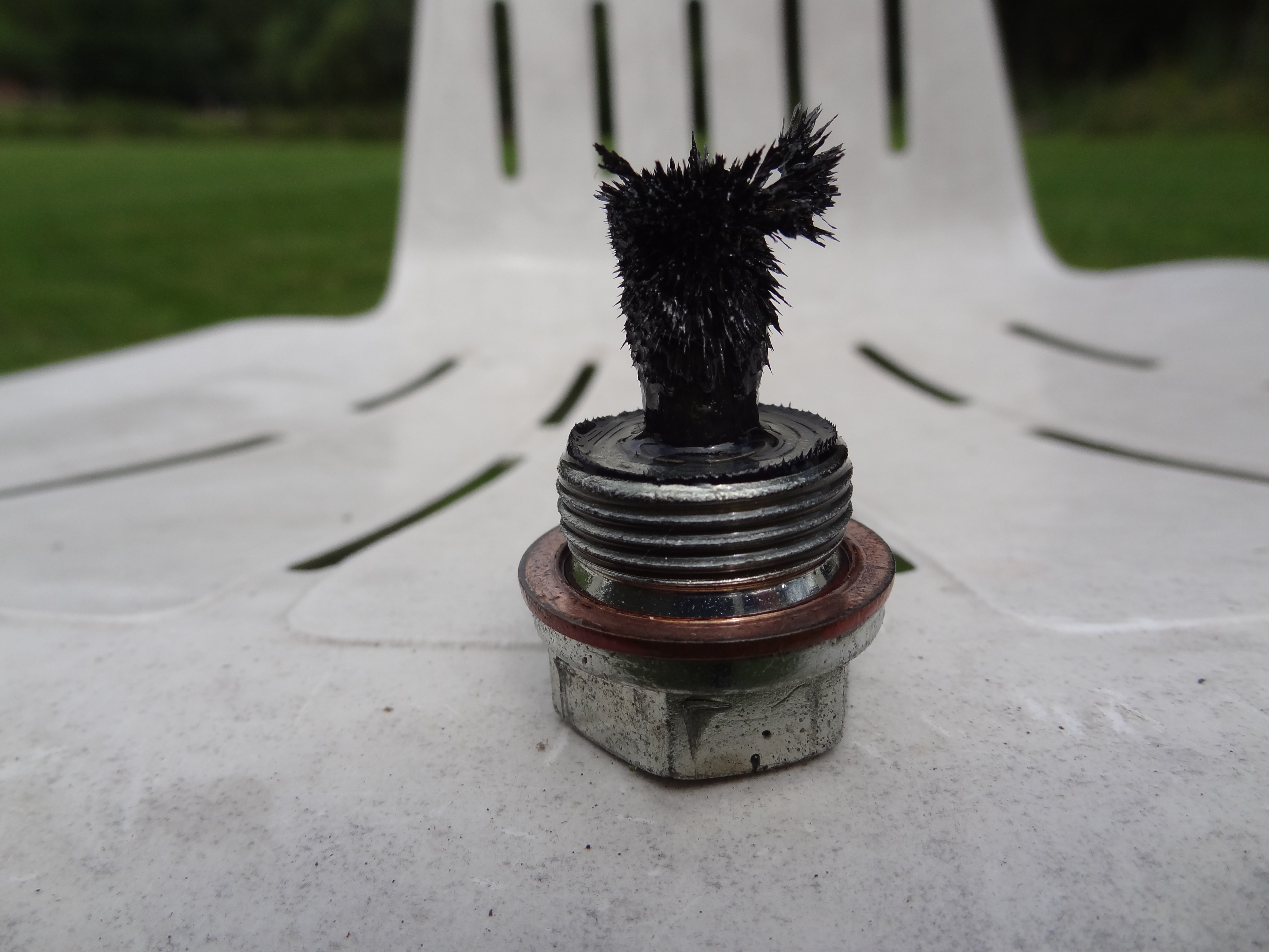

/ Bcs 740 powersafe first run-in #14
Hi again BCSSHOP :)
As I passed the first 100 hours on my BCS 740 last summer, I changed the oil in the gearbox, cleaned the magnetic cap, and finally replaced the oil filter as recommended in the user's manual. You mention in your post of March 13th 2013, that you haven't replaced an oil filter yourself yet. Perhaps you have by now? You recommend, "to always remove and clean the magnet drain plug when you change the filter".
This makes sense whenever you want to change the oil in the gearbox, as the magnetic cap also have the function of a drain plug. For the first 30-hour change of only the oil filter, I suggest that you leave it in, or you will for sure have a lot of oil running down your garage floor.
When changing an oil filter on any machine, it's always wise to look inside the filter for any metal particles that might indicate the wellbeing of the machine. At my 30-hour and 100-hour oil filter change, I didn't see any metal particles. I expected to see some fine wear-in particles on the magnetic cap, but I was nevertheless very surprised as I removed it for the first time, and saw - what I consider to be - quite a lot of metal particles (see first photo). Comparing it to the cleaned cap on the second photo, it seems as a lot of wear-in particles for my taste.
I would highly appreciate any comments from members who have done an oil change in the gearbox, and especially, if you have had a similar experience with wear-in particles on the magnetic cap. I look forward to see the magnetic cap at the next oil change by 200 hours.

/ Bcs 740 powersafe first run-in #15
I haven't taken mine out yet Jens so I can't compare. But, that doesn't seem like a lot of particles to me. It's a brand new gearbox so there are going to be burrs on just about every part from the factory. Maybe not every part, but there are going to be some. It would be hard to clean every burr out of the castings and get every burr off every moving part. And as the parts wear in together they will shed some metal. You'll probably get less as it breaks in. It looks normal to me.
I am going into my third year and have only changed the filter. I have no idea what the hours are but I'm trying my best to wear this thing out. I use it a lot. The fluid itself is perfectly clear. I didn't even really see any point in changing it at all, but now I see that it might be a good idea to clean off that magnet. Straight 90 weight GL5 gear lube is not available here in New England. The only 80w-90 GL5 lube that I can find is the Valvoline. I usually use Mobil synthetic lubes but they only offer 75w-90.

/ Bcs 740 powersafe first run-in #18

Hi 😉
3 years have passed, since I removed the magnetic oil cap on my BCS 740, and changed the transmission oil for the first time. When considering that the transmission oil passes through an oil filter as well, I was slightly surprised to see the amount of wear-in particles on the oil cap then. When comparing with the pictures in the 2 posts above though, it is perhaps what one might expect.
After adding another 100 hours, I now passed the first 200 hours on the tractor, so I was up for the second oil change - and the third oil filter change. I was very excited to examine the magnetic oil cap, and as can be seen on the foto, there was much less metal particles this time - as I had hoped :thumbsup:
In 3 years time - when the next oil change is up - I hope to see even less particles on the oil cap.

Since a few weeks, I have had my BCS 740 for 10 years, and been very pleased with the performance of the tractor and also with the engine. As I also passed 300 hours on the tractor almost on the date, it was time for some serious maintenance. Part of this was the fourth engine oil change, the fourth change of the oil filter and the third change of the transmission oil.
As mentioned in post #10, I again jacked the tractor up and removed the left hand wheels (front PTO-mode) for better access to the oil filter. First though, I connected one of my implements, to prevent the tractor from tipping over. I also removed the engine protection bar for better access to the 2 engine oil drain plugs. As I now had free access to the recoil starter, I removed that and cleaned it and the cooling fan for debris, while the hot engine oil was running out of the engine.
In order to get as much transmission oil out as possible, I have found it useful to tilt the tractor, so that the engine sits on the ground. For that, I put on the wheels again and disconnect the tractor from the implement. Again I do this just after using the tractor, and while the oil is still hot. After removing the oil cap, I leave the tractor with the engine sitting on the flor for the night, allowing all oil to drain.
The above picture shows the magnetic oil cap after 300 hours. To me it looks like the amount of metal particles are almost the same as after 200 hours - perhaps slightly less.
As mentioned before, there are still quite a lot of metal particles on the cap for my liking. Perhaps I worry too much, but the metal particles on the magnetic cap have to come from somewhere, and the metal must be „missing“ there - or not? When comparing to the Honda motorcycle that I had in the 1970s, and where there were hardly any metal parts on the magnetic cap, my guess is that chips perhaps comes from the gear wheels. Compared to a car or motorcycle, our 2-wheel tractors have a very simple sliding-mesh non-synchronized gearbox with straight-cut spur gears. As we have probably all experienced, this means that engaging a gear or the PTO can be tricky, and might be accompanied by a bit of noise when the gear wheels are grinding. I guess this is where the chips comes from, even though I try to do my best to avoid grinding of course.
