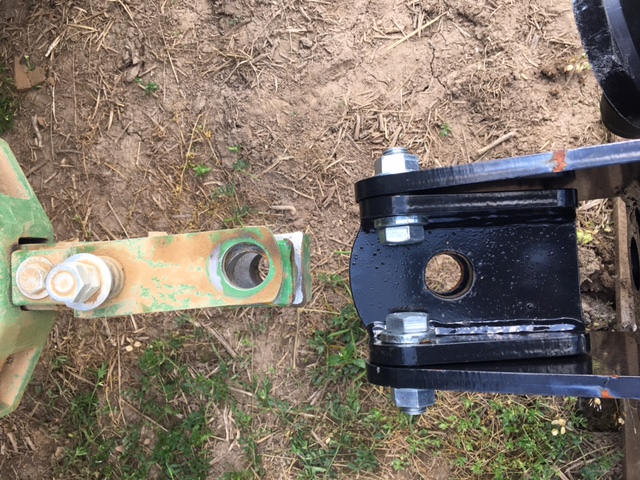

Here is the only pic I have thus far. During hookup... found out... hammer straps and Woods upgraded rotary hitch are not compatible. Was disappointed, to say the least. Now I have another connector to deal with...
You have a thing with draw bars! Most of my stuff doesn't go to plan so don't feel bad.
Brett
/ Batwing PTO angle max in a turn
I really think about just cutting off every hitch and making everything thing on the farm a pintle ring.
