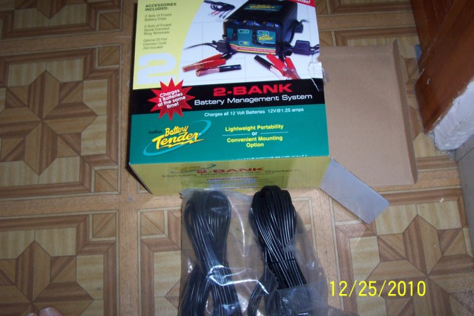

I just bought myself one for Christmas. I almost went with the Battery Tender Jr. but after doing some reading and researching, I went with the Battery Tender Plus due to the cold weather we have in Northern N.Y. I did buy a HF battery maintainer for $7.99 but after reading about some issues with over charging, I said why take the chance and never used it. I also bought 2 extra ends so I can use it on several vehicles. I just installed in on my JD Gator HPX diesel this afternoon. Tomorrow I will install one of the extra ends on my JD X595.

Any advice on a nice perminant install is wanted
ALAN
I use these year-round. I have each one of mine sitting on a shelf nearby, in no particular logic nor attached to anything other than gravity. So that leaves one to run the cord across the walkway right to the battery as the cord is only so long. I have purchased a 25' extension for each, running the cords overhead (where necessary) to eliminate a cord across my pathway. These things are fairly tough, and my garage gets as hot as the next guy's garage, I have never had an issue. As for the 110v last, it is to (theoritically) prevent an intermittent surge onto the babyboard (a microchip) that is inside the unit doing its job, or as the other poster said, it could prevent a spark. If I had a battery that was fuming and leaking as such, I'd get rid of it.
In my opionion, I'd mount it, hang it, or set it in an adjacent area, string an extension overhead if necessary or preferred, plug it in and leave it. I use the connectors that mount to the battery terminal and connect / disconnect as I come and go.
The only thing I have experienced as a failure with the BT is from lightening. I lost three in one strike and then another one a few months later to the same thing. BatteryMart replaced each one, no questions ask. I sent the fried unit back, they immediately sent me new ones.
The $7.99 gadget was not a maintainer. It was a cheap trickle charge that has no way of knowing when the battery is at full capacity, thus the over charge and detrimental condition of the life of the battery.
