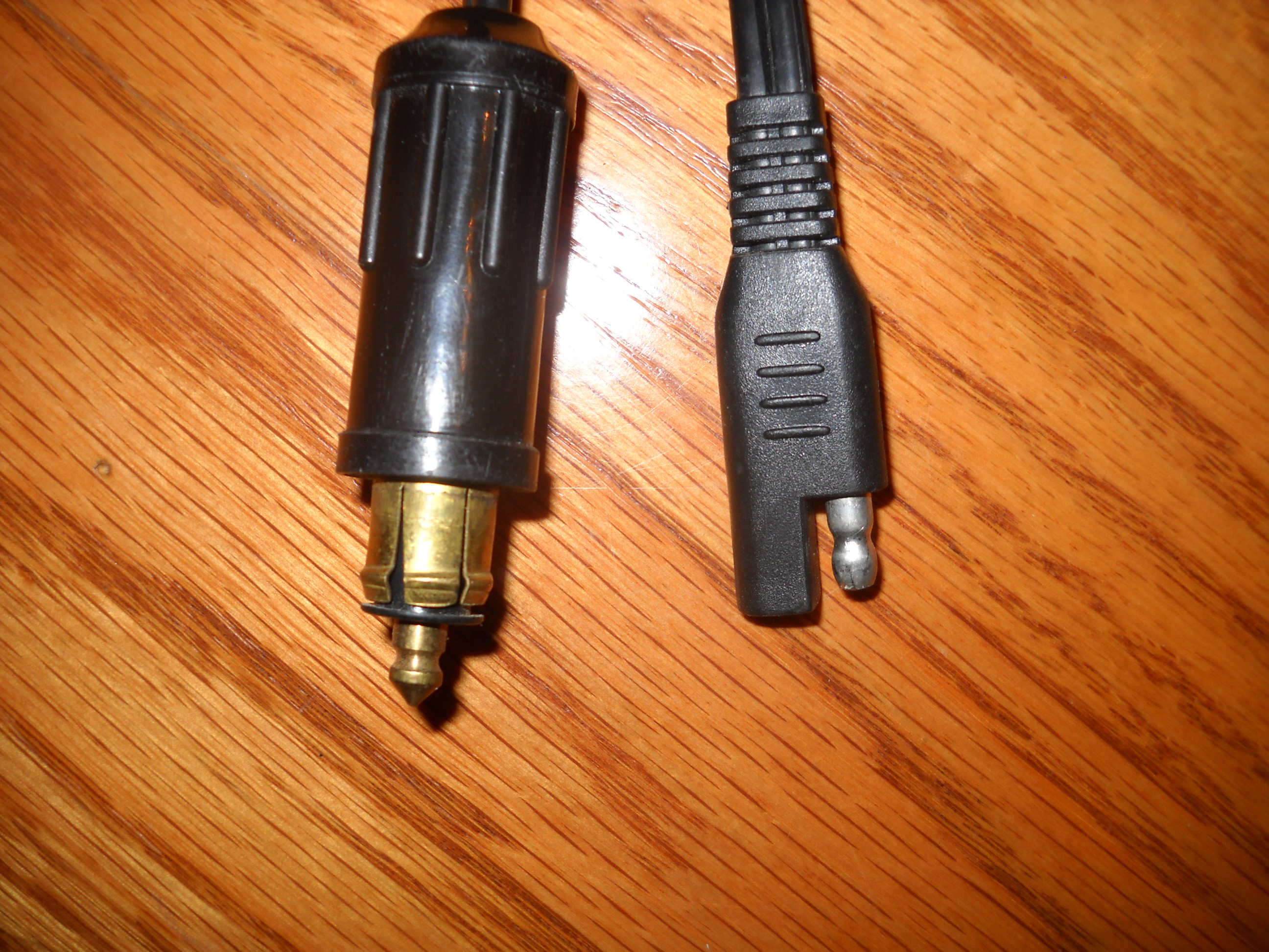

I use the SAE plug on the right. It's fairly universal and used with Battery Tender and BatteryMinder brands, so additional cords, pigtails, etc are easy to find. The SAE style is also used on many 12v accessories like pumps or sprayers. I'm not familiar with the one on the left, but I can see that it would be easy to use.
The round style plug is used on BMW motorcycles and some other applications. One of the advantages is that you can install a socket that accepts that plug and you don't need a loose pigtail then. I used one for a battery tender on an old motorcycle and it did double duty for a power source for heated gloves.
If I can find a spot on the dash of my tractor to install one of the those sockets, I'll likely go with that round style just for convenience.
You can get sockets for the SAE style too. Here's a good weather proof style Amazon.com: OptiMATE CABLE O-2, Weatherproof SAE socket, front panel mount: Automotive
Paul Short has a good video on it here Kubota BX25D Bulkhead Connector - YouTube

Yea, but if I use the round style I can use my heated motorcycle gloves on the tractor :thumbsup:
And besides, I already have most of the components needed for that setup.

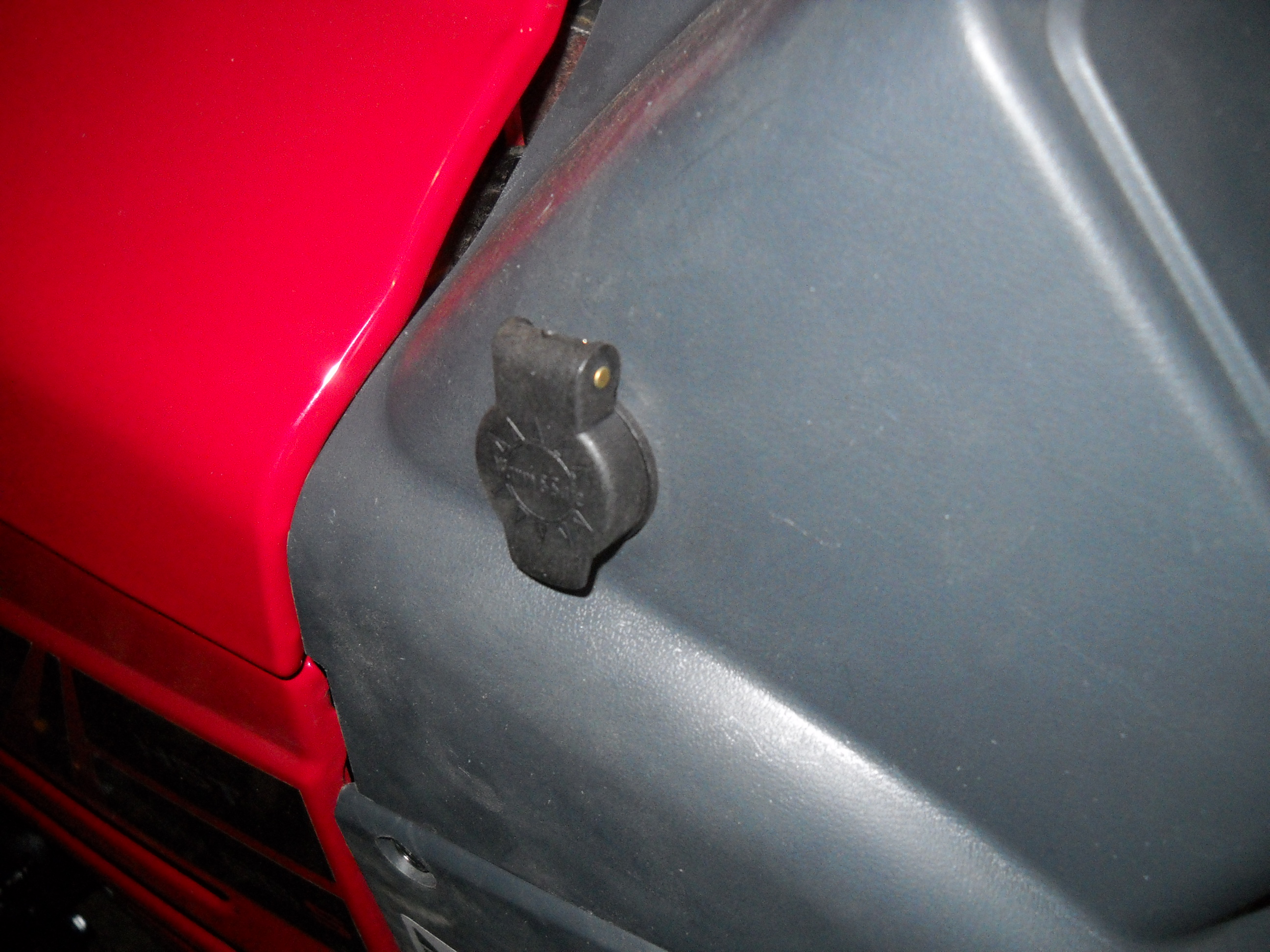

Just finished the install. Used the round style socket and mounted it on the left side of the instrument cluster. Worked out well.
Thanks to all for the info.

I thought about placing the connector in a rear facing position so that it would automatically un-couple if I drove off but that would have made the socket unusable for other functions. Instead I opted to place it where it was very obvious and the wire would be on the left side forcing me to climb over it if I neglected to unplug it first.
