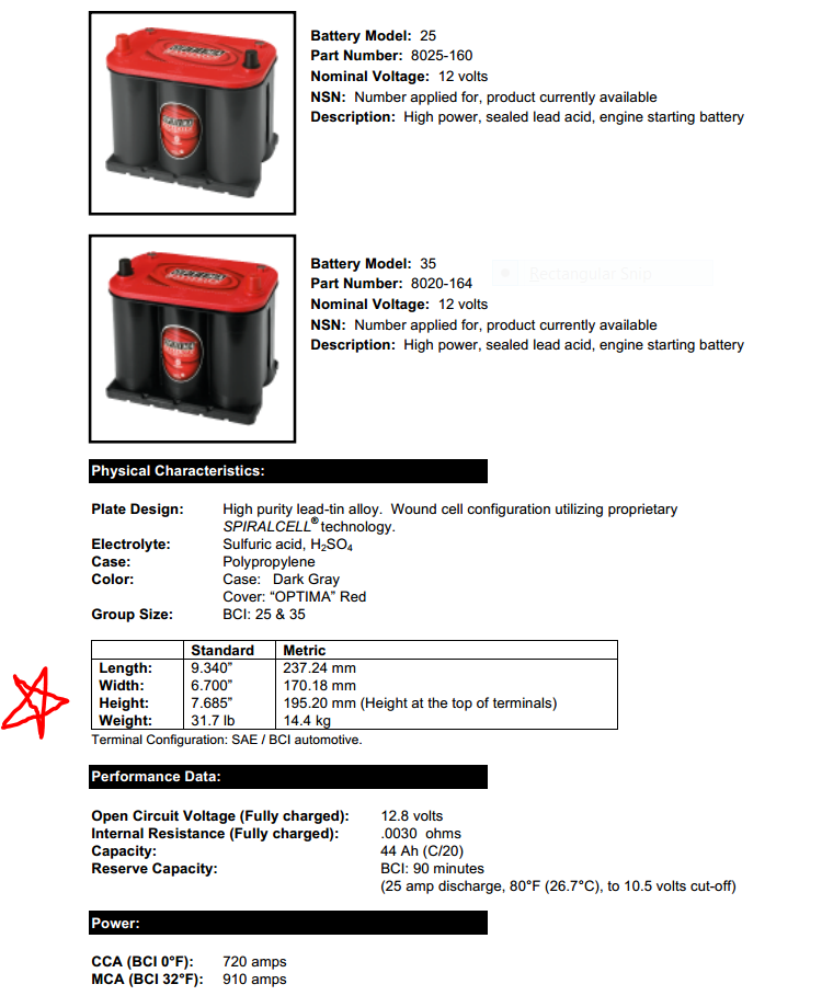

I won't use anything but Optima yellow top once an OEM battery gives up (and assuming one will fit). Repeat discharges and recharges doesn't seem to hurt them. Yes, I'm in Texas.

Interstate in everything I own. 4 Toyotas, 2 in my boat, 1 in my Kioti DK-40, 1 in each of my Dr. mowers, 1 in Suzuki ATV. I used to sell them when I owned my foreign auto shop. Run then, check level at split rings, fill only with distilled water, NEVER add electrolyte. Battery Tender if they go low or sit for long periods of time. Letting any battery get below 80% charge on a regular basis shortens the overall life of same.
/ Battery Suggestions Needed #24
Right. But with the Optima Yellow Top (or others designed for deep discharge duty) that eventuality is greatly reduced/postponed.
xtn
/ Battery Suggestions Needed #25
I've had good luck with a variety of battery's & I do put deep cycle battery's in all the heavy equipment that sits for a while most use 2 and I try and get the battery minder on them every 30 days or so for a few days. I've not used the Optima yet but may some day. Anything that gets ruff treatment or lots of bouncing around I'd recommend jell battery's especially in the smaller sizes for longevity.
/ Battery Suggestions Needed #26
xtn
Agreed; but at a premium price. I haven't succumbed to gel/mat batteries to date because lead acid works well if maintained properly.
My boat would be the perfect candidate, but so far two Interstate batteries cover the start and house duties no problems. I don't use deep cycle batteries because I have a BEP/VSR switch which reads both batteries state of charge and uses the engine's alternator to maintain the start and then the house battery's output voltage in that order. If for some reason I need both batteries to start the engine if one battery is in failure mode I can then manually switch both to work together to provide adequate voltage. Boats aren't like a car, or tractor. You can't get out or off a boat and walk home! And if you can, you don't need a battery anyway.
