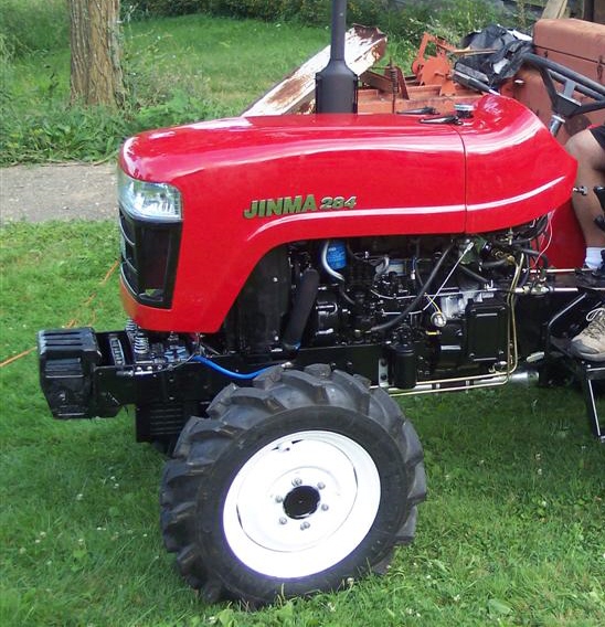

/ Battery recommended for JM284 #11
Here is a pic. Not my tractor but just like mine minus the FEL. Anyway here is where the battery is located.
Chris
