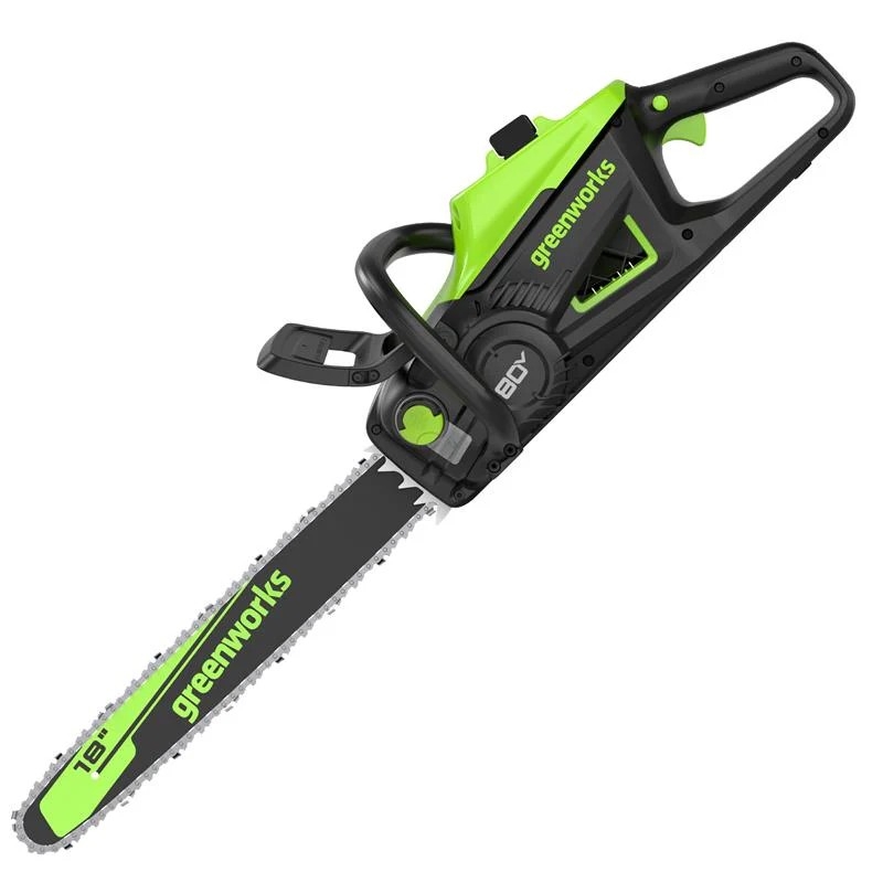

I have the 60 volt Greenworks saw with a 20 inch bar and it is heavy but I find the battery life to be fairly good.. I have used it cutting a 18 inch hickory log and have got 17 cuts and still have 2 bars left using it without any long breaks. I agree it will not last as long as a 60 cc gas saw but at 82 years old I cannot go as long as I used to and it is sure easy to start, and I have lots of 8 ah batteries to use on it.

I am willing to bet he had the early 80v homeowner saw. Comes with shorter bars 18" to 24" I think
Not the latest 82v that is considered the commercial saw. The commercial one only been out a short time.
This is the lesser 80v version that dont really cost all that much compared to the 82V version out.

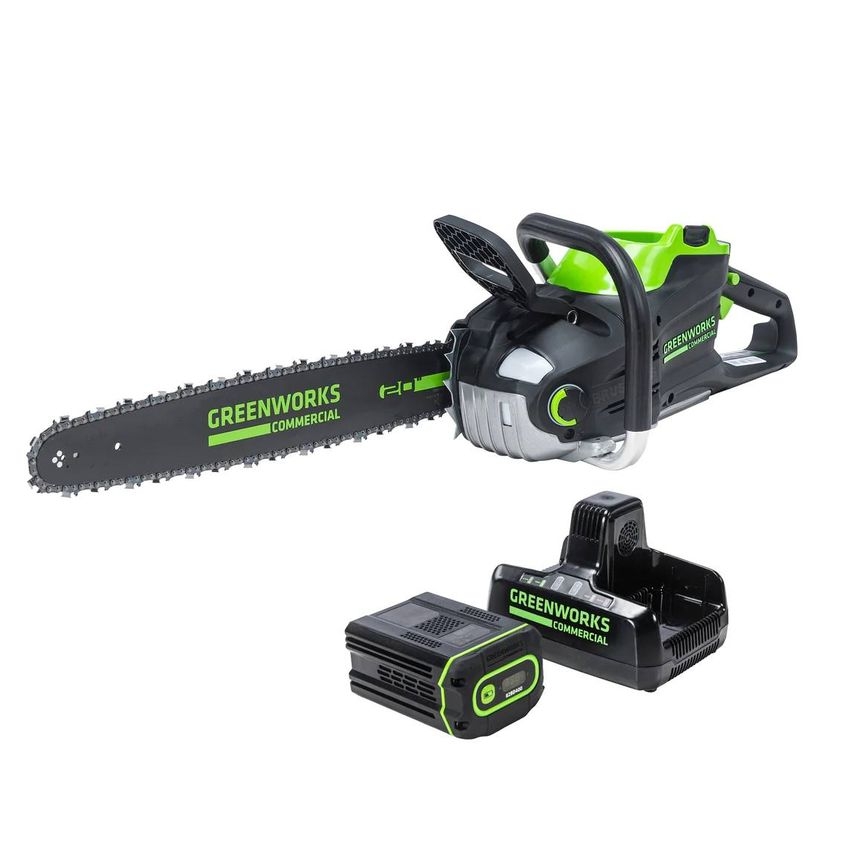

/ Battery powered chainsaw #1,164
This one I dont even see on their website yet. But swear seen it earlier this year.
It is 82V the new commercial version

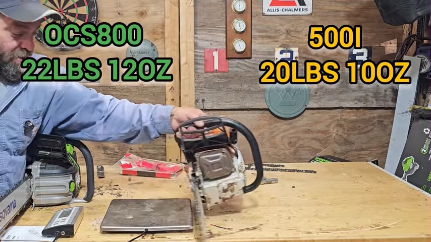

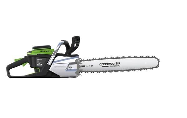

/ Battery powered chainsaw #1,166
Commercial 82V one.
Both weights full 24" set ups.
Weights are close as used to the super light 79cc 500i.
View attachment 4036128View attachment 4036129
It's on there for $600. The battery alone is $250-$300.
My issue was run time, weight, and that the battery lasted 12 months, and the cost of replacement was exorbitant. Mine was the 80V, the 82V wasn’t available two years ago.
Any of those three are deal killers for me.
If I go into the woods to cut, it’s not accessible by truck, and there is a serious lack of 120v outlets. So what do I carry in? A gallon of fuel, or one battery? Both weigh the same… what one lasts longer?
There is also this wide chasm. A CS400 weighs in at 10lbs without the bar. The homeowner battery saws won’t come close to outrunning that saw. The next option is the 82v GreenWorks, which is much more expensive, heavier, and limits your run time. And pray to God that you don’t have to replace a battery for 3-5 years.
It’s like the battery saws are too small and limited to compete with a homeowner gasser… or too large and expensive to do so on the other end.
I love throwing on chaps and taking the ATV to the woods where a gallon of fuel will last me all day. That’s just me.
/ Battery powered chainsaw #1,170
I figured yours was the 80V. Not suppose to be even close to this new technology one on reading. No clue as I wont ever go there to see. But man that video is surprising.
The commercial 82V one like in video only been out a short time.
