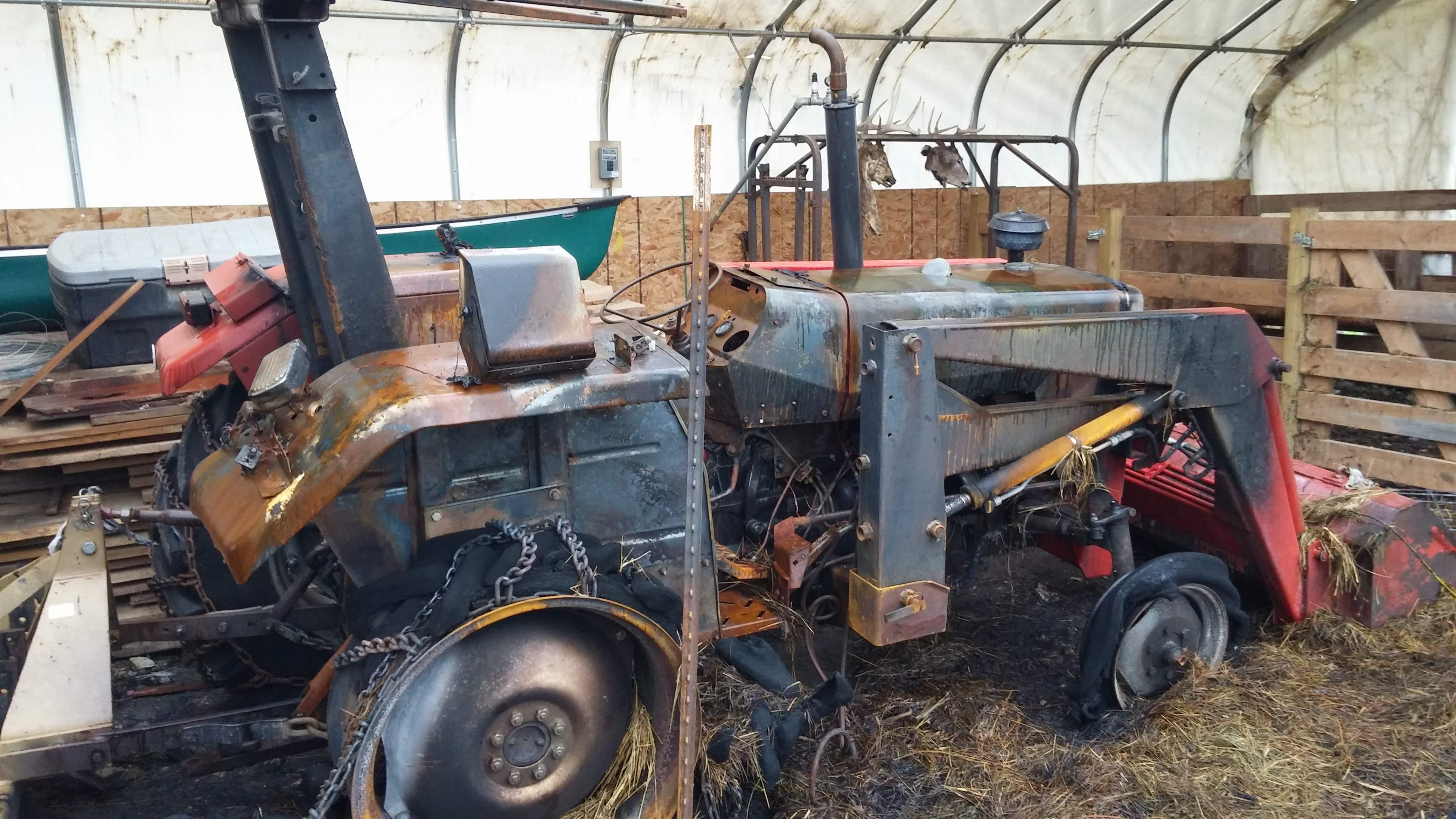

Hello,
I don't get a chance to get on this forum much but recently had an incident that I thought I should share with you folks. I have been using battery maintainers for years. I have never had an issue with them but from here on out I am going to be very cautious with them. Any time you have something electrical plugged in, bad things can happen. I have attached a picture of what happened to my tractor. Thank goodness nobody got hurt and the tractor was insured.
From all indications this fire was started by the battery shorting out or the maintainer catching on fire. The battery was located in a compartment just ahead of the steering wheel. It is a molten glob now. If the fire had started somewhere else I do not think the battery would have been affected like this. The guys at the fire department thought the same thing although there was not an official investigation.
The fire also took out about 50 bales of hay and a couple of spreaders and other various pieces of yard equipment. Just be careful with these things and all battery chargers as far as that goes. If you have portable, battery powered tools I have read where they can also catch on fire. Just don't leave them plugged in when you are not using them.

Thanks for posting Kevin, that is a good reminder for all. You lost some equipment, but obviously this could have been much worse.
Any decently designed charger should have fusing or equivalent to isolate it from faults. My Ctek 3300 came with an external inline blade fuse, up by the positive clip - effective and easy/cheap to replace if it blows. Not promoting Ctek specifically, moreso that it's easy enough to add your own inline fuse to any charger. I know from Canadian sources that the counterfeiting that jmc is talking about is widespread, including on high-voltage cable.
While a bit rare, batteries can fault on their own. Always good practice to make sure battery terminals are clean and tight, and that individual cells are topped up to the proper level - good as routine maintenance, and esp. at the end of the season.
Not suggesting there was anything lacking for maintenance on your end Kevin, just wanted to drop those general points into a Safety thread.
You might want to check with Northern if there were any recalls on their chargers.

Agreed, could very well have been a shorted out battery. I had one on the charger just last week inside my shop. It kept taking a charge and the charge kept increasing. By the next day the charger meter was pegged! Apparently had a short in it. Very glad that one didn't catch on fire!
Kevin

I find that some of the newer microprocessor controlled battery chargers can sometimes be too quick to condemn a battery - the upside of that watchfulness is that they may have assessed a battery like you describe as faulty, early on.
Maintaining a whole pile of equipment, and dealing with whatever else comes up in life, it can be easy to forget a battery on charge. Big commercial chargers often have shut-off timers built-in..... the points raised in this thread can be used to make a case for using an appliance timer on smaller chargers.....

This is why I keep trying to warn people about the huge amount of energy stored in a lead acid battery. There should be a very low amperage fuse right at the battery clamp, just enough to allow the maintainer to do it's thing. Otherwise if you have a semiconductor failure in the device, you now have a thousand amps going through that typical low gauge, cheap thermoplastic insulated wire!
I have friends in the business of battery powered systems for utility vehicles and trucks. Every now and then some brand new service vehicle or million dollar bucket truck gets burned down to the water line on account of some failure in the DC wiring connected to all those huge batteries!!
