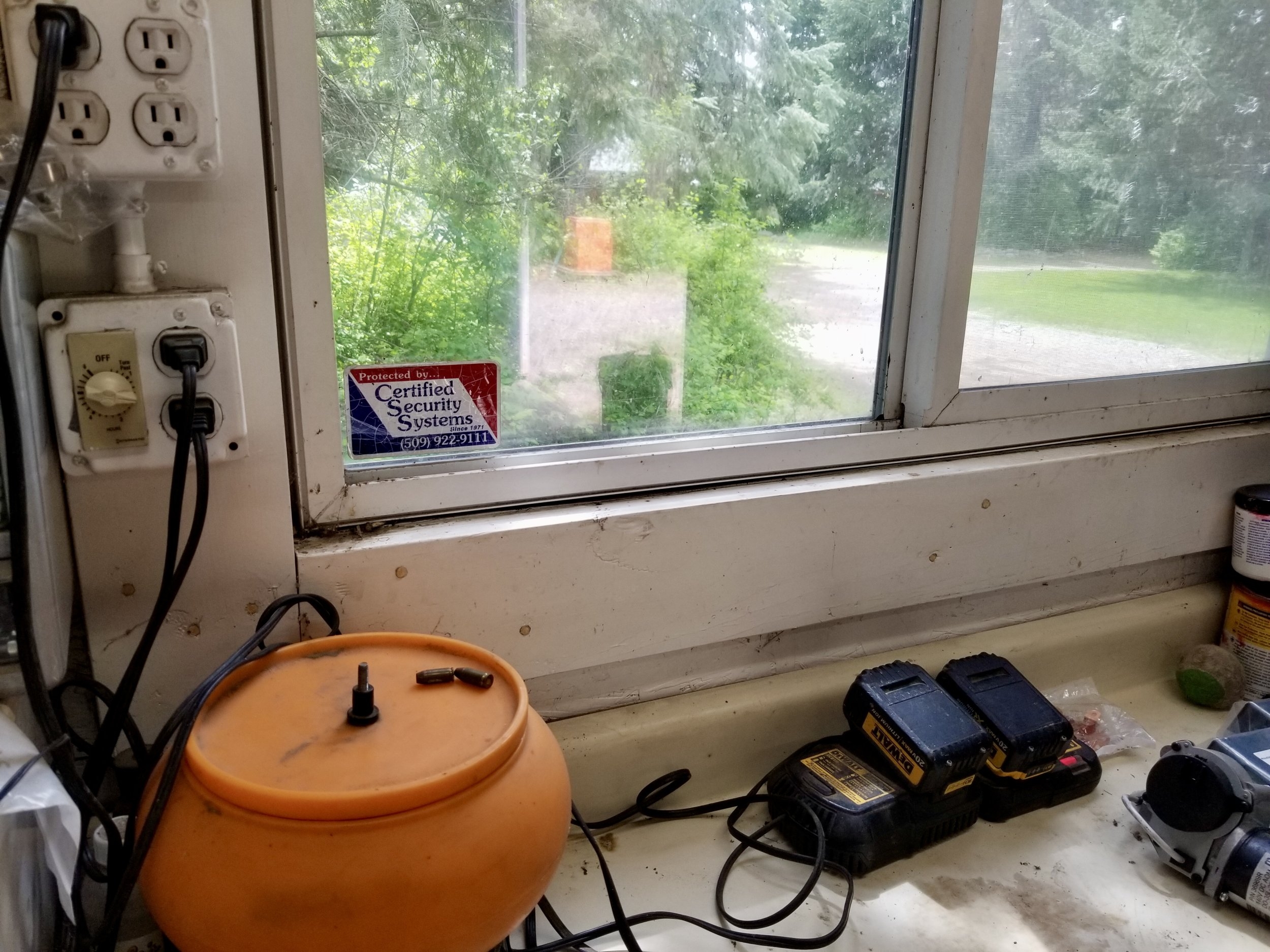

This is why I've gotten out of the habit of leaving my batteries on charge. Last month I had a 6aH battery and charger overheat.

Eventually I'll have a fire proof small battery charging station. It could still make smoke, but hopefully won't spread.

My chargers are on a twist timer.

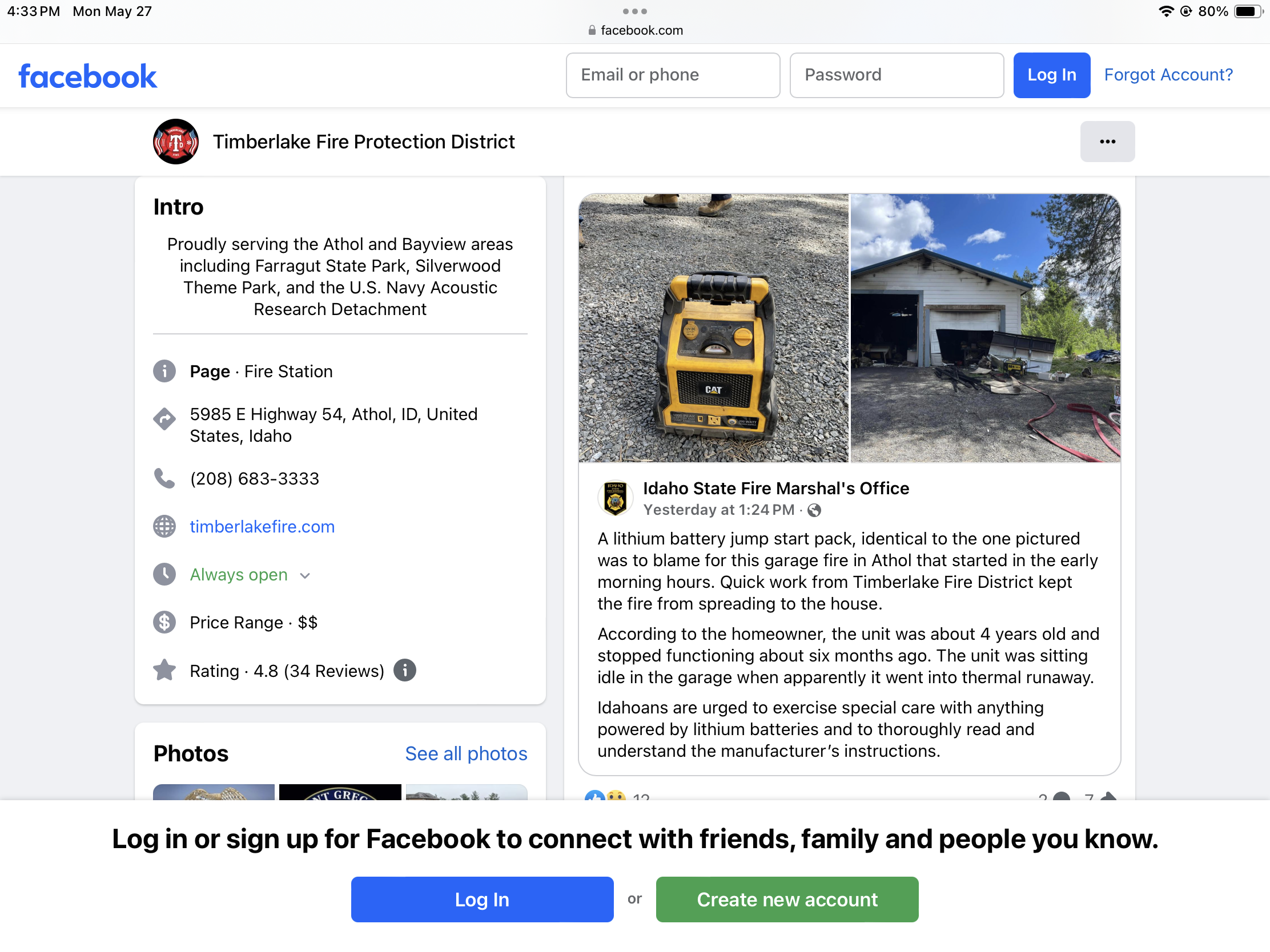

a house in our town had a CAT branded lithium auto jump start unit catch fire yesterday. Burnt down his garage. Fire dept kept fire out of house itself…some smoke damage though. I think this thing is the same ones being sold thru Costco a few years back…..i was looking at it. He must have left it plugged in?IMG_6941.png
/ Anorher lithium battery fire #19
a house in our town had a CAT branded lithium auto jump start unit catch fire yesterday. Burnt down his garage.... He must have left it plugged in?
According to the clip with the video, it was dead at the time, so why should it have been left plugged in? Internal short in a battery?
"UL Listing" should work on bomb proof BMS (battery management system) controllers to prevent charge time failures in consumer electronics. And, of course, also extend the battery life.
Then, once a battery pack has reached a failure state, it needs to either be repaired, or go to recycling.
/ Anorher lithium battery fire #20
Maybe the best thing would be to have a small "shed" for charging separate from the house, garage, barn or shop made of a non combustible material.
