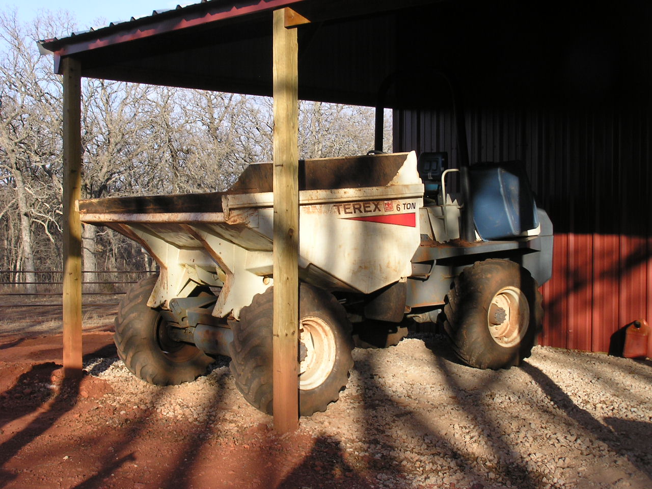

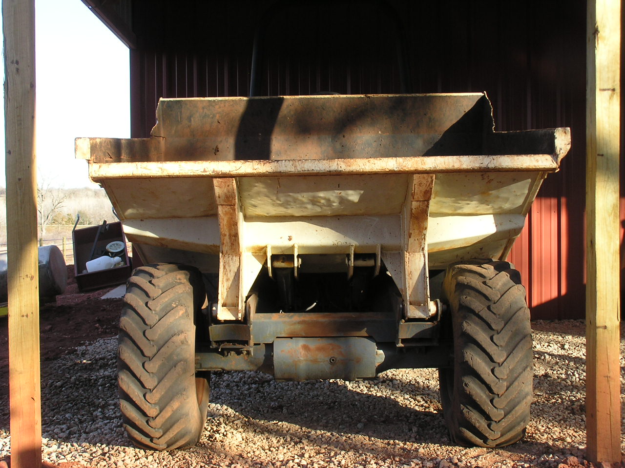

/ Batteries for my Dozer #24
That's a great looking dumper!!!! I can see where it would be very handy getting to hard to reach areas!!!!
Eddie
Thanks. Yep it is very handy. Perkins diesel, 4 speed and 4 wheel drive.
