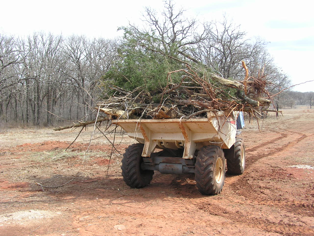

I recommend AGM (Absorbed Glass Mat) batteries. Vibration resistant, no corrosion and never have to check or add water.
This old Dumper sets for months at a time and it fires right up. It has an Optima that is eight years old.
