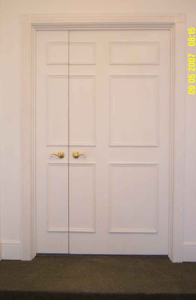

Well, I don't often get a chance to disagree with you Eddie so I didn't want to let this rare opportunity slip away.
I have a 4-0 French door. It is not identical twins but is fraternal twins. One side (the typically used door) is 3-0 and the "fixed" side is 1-0. This door is at the end of our upstairs hall and leads into the second floor of the attached shop (free span metal bld , red iron, I beam columns, horizontal 2x8 on 24 inch centers.) I wanted larger than 3-0 to get stuff into and out of the shop but I also wanted a swinging 3-0 for normal use.
The door handles in this instance are dummies. The doors have the recessed ball bearings on top that engage "striker plates" in the top of the door frame. This facilitates coming up to the doors carrying something and opening either or both doors with your backside as there is no cane bolt or need to twist a handle.
The doors are dead plain veneered solid core onto which I added some trim. I did the trim as if it were identical twins. I didn't use an astragal so uneven sizes are a bit less noticeable but the crack between the doors is a dead giveaway.

"The doors have the recessed ball bearings on top that engage "striker plates" in the top of the door frame. "
I really like this idea and will look for doors with this feature, the way the area is set up it doesn't need a security latch. My plan is an inexpensive door from the local lumberyard, so won't have the option of a custom door maker.
