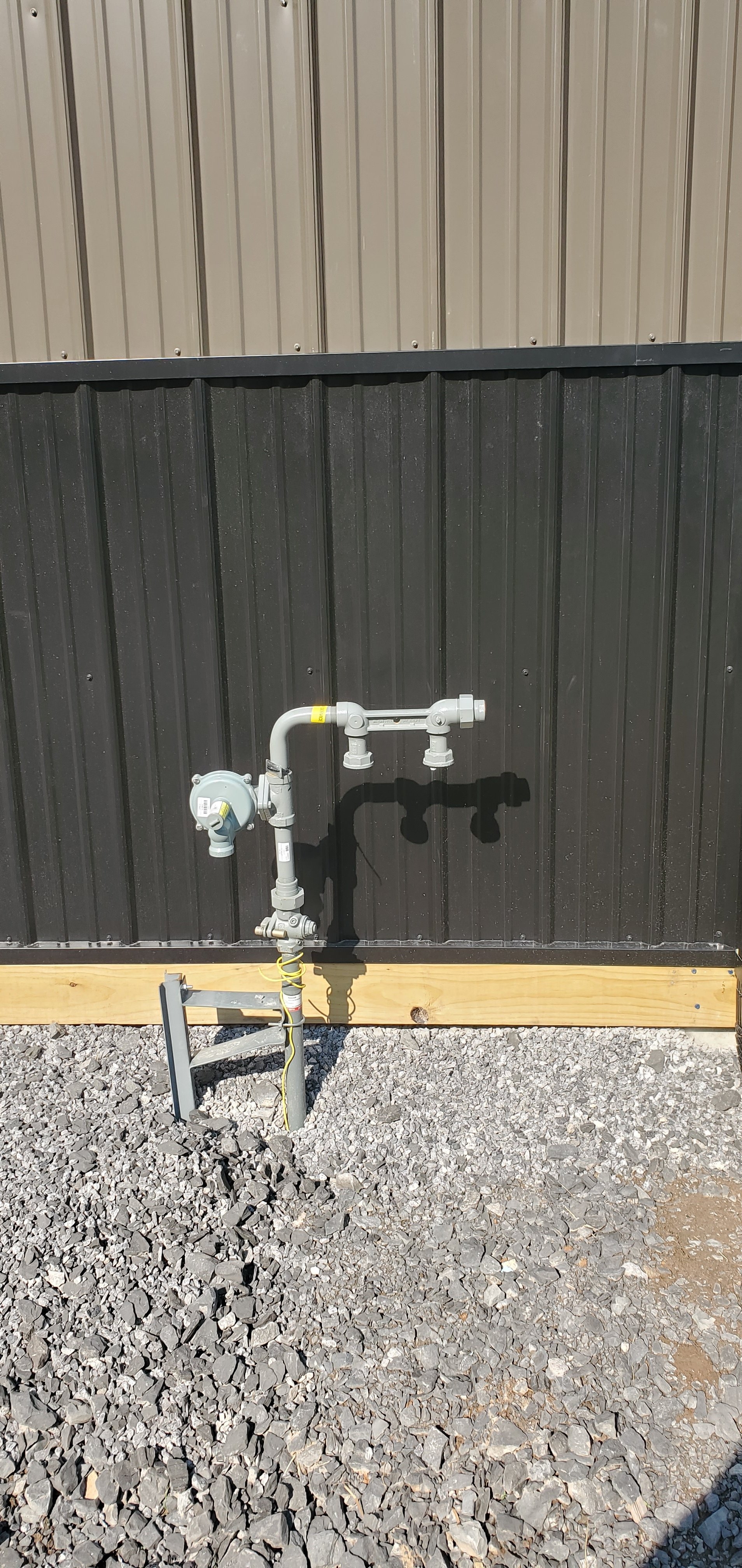

Yes. I have natural gas to a riser up to the building. But they won't install a meter until I have a permenant gas appliance installed, as well as a pressure check of the internal gas piping, which is done by a licensed plumber. So I plan to put in a natural gas range/oven even if I have no walls etc. It's going in an island in the kitchen.
If I don't get that done soon the new law states that partial gas installations are subject to the new rules so I would lose all that I spent on the NG installation so far, which is about $6000.
So before I go out and buy all the stuff for a NG boiler the big push is to get the concrete in, then the gas piping in the building, electrical main panel then go by a NG range/ oven and get that installed so I can call to get a gas meter hooked up.

That's kind of scary. I would be in a bit of a panic to get that done. Hoping it works for you. You should have plenty of time, but things have a way of happening when you have a deadline!!!!

It's not fun. It's a bad law causing a lot of grief.
