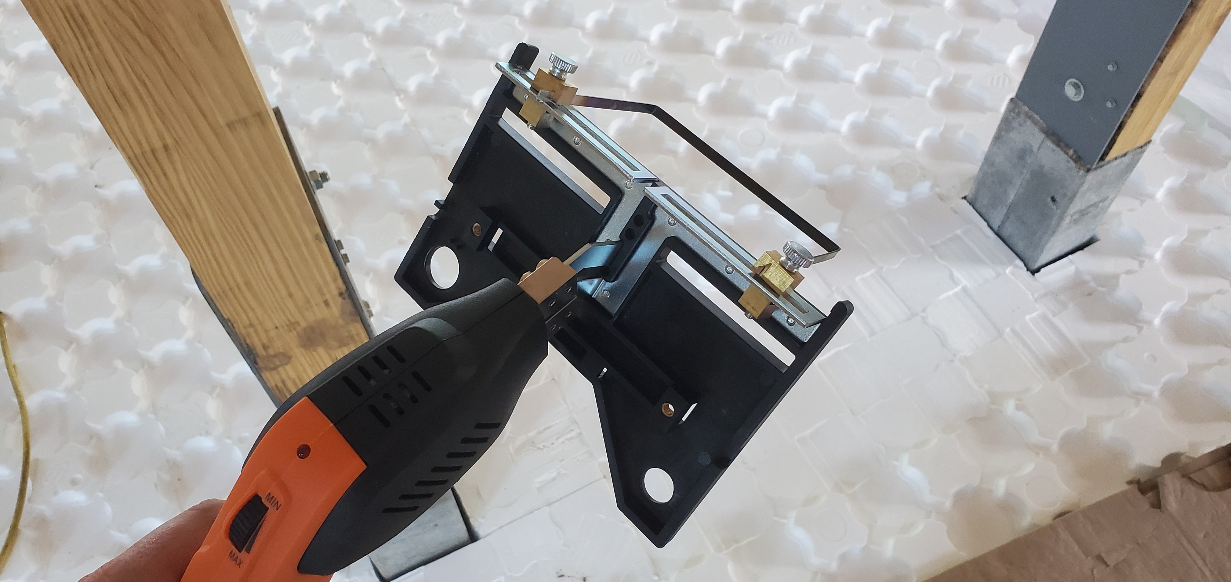

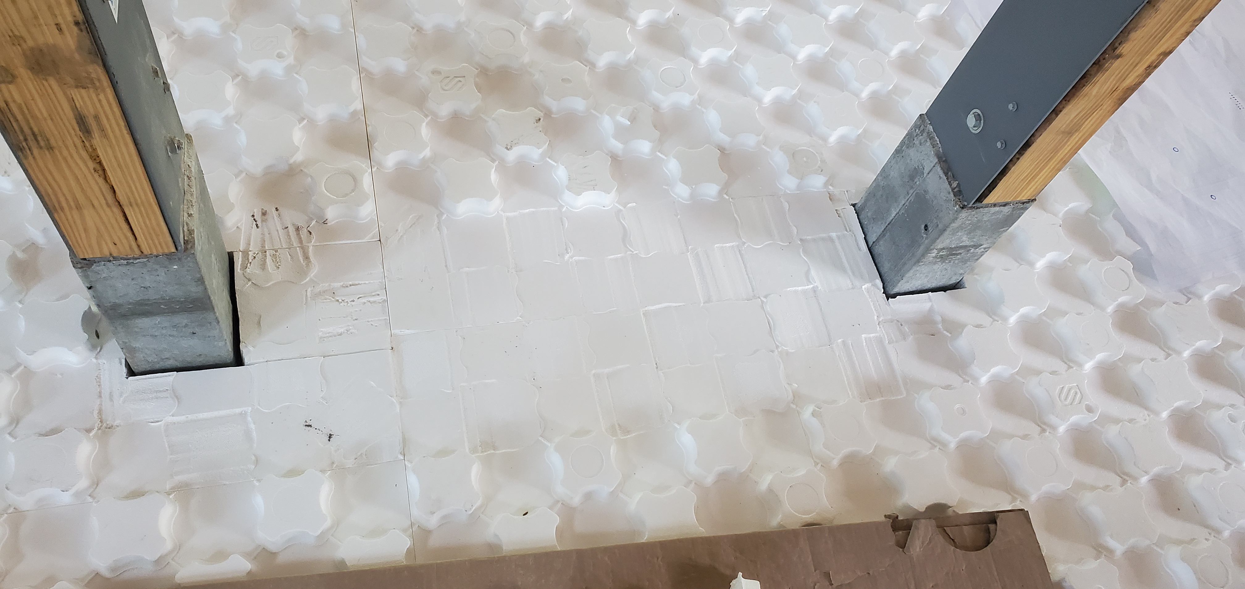

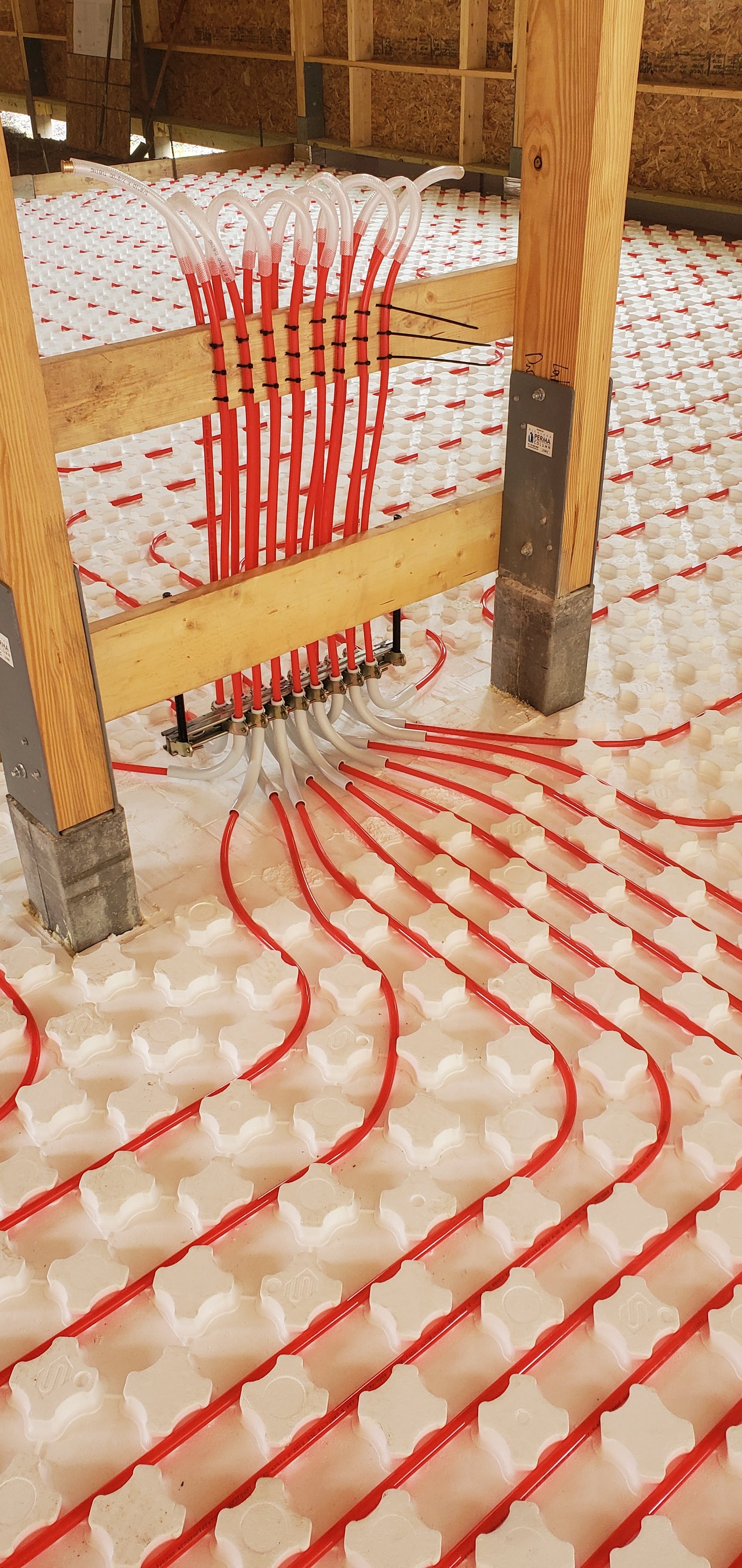

I'm ready to start running my pex:
Used one of those foam heat knives to take off some nubs where the manifold will be located.
   / Barndominium/Shop or "real" House? #578
Do you weave the PEX through the bumps on the foam?
#579
Most of the videos I watched guys were stepping on the pex to force between the nubs. At first I did this but it was causing the edges of the styrofoam to break off. I soon found a method which worked way better. I would keep an arc in the pex so it generated downward pressure via a spring force while very slightly weaving the tube back and forth. You only have to move about 1/8 inch back and forth.
This worked much better. It simultaneously fully seated the pex and there was no damage to the foam. Also no need to go back over to make sure the pex is fully seated.
One bad thing about this methid is you have to be closer to the foam so have to bend over quite far. After each loop my lower back was on fire.
   / Barndominium/Shop or "real" House? #580
Looks really good - nice, clean installation!
