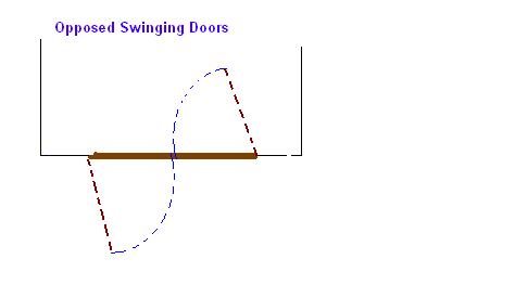

This is admittedly an unusual design, but have you considered doors where the right door swings in and the left door swings out? If you beveled the center edges of the doors slightly they'd "mate" nicely. Perhaps with a spring bolt to secure them at the top, you'd have one door as the "active" door, and the other would be passive, but usuable when you released the bolt. Something along the lines of the bolts on this site

Actually dave, from an explicit architectural view, the old section of this barn is a combination of a typical english barn and a dutch bank barn. Bank barns were always built into a grade. In my case, the bank is not severe enough to afford access to the 2nd story. That's why I consider it to be more of an english design.
In my case, I have lottsa wet spots near the barn itself, but the entire barn stays remarkably dry, grade notwithstanding. A good 19th century slate tile roof helps too.
As bebster posted, I'm also considering the idea of swing doors that open in opposing directions. This would reduce the weight and stresses on the hardware. Hanging doors in this configuration may require modifying or scratch building a new jamb, though.
Hmmm...
Lastly, what materials would be recommended. I don't wanna be repairing this door anytime soon but can't break the bank either. Pressure treated? Bead Board?, Flake Board? I'll prolly cross-buck it for aesthetics. I'm hopin I can obtain materials and hardware for under 350$ Been a while since I made a trip to the lumber yard.
/ Barn Door Project: Need Ideas #23
I'd consider using cedar on the exterior of the door. It weathers well and would look better than pressure-treated wood. Also I think it is lighter. If you do the opposing doors, you'll might construct an inside frame for the door that is the same width as the door so that the hinges can be screwed to that frame on opposite sides.
