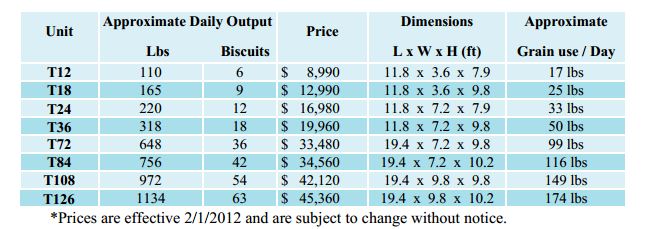

I did a little investigation on Fodder Solutions. It takes several $$$$$$$ to get set up depending on how many animal units one wants to feed a day. So one better like the "SOLUTION"
Thank you for posting the prices from the brochure. http://www.foddersolutions.net/brochure/Fodder Sales Information 2012.pdf
For anyone interested, those prices have not changed. We have however introduced several new systems. There is one smaller priced at $4,950. There are also larger systems available (capable of producing several tons per day.) An estimated ROI can be calculated using the tool here: ROI
With any investment you should know ahead of time how it will pay off.
AKfish - Thank you for your comments. You're absolutely correct that dry roughage is an important part of the diet. We never recommend feeding 100% fodder to a horse. At a bare minimum, we recommend feeding at least 1% of a horse's body weight as dry roughage.
How many horses will the $8990 system plus material such as seed,water & electricity feed a day? I know it's a 6 biscuit system but how many biscuits are required per horse per day??

The average horse will eat 1 biscuit per day, along with some roughage. That system will feed 6 horses.
