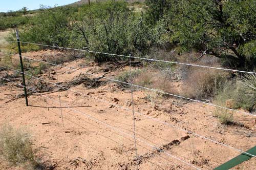

If you are going to have calves or small cows you will need stays. If you do not they will put their head beween the wire and just walk thru it. The stays are the upright wires in this picture.

</font><font color="blue" class="small">( you will need stays )</font>
Yeah, and ask someone to show you how to easily put them on and/or take them off, or else you can learn the hard way like I did. /forums/images/graemlins/crazy.gif

Byrd, I've had several small calves go thru my 5 strand barb fence. This is especially problematic with new borns. I've never used the stays but I'm interested. Is the instructions for installing them something that you can explain here or does it require "show and tell"? Thanks.
TK
/ Barbed wire fence #40
The stays come in diferent lenghts. You install them like you would use a corkscrew on a wine bottle. Just to make it easier for me I gave them a lite coat of WD-40 first and they were almost self guiding.
