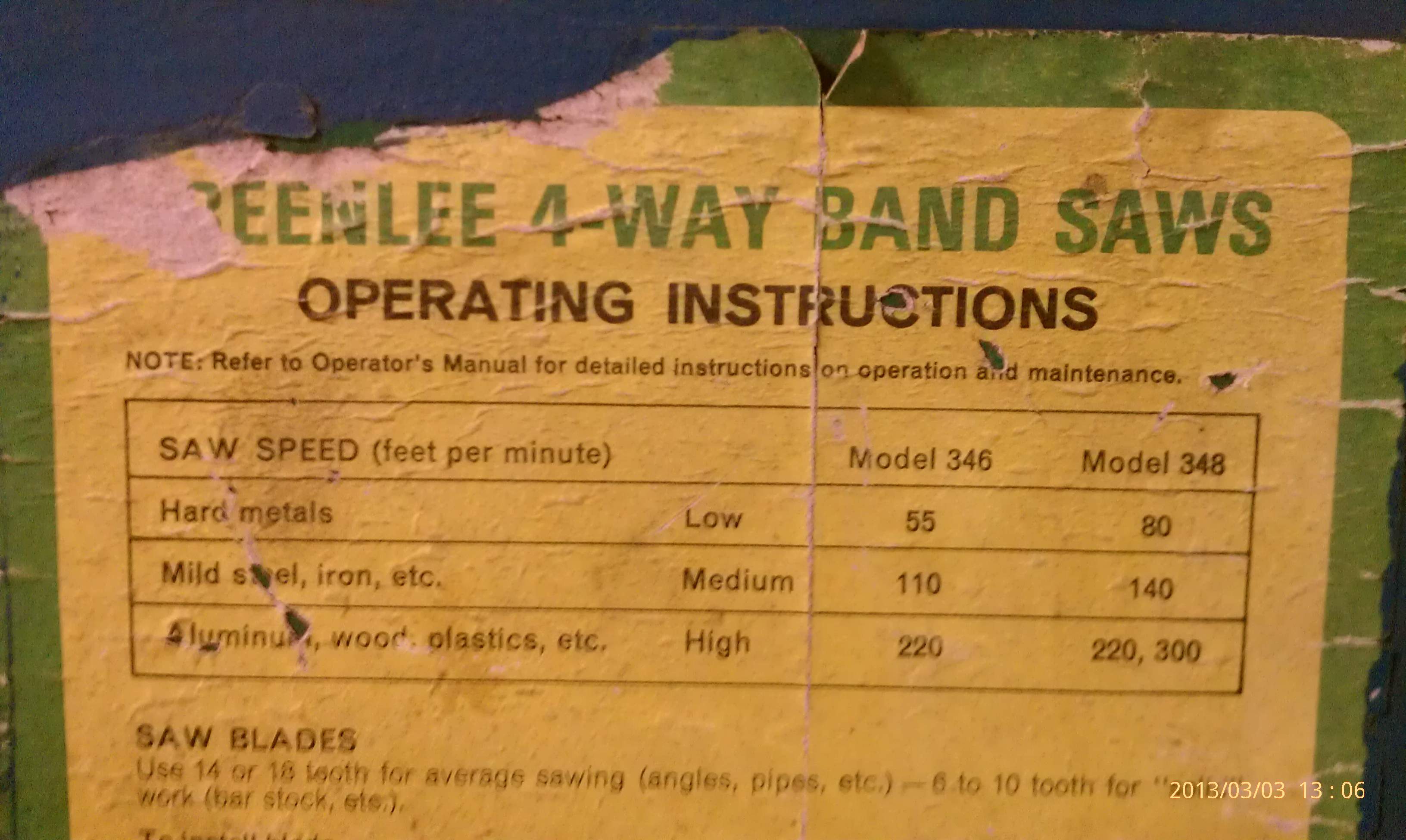

I picked up a old (1985) Greenlee model 348 (which looks like this Telmac, i think greenlee actually bought them out years ago) at a local auction for $200. Cleaned it up and found some blades online and checked it for square and I'm set. It's a dry saw with 1hp and four speeds. The blade can be tilted left to 15, 22.5 30, and 45 deg. And you can pivot the fence to any angle you want so you can do compound cuts.
This is my saw below. Same saw just viewed from the other side.
So for,less than $300 I have a metal cutting bandsaw that will cut up to 8" pipe. Might not be new and shiney but it works just fine and for the amount of use I will give it it will go another 25 years I think which will be more than I need.
You can also disconnect the hydraulic ram which controls the cut speed and stand it up and with the opitonal table have a vertical saw (of sorts).
I'm looking for a copy of the operators manual if anyone has one. I have an active search on eBay but no hits so far.
