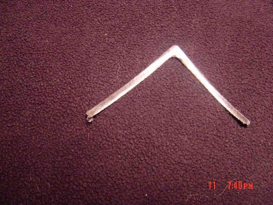

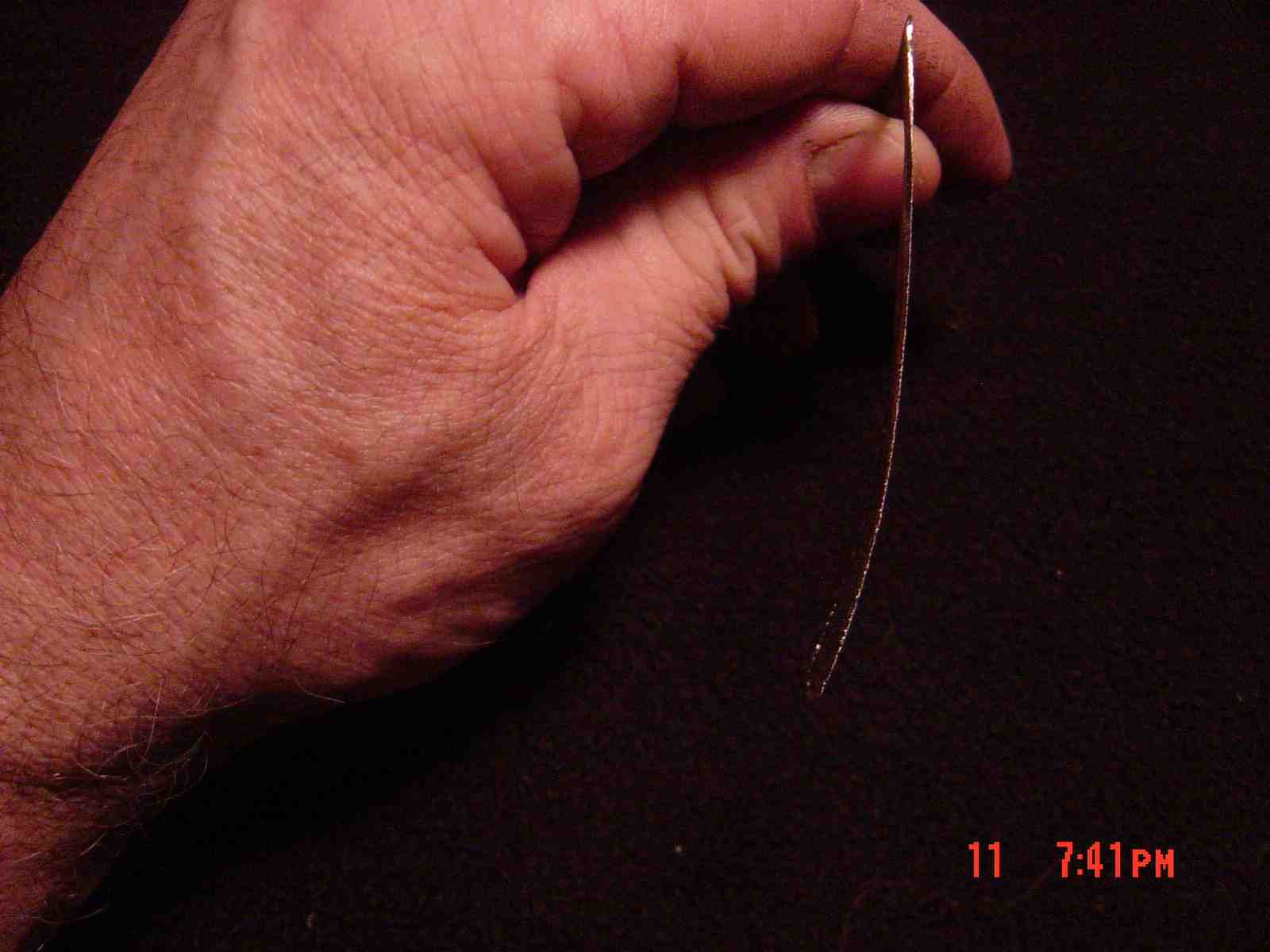

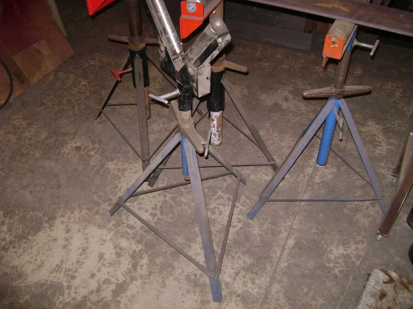

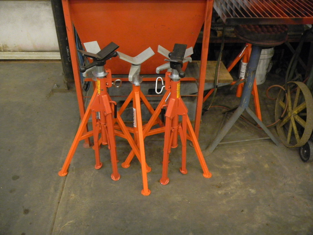

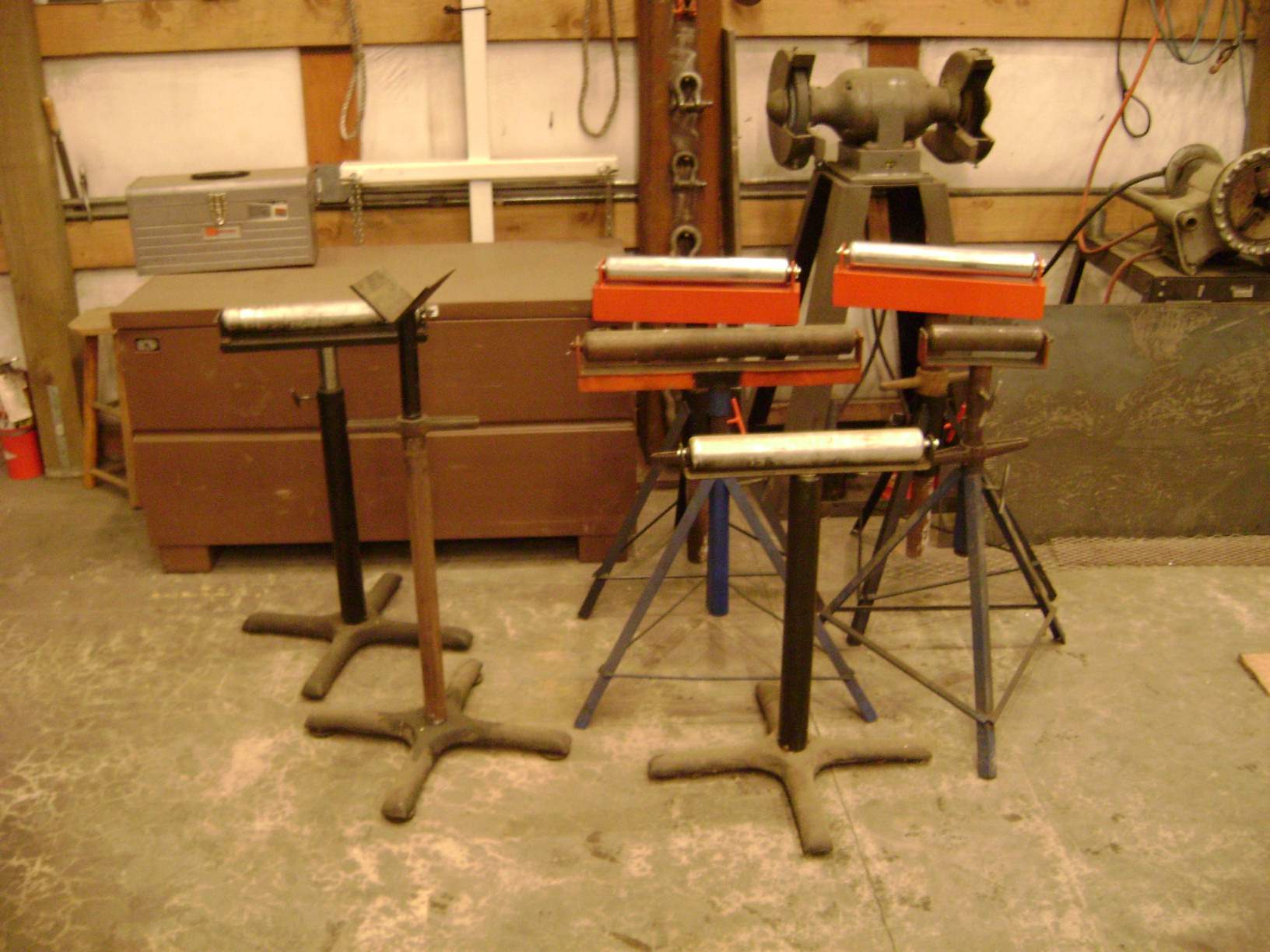

I don't know your budget but I saw a saw last week that will cut just about anything. It had a 2 1/2" blade and 43.3" capacity.:shocked: It was brand new but I didn't ask the price. :eek: A swivel head saw is great feature to have. If you have roller stands or even just saw horses to hold long lengths, you don't have to move your feed table when you do angle cuts. The swivel head also has the degrees marked for more accurate cuts and odd angles.
/ Bandsaws---what type? #9
Roller stands are only the start, you also need one of these.:D

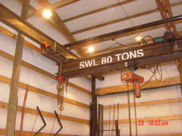

/ Bandsaws---what type? #15
80 tons SA? Just what the heck are you fabricating over there?
That was two spreader bars for setting precast concrete utility vaults for the Pier D aircraft carrier pier at PSNS. I had to cut and splice that beam so I could keep the decals in place. That crane is engineered for only 2-tons max.

/ Bandsaws---what type? #18
I somewhat figured, didn't look quite up to 80ton capability but I have to say you have all the cool toys!
