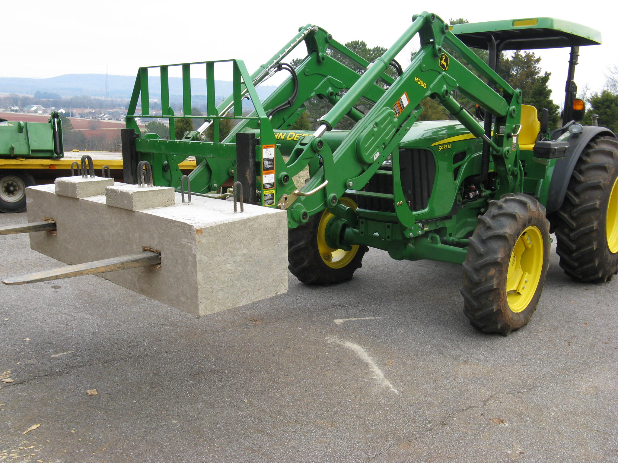

/ Ballast Photos #62
Ballast 020.jpgBallast 011.jpgBallast 013.jpgBallast 014.jpgBallast 015.jpgBallast 016.jpgBallast 017.jpgBallast 018.jpgBallast 019.jpg
Finished except for a little paint to keep the rebar from rusting. The fork slot forms are giving me some trouble to get out, but I allowed for that and made sure the forks would fit the slot even if the forms were in there and had to come out slowly. I am very pleased with it and look forward to using it tomorrow.
SPECS: 20"X15.5"X71.25" - 21 & 1/2 bags of 80lb Quikrete - 60 lbs of rewire & rebar. Approximate weight 1750lbs.

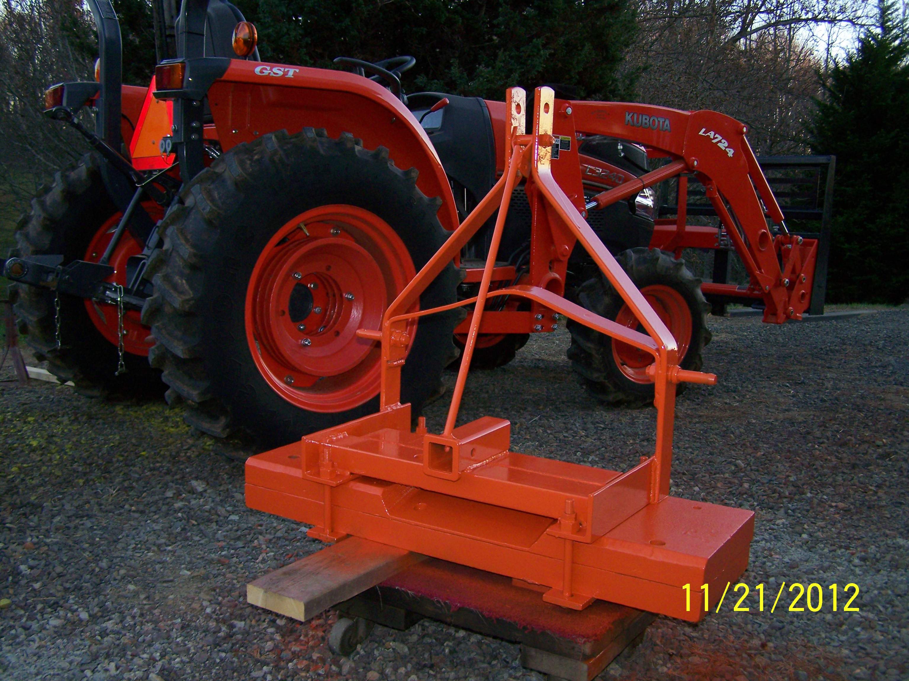

/ Ballast Photos #67

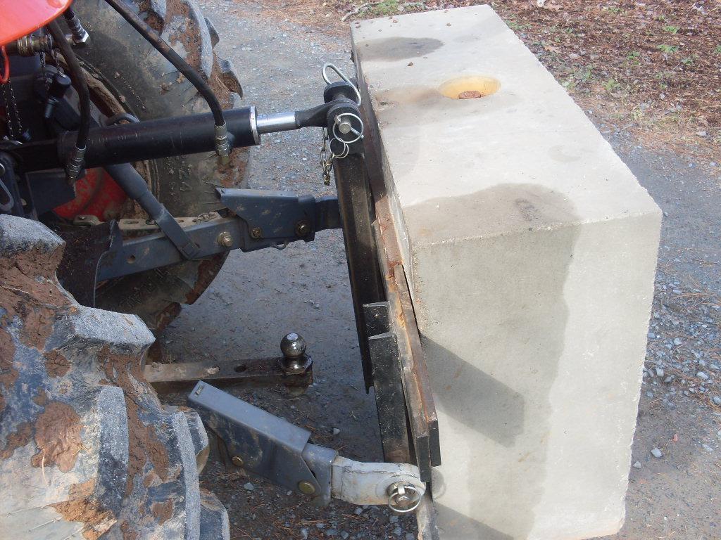

Right now it's around 800# if I remember correctly.
I intend on adding on a few hundred pounds.
/ Ballast Photos #68
Those are rough numbers. It is actually 20.75" x 20.75" x 41.75" = 10.4 cubic feet. Redi-mixed concrete should be between 142# - 144# per cubic foot. I am forming it with treated deck boards and will not be taking the forms off.
/ Ballast Photos #70
Wow. I suppose I had not had enough coffee this morning. I missed a digit somewhere. I though I multiplied and divided by 1728, but I am old and it was early. I was wondering why only 5 inch in on plane was offsetting 30 in another... :) Never listen to me before noon.
