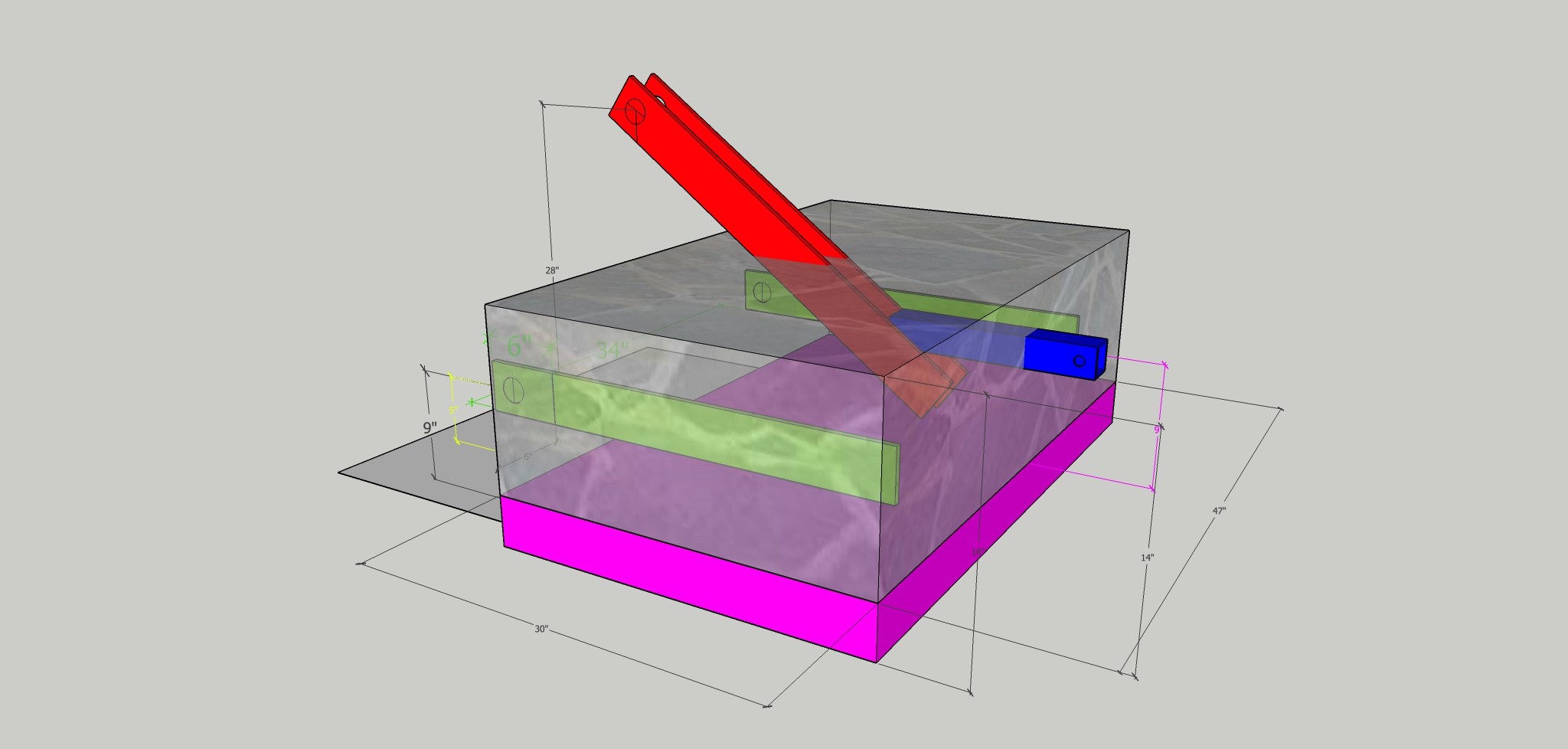

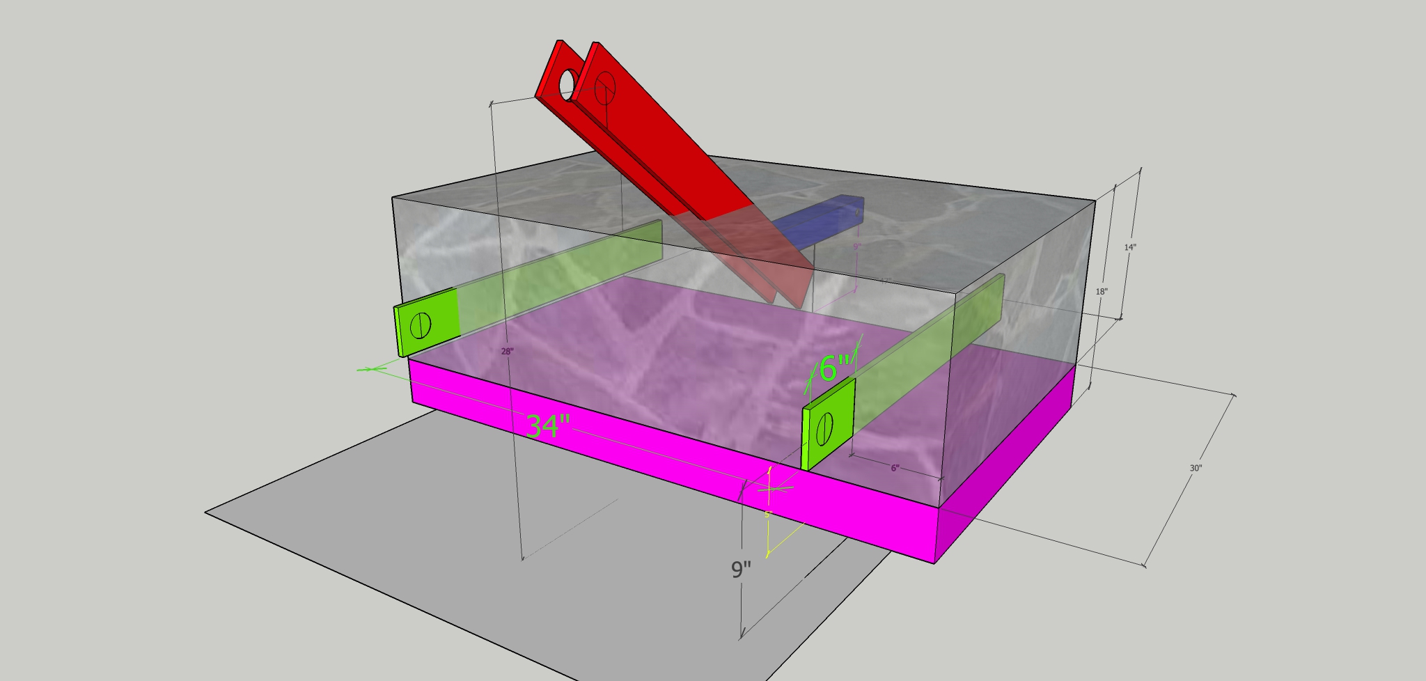

There have been some fantastic responses - thank you to everyone.
The more I think about it the more questions come to mind. Perhaps I am 'overthinking' everything :)
I would imagine there must be a 'sweet-spot' (a small range) for ballast weight relative to tractor weight and loader capacity. If the ballast is too light, it won't do a good enough job balancing the load on FEL. But, if it is too heavy is there not a risk of the load on the front wheels decreasing to the point where one loses front wheel traction in 4x4 and one loses steering control.
One might need the heavy weight of the ballast when moving a heavy load on the FEL but I would imagine that the weight could be a problem once one has removed the load from the FEL.
Of course, it isn't just the weight of the ballast but also it's distance from the back and front axles. It's the moment of the centre of gravity of the ballast about these fulcrum points that really matters.
