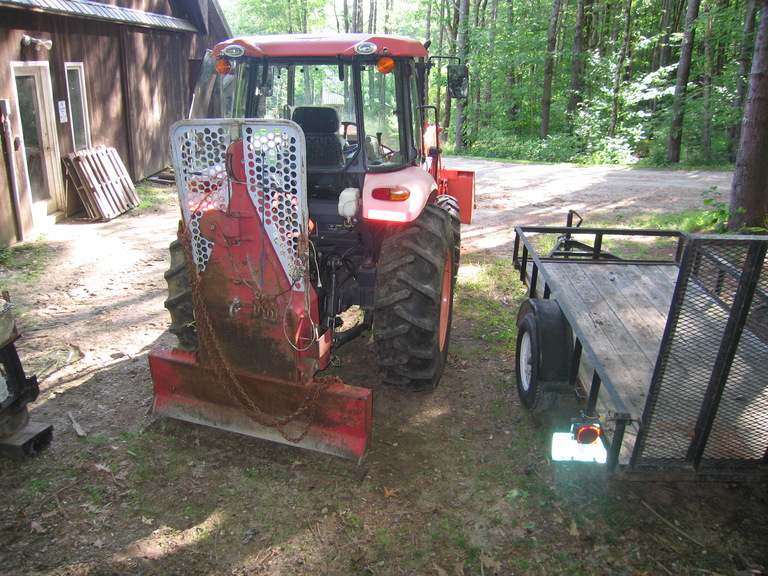

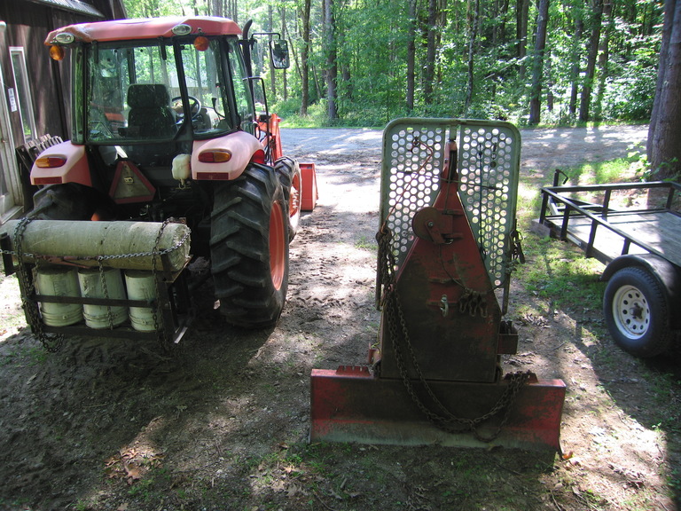

I have been carrying concrete ballast all the time as I pretty much do all loader work and at 500#+- it balances most FEL loads.
I have since mounted a winch on the 3ph and weight is comparable but more of that weight is up high.
While it may balance the FEL load, it seems like it takes less to lose rear traction than with the concrete
