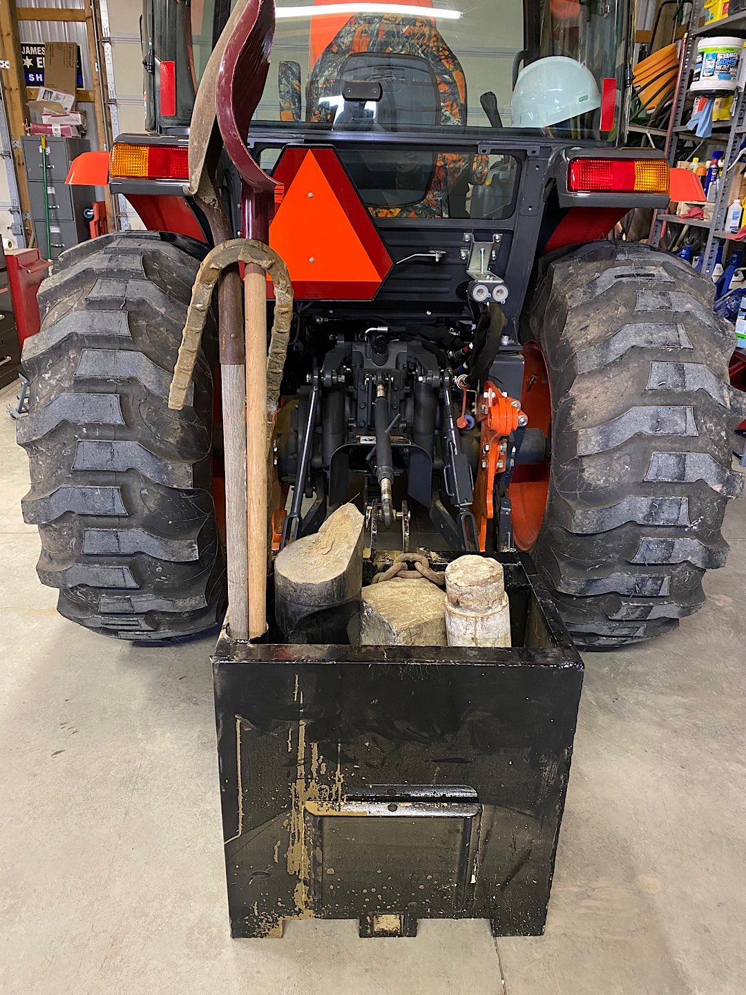

Check Amazon. I bought a Titan box last year for around $300. It’s what it is for quality. The top link pin ears were welded skewed but I can hookup ok. It definitely takes the weight as I filled up with steel.
I’ve added QH and hydraulic top link since this pic - and grooved my R4’s.

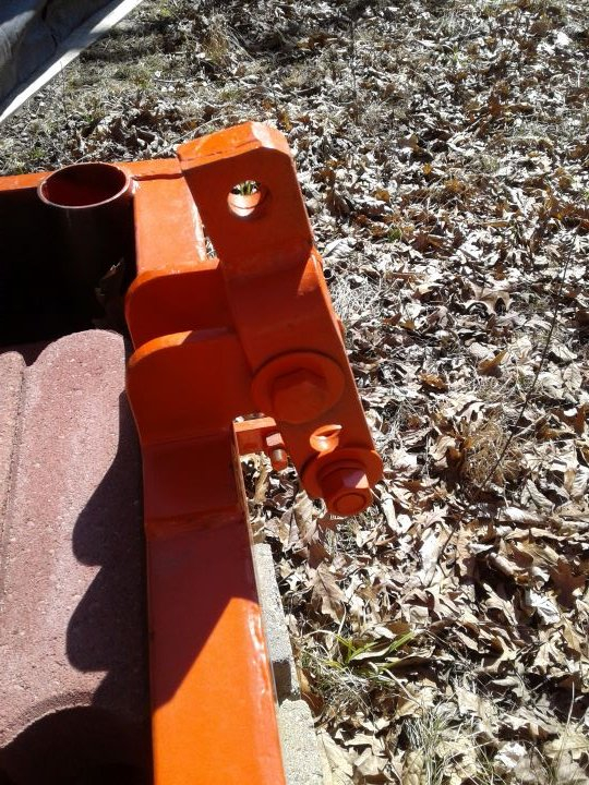

My Titan box was not QH compatible. The top link needed to be lowered and moved forward. I drilled holes in a QH adapter bracket (for brush mower) and used it to relocate top link pin

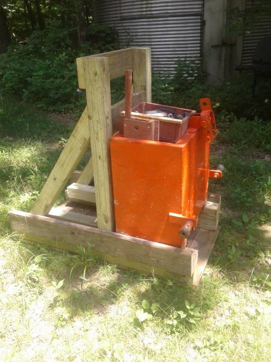

A parking stand prevents knocking it over when reconnecting
