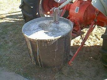

Since I don't weld, I'll probably have to rely on storebought, unfortunately.
Ya don't hfta weld.
if you can mix 'crete and have a few hand tools.. you can make as big as ya want.
here's one that cost me uh.. maybee 15$.
The tub was a cattle feed tub... leftover... there is an old drawbar bolted under it, and then some metal flats sticking out the top that are drilled to take the toplink pin.
Pretty much all i paid for was the concrete.. and some long carriage bolts to bolt the drawbar to the bucket and leave some thread stuck up in the crete for it to grab on to.

Looks like a good weight bucket. Pretty in-expensive also (compared to steel).

Yup, that's what I did too.
Bought a cheap rubber trash can from Menards.
Bought a cat 1 drawbar
Bought two pieces of flat stock steel
drilled a hole throught the sides of the trash can just big enough to slide the bar through. Slide bar in.
Mixed up enough concrete to fill it. Bend the flat stock end to a 45* so it won't slide out if loosened. Put the metal bars in the concrete before it dried.
Drilled a hole through the top of the metal to slide a hitch pin in to hold top link.
I probably have about 500+/- lbs and it works pretty good. Total cost was probably ~$50
   / BALLAST BOX #14
Yep.. Mine was cheap too. I had carriage bols up in the bucket with the threaded studs sticking a couple inches down to bolt the drawbar to. If I want to ditcht he thing, I just run 2 nuts off and get my drawbar back.
Ditto on bending the metal for the toplink connection.. I bent mine l shaped at the bottom.
I like that design.. cheap.. but works.. if it breaks or gets beat up.. no big deal.. has a flat top to pile a chain or strap on. Only thing I would do different if I build another is to put a sleave tube in it that would accept a trailer toungue.. etc..
