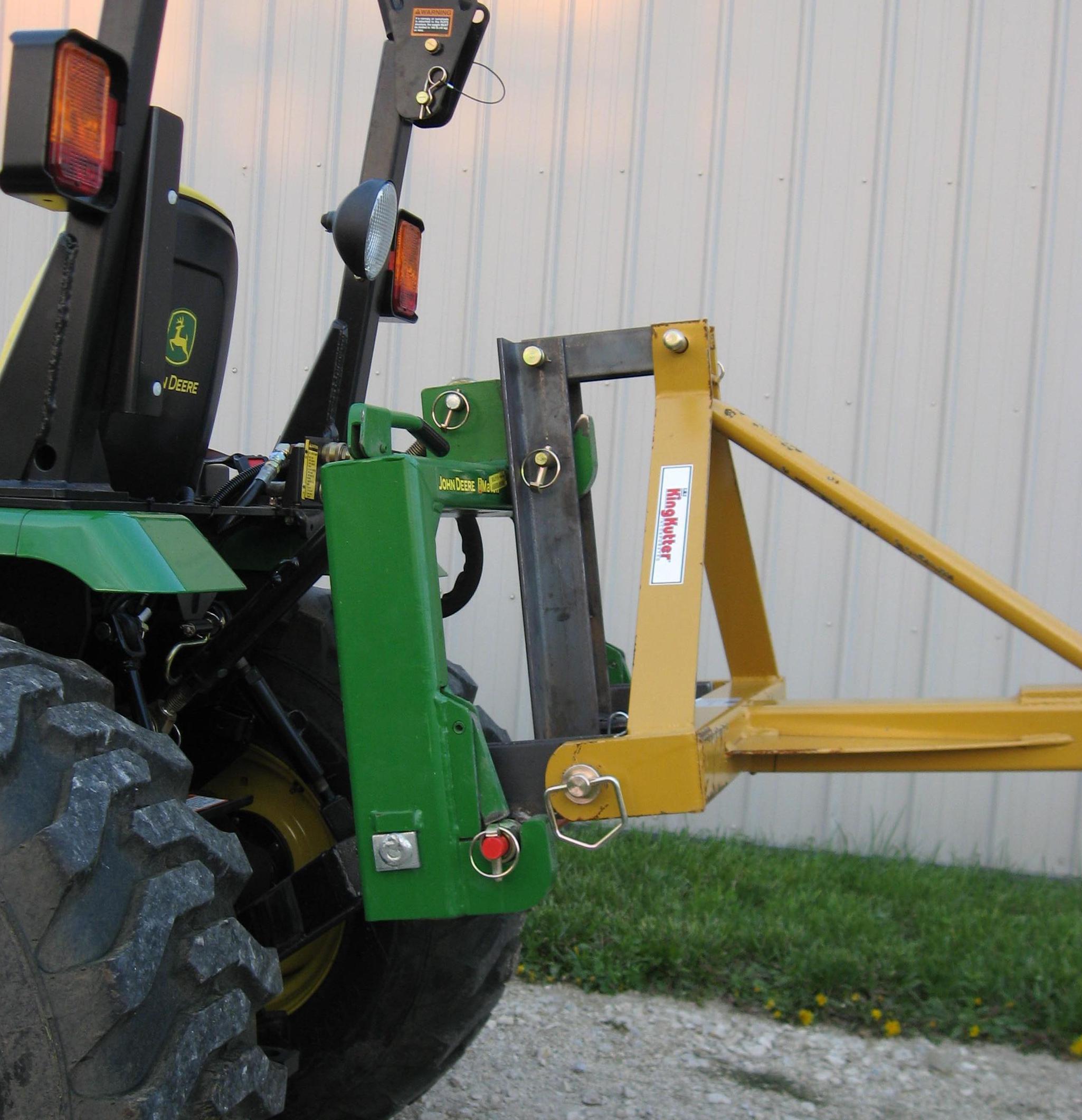

I have an iMatch and love it. Since I bought most of my stuff when I bought the tractor, I just made sure to get attachments that were compatible (Frontier). As for the two things I have that are not compatible (KK rake and carryall) I made an interface adapter that goes between the attachment and the iMatch.

I made an adapter for my KK Carry all- so that I can use my I Match. From what I have learned - by error and not by research here- is that the top hook on the I Match is 15" from the center on the lower pins ( this is ASAE standard)
It appears that some manufactures including KK do not always comform with this standard. I have heard this standard was self imposed by JD -I cant confirm this- interesting never the less.
